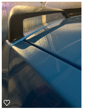

The rear trunk lid and the rear facia are 1/4 inch off. This looks shoddy. After careful examination it appears that they will not be able to align these panels without shrinking one of them.
At first, I thought the rear facia was just set too high but when you look behind the rear wheel the two line up perfectly
. Yikes!

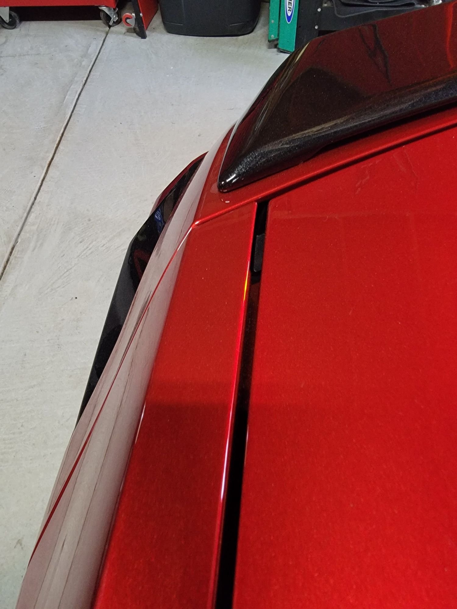

. Yikes!
I just went out to the garage and checked mine. It looks a little "off" in this photo, but in person, the panels line up correctly:
. Yikes!
Spoiler may be lifting the rear fascia "up". Hard to see close up but it sure looks like the spoiler is pulling it up to conform to it's location. How does the other side look? And in the middle of the fascia?

The other side is perfect. I can also see that the trunk lid is out of tolerance on both sides adjacent to the HTC hood. The rear facia is very flexible and was probably installed without being adjusted before fastening. I am going to point this out to the tech when they install the high wing I ordered.
Correct me if I am wrong but wouldn't the only way possible to lift the facia by way of the wing be going 100mph in reverse?

My line of thought was, lets say when the spoiler is being installed that the mid mounting section is "balanced" at the mid-fascia but has gaps at the ends of the spoiler to the fascia. When the mounting hardware is installed then the ends would tend to pull the fascia up just as you see. I can imagine that if you tightened the hardware at the middle and drivers end first then the passenger side could be even more pronounced - that's why I asked if there were pictures of the two other mounting locations.
An easy way to test the theory is to loosen the spoiler mounting hardware and see if the fascia tends to move back into the intended normal position.
I was under the impression that the spoiler hardware is only accessible when the rear facia has been removed from the car. I am hoping that when the high wing is installed, they can correct it.
