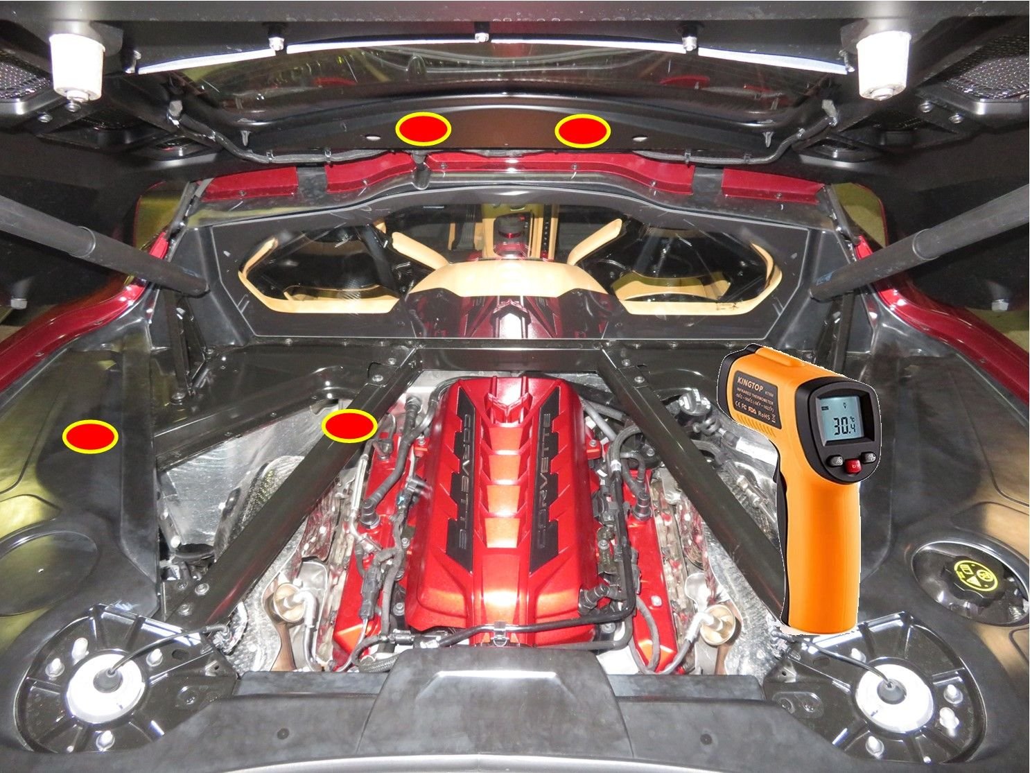

FWIW, that is why I make PDF's. I sent PM's to others who used LED lights who said dual side tape works fine. I also did my own tests, described in the PDF, using my IR remote temp gun. This is what I found, quoting my PDF:
"At 1/2 hour after driving the C8 with the engine water temp at 185 F and engine oil 175 F. Temps in the areas shown with red circles were all between 100 to 105 F. Particularly where the lights would go it was 100 F. Might heat soak somewhat hotter although after 2 hours checked and all temps were 90 to 95 F. All adhesives said they could handle 200 F continuous and up to ~300 F for short term exposure. Validates the poster comments (from PMs I sent) of “no problem.”
Pic of my temp measurement locations. BTW my PDF also discusses why I picked a brighter light, which was a PM to a forum member who made a similar install with another battery powered LED light said they wished they were brighter. I picked one with shorter battery life BUT brighter! Yep can't put all that in a post, which is a reason I have ~50 "How To/or Info PDFs!

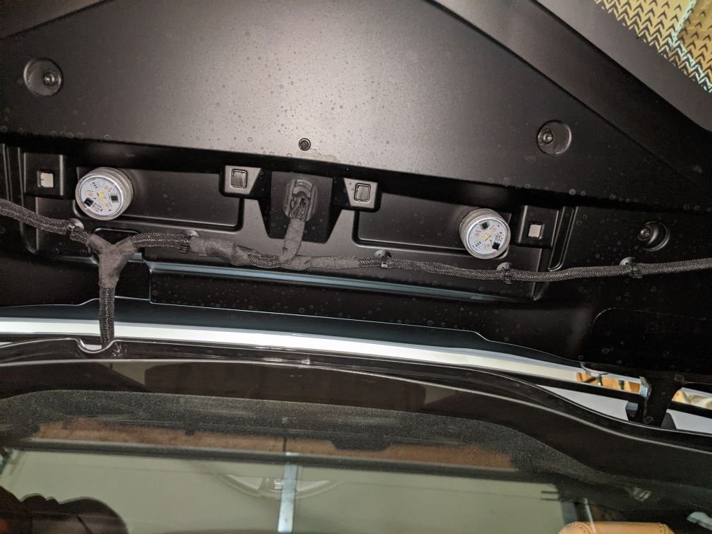

Arrived from Amazon this afternoon and installed.

I misinterpreted (did ay attention to detail enough) the first light below vs above the window. Good news is that I got to test the Gorilla 38# double sided tape. The light did not want to come off! It took lots of twisting and pulling before I was able to remove it from the lid.

I know there's a dozen or more threads on this but I thought I'd chime in with my slight variation.
I used these smaller submersible lights:
Amazon 1.4x0.8 inch lights Amazon 1.4x0.8 inch lights
The nice thing being they fit easily in the recesses for the oem factory lights. Two of them provide PLENTY of light, but as you can see from pics below, if I wanted to I could probably fit 6 total in the recess space, 4 definitely. But IMO that would be way overkill. In fact I actually dim the two that are in there (they have all the usual functions: multicolor, fades, strobe, hard and soft white, cold/warm, etc etc)
Also, since they're only .8 inches deep, you don't see them from behind. I mean if you lay your cheek down on the trunk you can just barely make them out, but if you hit the sides with some black krylon you won't even be able to do that. (I'll be spraying mine now that I've confirmed fitment and usage - which will be easy since they just screw into place.
Used the 3M VHB 4611 Tape and from previous usage in other engine bays I am sure those lights are going nowhere. Showing a pic to show how I had to sandwich two layers of it to fill in the recessed back of the light to make sure the surface was all tape.
