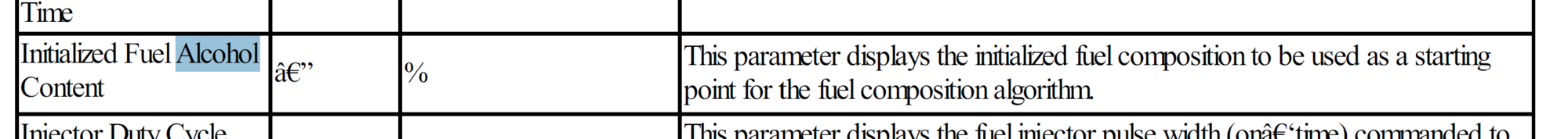

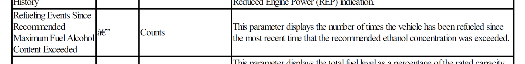

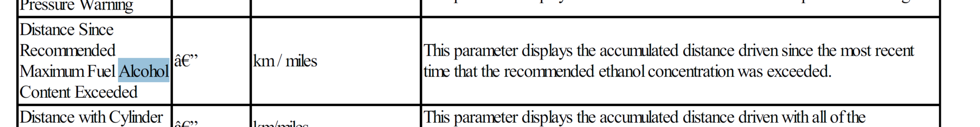

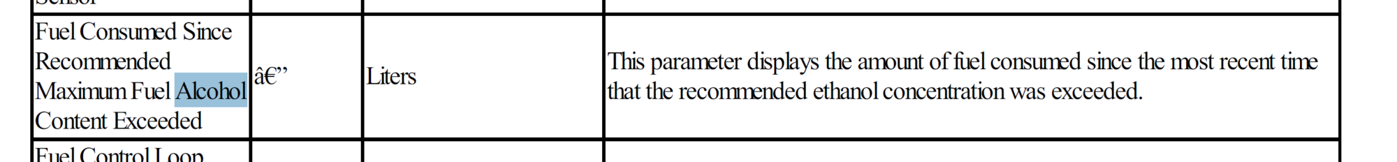

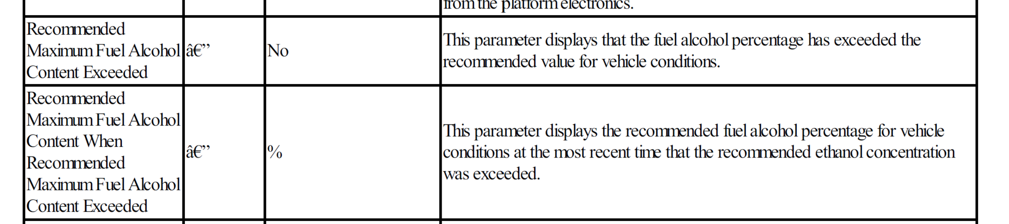

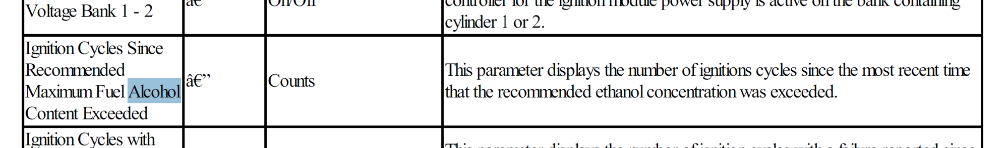

Default How can they tell alcohol content?
Or. maybe they will use a scan tool and look at the following parameters which are listed. I was not looking for this, but I ran across it in the list of Scan Tool Parameters for the ECM while I researching another topic. When I saw it, it reminded me of this thread, where the question came up about how GM would know if one put fuel in with too much alcohol content. I have no idea how these are measured, nor if these particular parameters are even active, but they are found in the ECM Scan Tool Parameter List in the 2020 version of the Service Manual that I have.
1. Recommended Alcohol Content Exceeded.
2.Recommended Maximum Fuel Alcohol Content When Recommended Maximum Fuel Alcohol Content Exceeded.
3. Refueling Events Since Recommended Maximum Fuel Alcohol Content Exceeded.
Edit: I found a few more. Two of them, Fuel Alcohol Content Learn in Progress and Fuel Alcohol Content Too High appear under the list of reasons that will show up in the Scan Tool for "Cylinder Deactivation Disable History". These are just a list of Scan Tool Parameters related alcohol in the fuel, that someone could look at if they had a reason to do so. I did not look for the DTC and related diagnostic procedures that would prompt someone to look at these parameters.

I added a few more alcohol in the fuel related Scan Tool Parameters that I found to post 45. Two of them, Fuel Alcohol Content Learn in Progress and Fuel Alcohol Content Too High appear under the list of reasons that will show up in the Scan Tool for "Cylinder Deactivation Disable History". These are just a list of Scan Tool Parameters related alcohol in the fuel, that someone could look at if they had a reason to do so. I did not look for the DTC and related diagnostic procedures that would prompt someone to look at these parameters.
