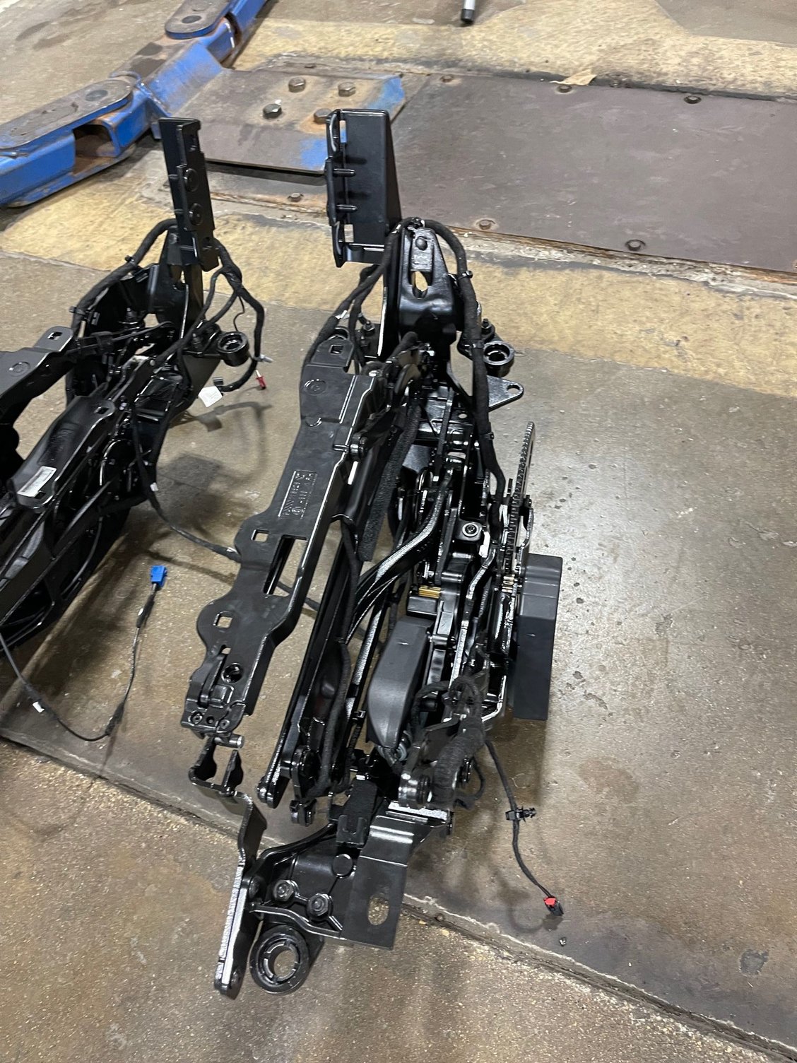

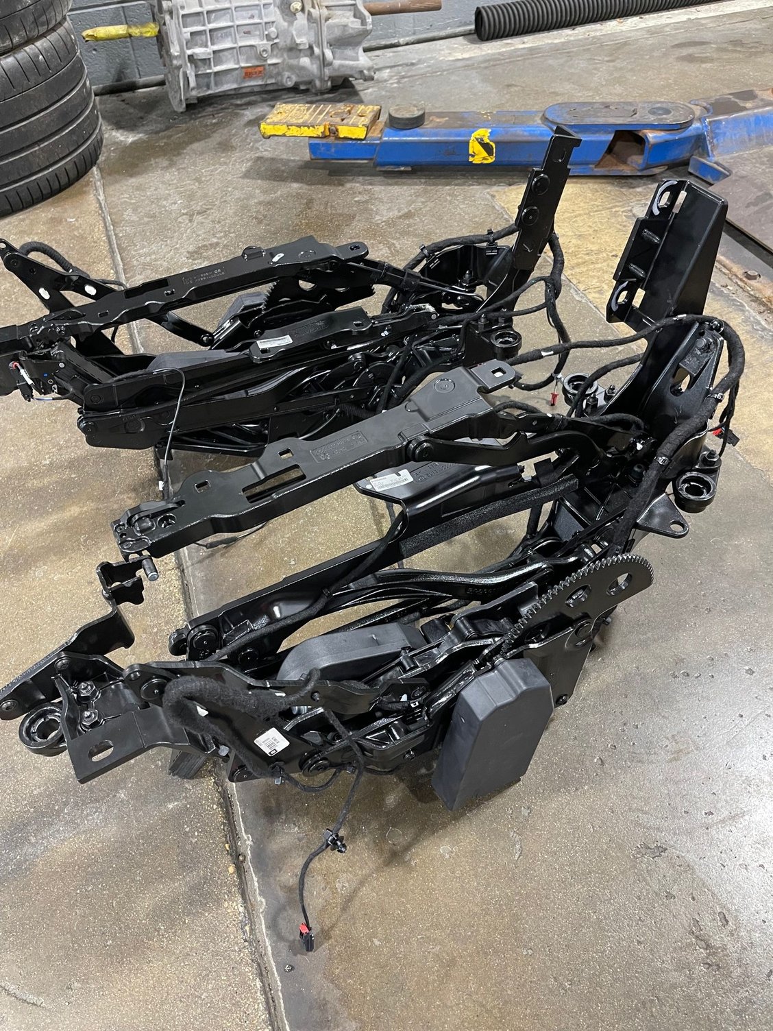

I think this just happened to me... I backed out of the garage and started to lower the top and heard something snap quite loud. The top lowered just fine. When I went to put the back up I never got the Top is secure message. I got out of the car and the whole rear deck was wedged up about 3" or 4" above the rear quarter panel with the retractable claw stuck between the top and the rear quarter panel. I was too freaked out and didn't get a picture.
I immediately began to lower the top back down and stopped half way and one claw was up and the other was just hanging there. The tiny thin cable pulled through the little whole in the plastic block I was able to lower the top back down and nothing looked scratched and the body panels all seemed to line up... So it's basically stuck in the down position. I was going to try to bring the top up and operate the one nacelle claw/flap by hand but figured EFF that... It didn't look like a huge problem but now I'm a bit concerned about parts availability...
Originally Posted by kbconnection
There are two "claws" on each side, as it opens and shuts, it extends and recedes. I drive mine daily. Well at 15,000 miles one receded, one did not, a cable popped and broke in the HTC mechanism. The entire HTC mechanics had to be replaced to fix this problem. There are no parts you can order. My mechanic had to teach GM how to do the repair for 2 others that were having the same issue. There is also a faulty sensor chip that let's your car know the top is completed when down and completed when up. This chip was altered by my mechanic and works great now. Unfortunately, you cannot order just the sensor chip, only the entire top replacement parts. If and when you have these issues, contact me.

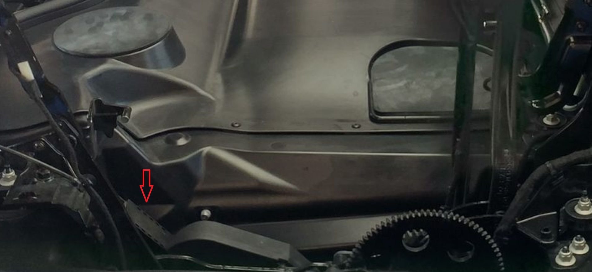

Originally Posted by RKCRLR
The way the Chevrolet Protection Plan is worded, I suspect an issue like this wouldn't be covered. It will be interesting to see what happens when items like this occur out of warranty. I wonder if there is a preemptive inspection that can be performed.
It's a flimsy looking setup... This little plastic box is the junction for the upper and lower cables and there's a spring inside. The lower cable pulled right through the bottom of the plastic box.
