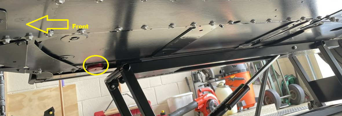

Many uses for a QuickJack: rotating wheels, detailing, installing grill guards, oil changes, or just perching the car like a trophy in the garage. If i plan to roll under the car, I use jack stands for an increased safety factor.
Jack stands for added safety.
@1050High Yes you can as I and others have done many times as shown above. Align with the rear lift points and then modify the QJ lift blocks to fit into the "tray" about two inches shy of the front lift points. Phil1098 pioneered the way and I agree with him 100%. Search the posts above for great photos and directions. Besides, the extensions are costly, more cumbersome to store and setup, and are too high to slide under the car at-grade.
If I didn't own these already, I'd have purchased the next longer size. But these do work.

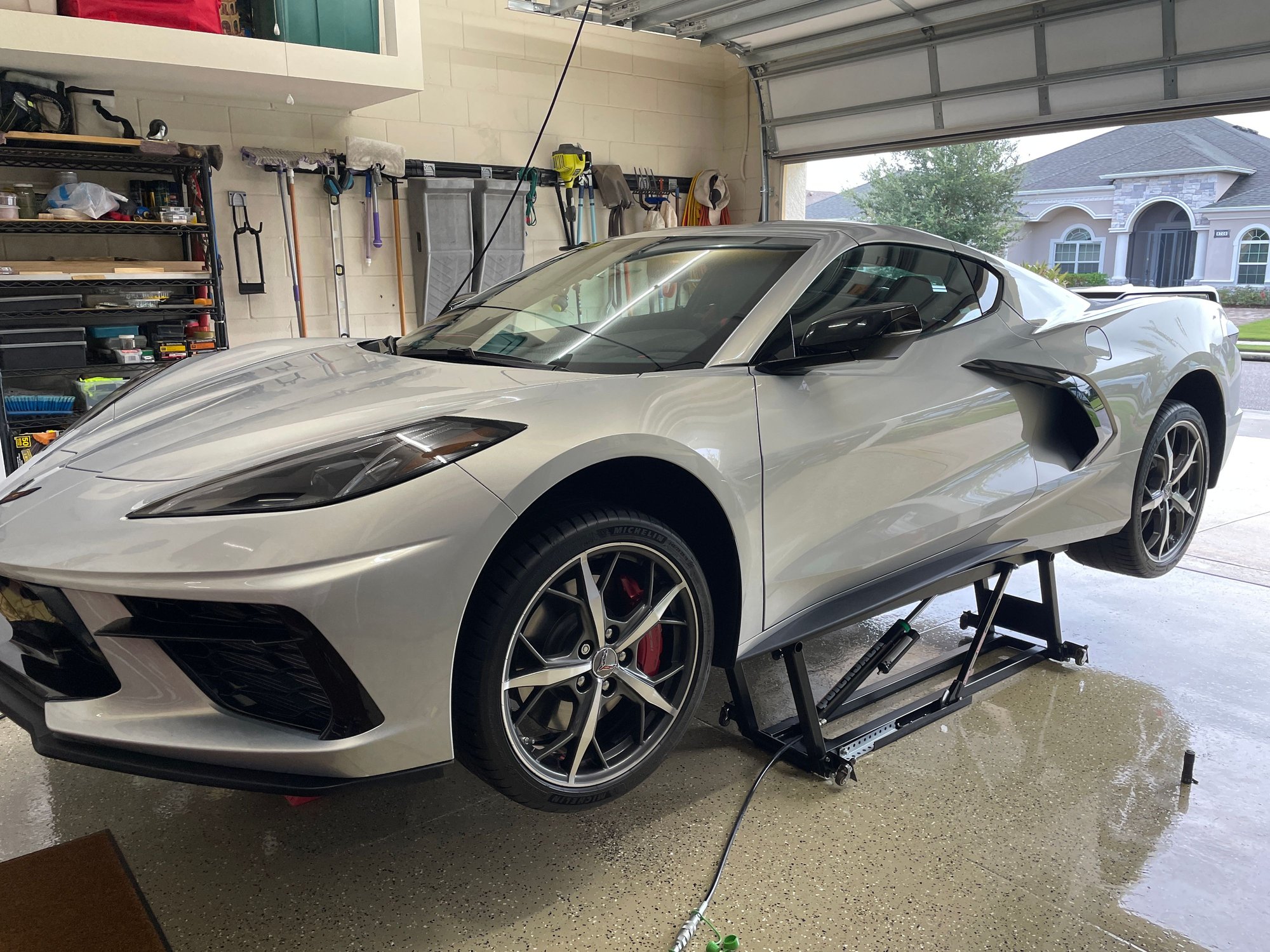

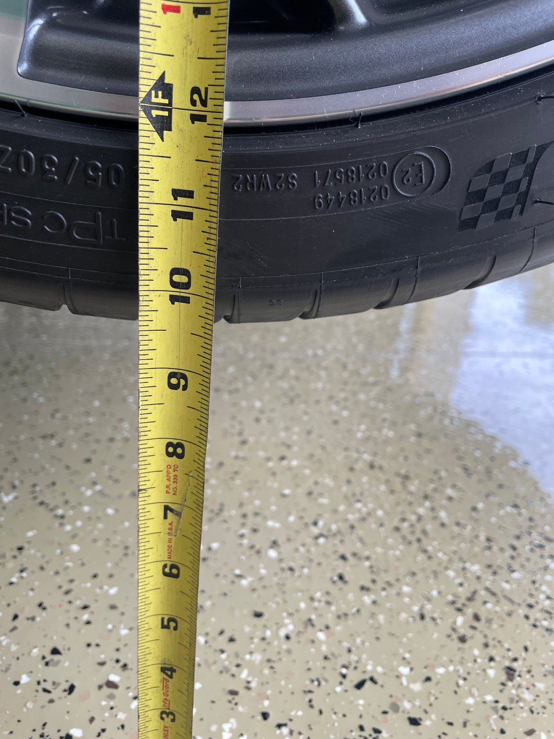

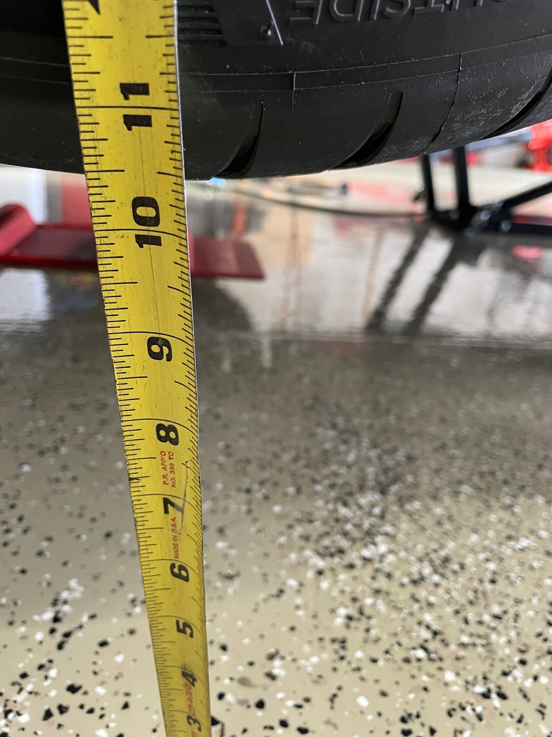

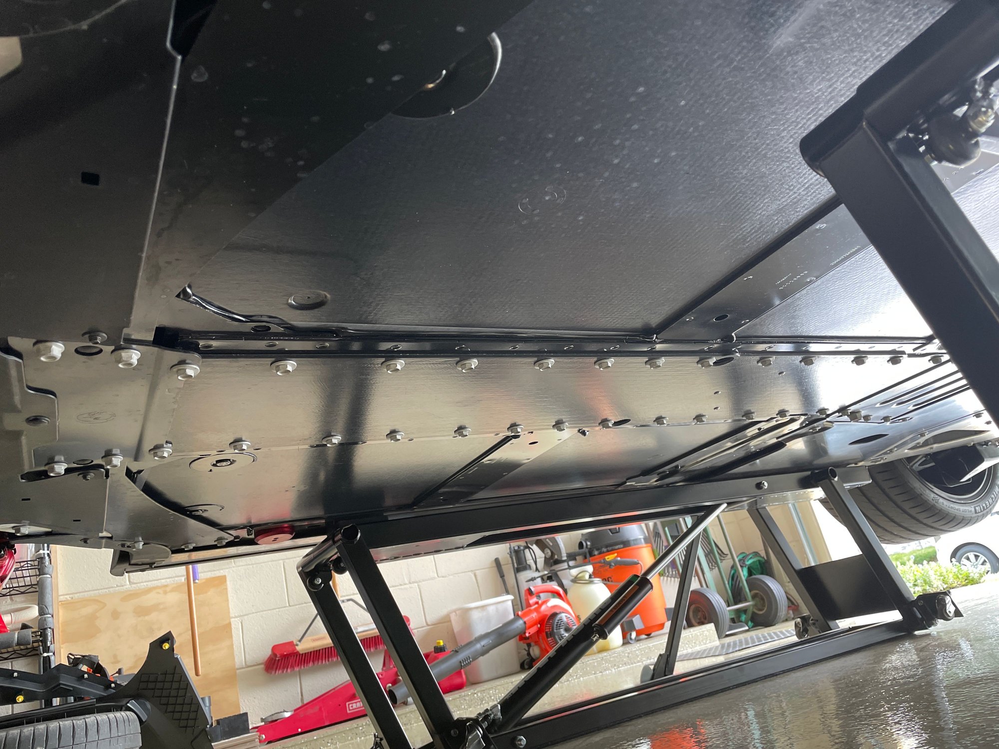

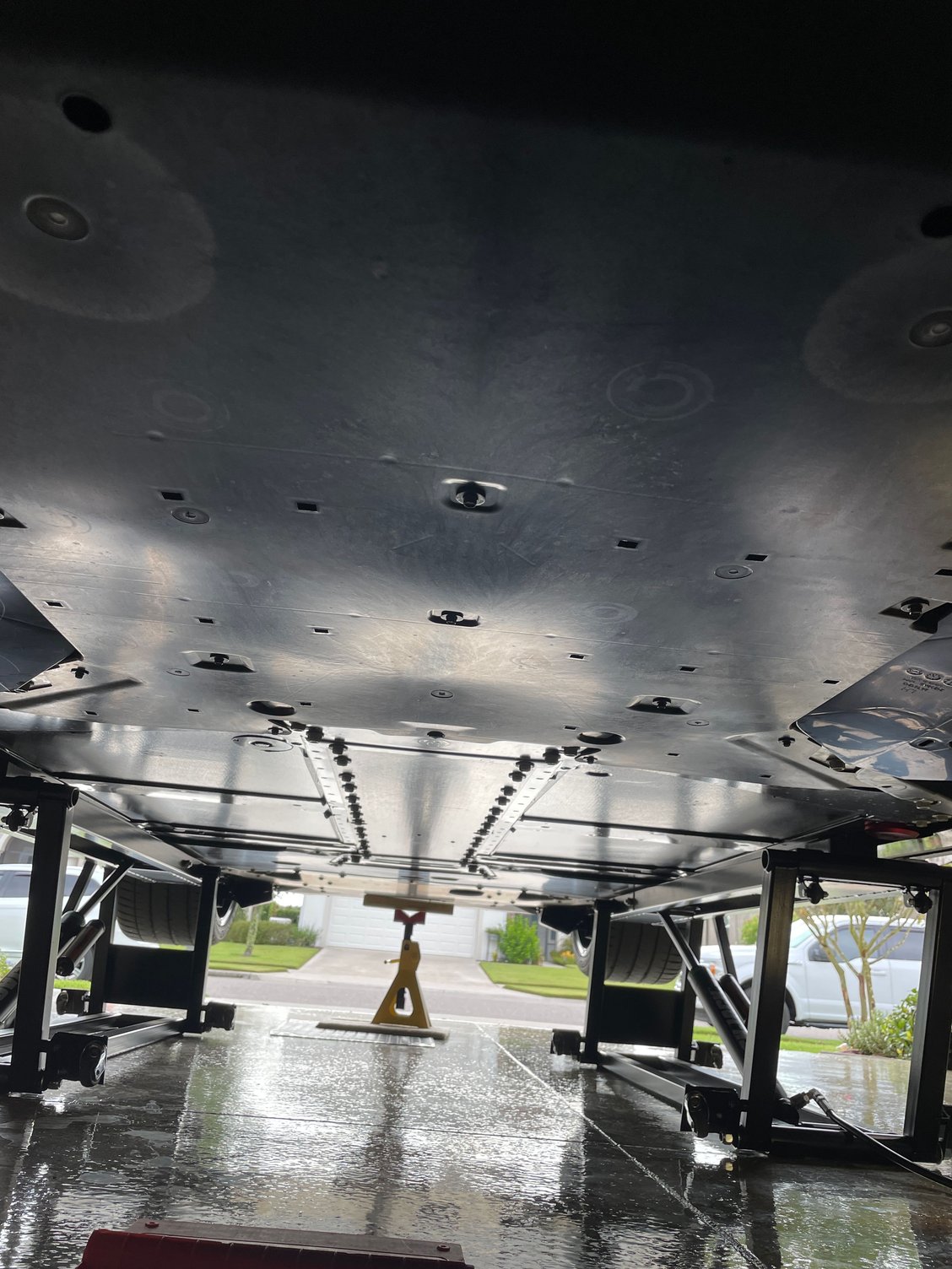

I have the 7000 slx. Purchased it last year to use on multiple vehicles. I thought I would need the extensions to lift my truck, crew cab, long bed. Not so! The lifting points on the truck are actually closer together than the C8 or my wife's SUV. I should have done some closer measuring and could have saved some money..
You may ask "why did you not use the extensions on the C8"? They do not fit! The extensions are 1 1/2 inches thick, raising the height of the quickjack. There is just not enough room to place it under the vehicle and use the rubber blocks to lift the C8. You would need to drive it onto some 2 x 10, or something that thick, to get it high enough. Don't need to do that.
I agree with NextOne and Phil1098. I've had the C8 lifted several times, using their method, and it is rock solid. I've had the front wheels off with the back wheels on, doesn't move. Had the back wheels off with the fronts on, doesn't move.
Pics attached:
1 - C8 on the lift
2 - height of front tires
3 - height of rear tires
4 - shows the position of the rear pad on the lifting puck
5 - shows the position of the front pad about 4 to 5 inches to the rear of the front lifting puck
6 - the jack stand I use, just in case. It's under the rear crossmember
Old Nov 22, 2021 | 10:42 AM
1050High's Avatar
1050High

Thanks for the great pics and detailed information about safe & sound C8 lifting with SLX length QJs. Follow up question - were you able to identify rear cross member
jackstand point without removing sheet metal panel and can you recommend any jack stand position(s) on the front end of the car for added safety?

Yes, you can see the crossmember without removing any panels. I use a folded towel and 2x4 on top of the jack stand. It fit snug and would prevent any movement, if that were to happen.
I did not place any under the front, however there are a couple of options. You could possibly use the lifting points. Look at the second picture posted by NextOne. Those are in that location. Also, look at my picture number 5. The four bolts to the left are in a strong point area. You could place a jack stand there with a 2x4 or 2x6 and that would support any movement.
