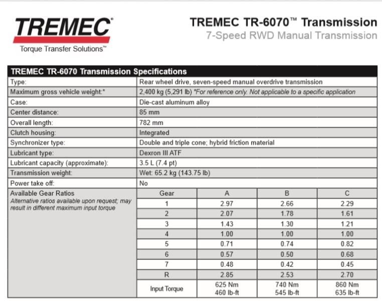

Torque multiplication is dependent on the gear ratio. May be multiple parts of the trans that can be an issue but 1st gear being the most toque multiplication will govern the max loads on all parts, case distortion etc.
One reason straight cut gears are used in racing transmission (where the excess noise they generate is a none issue) is unlike helical cut gears that load the ends of the case, straight cut gears create no loads on the gear shaft direction! In fact, helical gears have more of the tooth in contact for the same size gear.
1st gear in a LT1 Z51 will provide 460 ft-lbs X 2.97 = 1366 ft-lbs of torque output.
1st gear in the LT4 Z06 will provide 650 ft-lbs X 2.29 = 1488 ft-lbs, similar output
Of interest, Tremic says the max torque for the Z06 gearing is limited to 635 ft-lbs which is 1454 ft-lbs - closer.
Both are less friction losses
