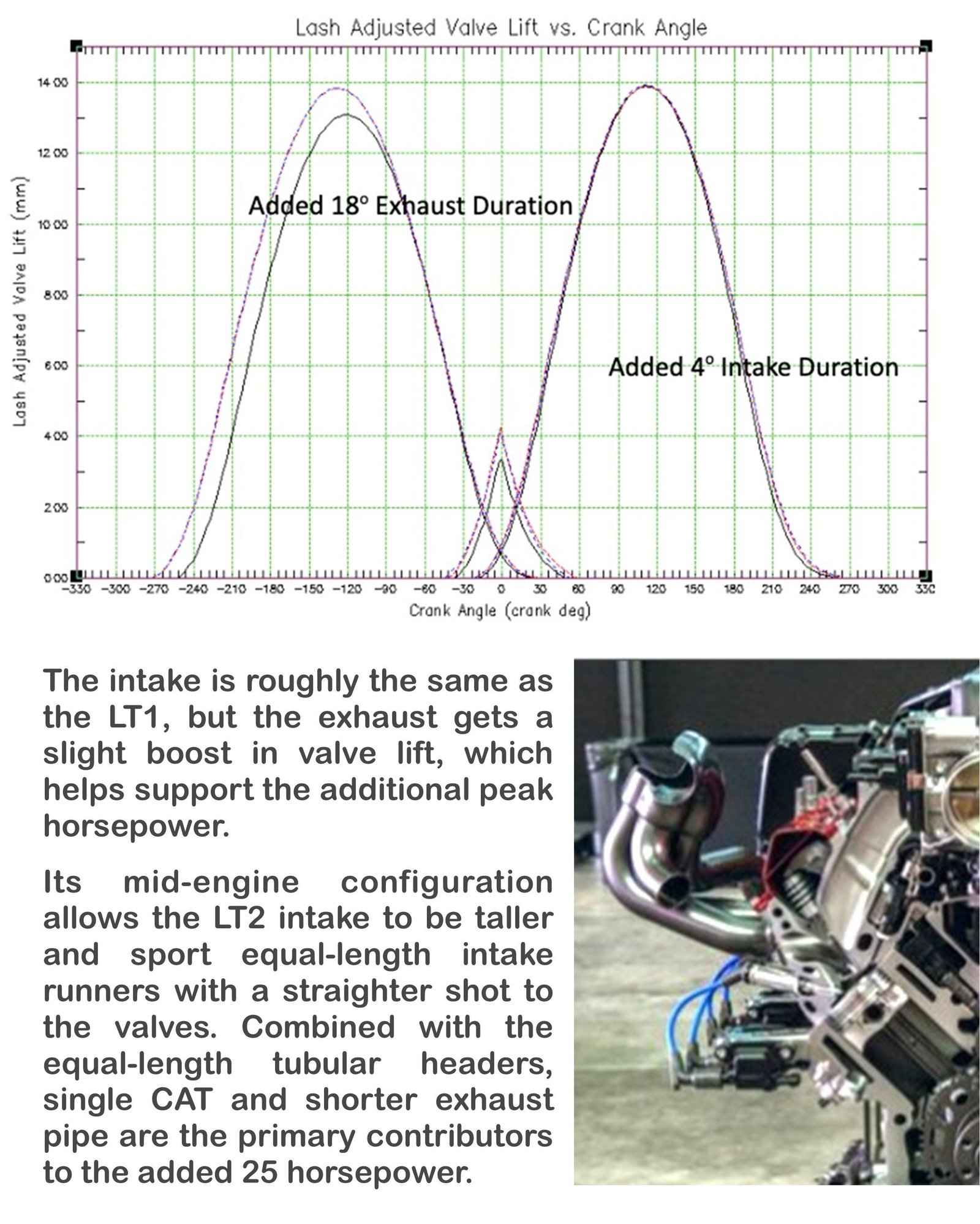

Did anyone notice that this profile, even though it isn’t a copy, follows the timing philosophy of the Katech torquer cams? With the shorty headers it looks like they are going for all the exhaust breathing they can get away with. Exhaust timing increases aren’t as dramatic as intake timing but they are much less intrusive to corporate drivability, emission and mileage requirements. This profile looks tailor made for long tube headers.

I’m surprised they added any with the climate change that’s causing the imminent end of the world soon, seriously though with the 18* extra on the exhaust side I don’t understand why they didn’t let it rev to 7k as that bigger split helps carry the power past peak and the shift/rev limiter is right after peak currently?
After seeing some dyno sheets it looks like the LS2 is running out of torque above 6000 rpm. You won’t get any more horsepower at 7000 without more or at least the same amount of torque. Of course your car will be a tiny bit faster by staying in a lower gear a little longer but not much. You can raise the torque curve with a noticeable increase in valve timing at the expense of an equivalent amount of low end torque and drivability. Small and acceptable increases can be had with small increases in intake timing. Just as effective for small changes is intake runner length which, I have seen, can be very effective. Would I like more cam and long tube headers? Sure. But GM has to build a car for the consumer world even if it is a hot rod. I think those guys are pretty smart.

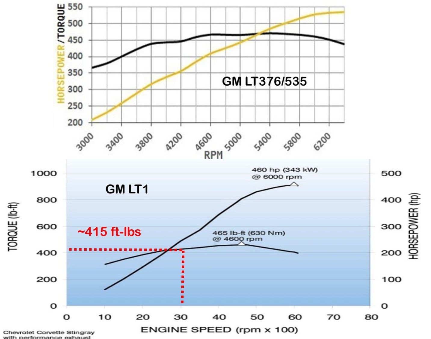

Always have to be careful what you ask for! Recall the LT1 Crate Motor gets 535 hp @6300 rpm versus the in the C7 465@6000. However the torque is only 5 ft-lbs more just pushed to a higher rpm. That's with a low restriction exhaust, no CATs, different cam without variable cam timing (as GM pushed that as far as they can without valves hitting pistons.) It also does not have to meet EPA emissions as it's designed for street rods, off road etc. See Pic.
Yep can always get more high rpm power by sacrificing low end torque. In fact, the LT2 does that to some degree versus the LT1 when you look at the power curves!
Note: Gragh with 535 Crate Motor starts at 3000 rpm and is ~40 ft-lbs less at 3000 than the C7 engine. No doubt even a higher percentage lower below 3000 as it does not have variable cam timing!
