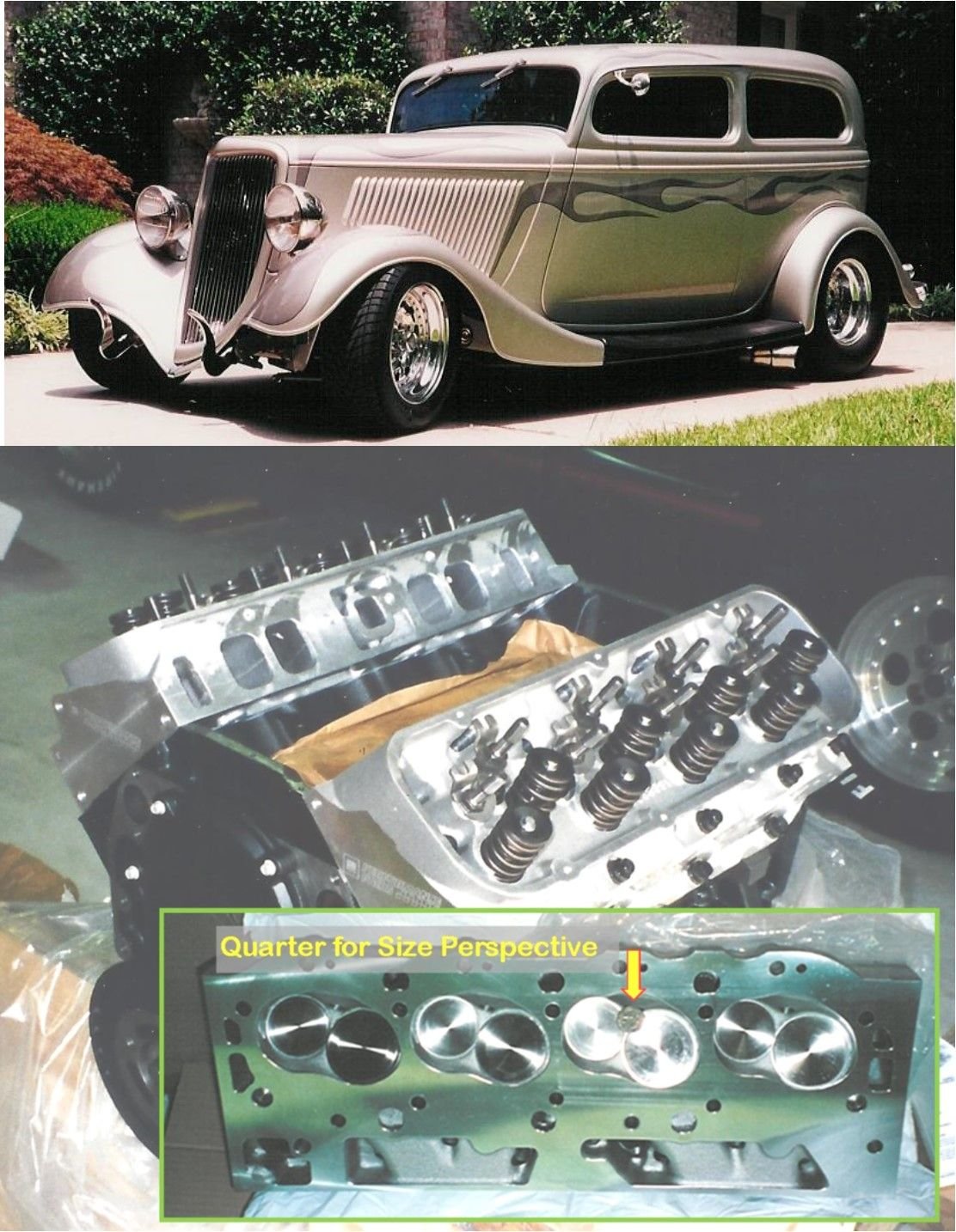

Now I'll still enjoy my ProStreet Rod with it's 502 cid BB I assembled from some 30 boxes with it's tubbed 16.5 section width rear tires! It gets about 10 mpg! Can always build your own, as I did, or as you say drive an old Vette.

Love the pro street rod, that is really nice

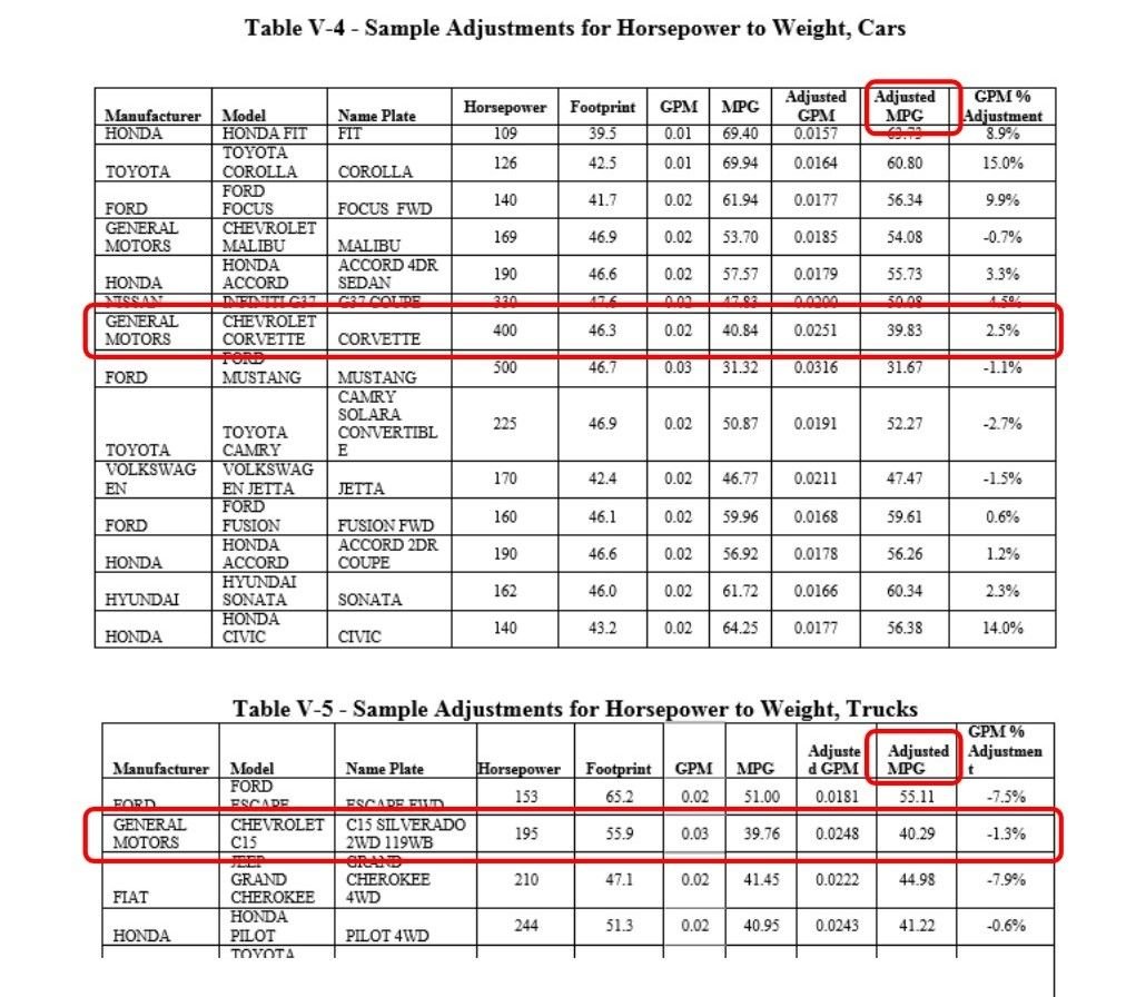

As far as "You paying a Gas Guzzler Tax," don't think some understand the improved mpg issue! If you want to see what is coming, read the 1174 page government publication I show in post #6 in this thread. (Pic of parts of 2 pages below showing the mpg requirement for the Corvette and Silverado . Don't need to read it all unless you like statistics and math as it lists every car and light truck model and shows calculations for the mpg goals for each.) It's been on hold for ~2 1/2 years and when a version is implemented, which won't be the same ~40 mpg reequipment for the "Corvette Family," BUT even if it's ~30 mpg it will require as a minimum of a hybrid. We'll know in December 2020 just how onerous it will be (if not sooner as expect the current administration will reach some agreement with California as auto manufacturers can't base future car plans on who wins elections!)
In any case, it's NOT the buyer paying a "gas guzzler tax" (although that will still exist) it's the car manufacturer paying a very high fine based on how much the defined "vehicle family" has missed the goal. In GM's case doubt they have as much concern about the Corvette as they do the 550,000 Silverado's they sell each year. That class of "light trucks," spelled out as Silverado in the report, also required ~40 mpg in 2025. Even if it's like the agreement CA reached with Ford/Toyota/VW/BMW in July of 2019, which would be about ~30/35 mpg in 2026, that requires a hybrid or EV.
The goals are based on forcing reduced emissions NOT just allowing "rich folks" just to pay a gas guzzler tax to drive whatever they want! It's big fines to the manufacturer if the defined vehicle family doesn't meet the goal. Oh there will be a fine for the well healed Hollywood types buying low mpg cars BUT most will no doubt buy a high end Tesla for the public appearence as they fly around in their jet plans! That is no doubt why Ferrari's CEO has announced they expect 60% of their cars to be hybrids in 2022!

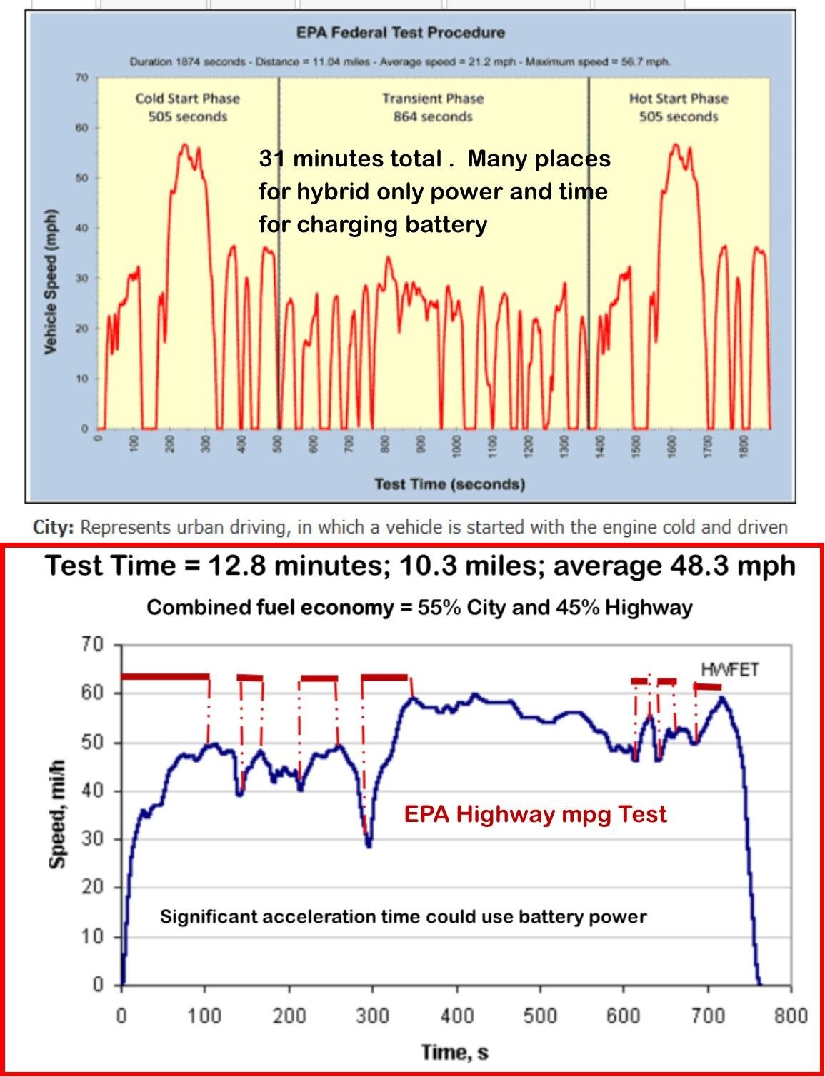

See my post number 6! There are two ways to promote a FWD hybrid. First, "What all enthusiasts want to hear- better performance!" The other "Based on mpg." However manufacturers of sports cars will only used the mpg benefits when needed for a government dictated, say ~30/35 mpg for the "Corvette family" beit Federal, California, France (where it will be CO2/km driven.) Most customers won't like it BUT when the car stops or is driving slowly you shut off the LT2, AND only start it again when the car is at 30 to 40 mph (in normal driving.) If you look at the EPA city drive cycle in post #6 there are many stops and deceleration periods when the battery can be recharged when braking or coasting!
The car manufacturers will only talk about mpg when they can blame whatever government! Can't blame them! As I show in my PDF, the older Prius for years only had a battery capacity twice what is shown for the C8 hybrid. If one was careful you could get over 50 mpg in town! The heavier nickel-metal hydride battery in the third generation Prius (2010 to 2015,) has a lower capacity of only 1.3 kWh (less than the 1.9 kWh in the leaked C8 hybrid,) weights 93 lbs and the car is rated at 51 mpg city/48 mpg highway. Just checked, the NSX has a battery less than 1 kWh capacity, half of that leaked for the C8 Hybrid!
Just like with an M7 C7, if you look in the Owner's Manual for suggested shift points for best mpg it has shifting out of 1st at 17 mph which activates skip shift and you can only shift to 4th. Then it says shift from 4th to 5th @ 25 mph, 5th to 6th @ 40 mph and 6 to 7th @ 45 mph! That is to get the advertised EPA mpg! If driving casually an A8 computer controlled transmission defines shift speeds! In the EPA mpg test it will also control LT2 restart and will get the high numbers!
Suggest you download my PDF: http://netwelding.com/C8_FWD_Hybrid.pdf

Looks like the NSX is being promoted like the newest Ferrari SF90 Stradale hybrid- for performance. As I have said, Ferrari, GM etc will NOT promote the mpg feature or perhaps even put the software in to start the ICE until the electric motor brings the car to 30 to 40 mph when cruising normally. They will have a "government" rightfully take the responsibility for requiring that level of mpg or CO2 emissions/km in Europe!
Most folks buying performance sports cars don't want to hear better mpg or have to deal with even Stop/Start! When dictated by the Federal Government, California, France etc etc they will rightfully blame them! The Ferrari CEO did not announce that they expect to sell 60% hybrids in 2022 because they love them! Ferrari and others will be ready to sell performance cars in the US or even just California and the ~5 states that use the California emissions laws. GM won't be left out!
As far as achieving the needed EPA "average" mpg of say ~40 mpg consider what the early Prius achieved with a 4.3 kWh battery in 2013/2014. It achieved 51 City and 48 highway mpg. The EPA average mpg is based on 55% City and 45% Highway. So that average was ~59 mpg. It could also travel ~16 miles on electric power alone. Forgetting the need to travel on electric only, the 1.97 kWh with the right battery that can handle deep discharge should be sufficient on the EPA drive cycles! It's like racing, it only has to meet the rules NOT deliver in every driving condition.
Looking at the EPA City Drive Cycle below, a 1.97 kWh battery can recharge often. So a 114 hp electric motor/battery combo (with the right type battery) should be able to regenerate enough battery capacity with all the stops and coasting to have the electric motor do most of the City 31 minute EPA cycle. My undated PDF estimates the following as a possibility: http://netwelding.com/C8_FWD_Hybrid.pdf
- with 55% of the average mpg based on the City drive cycle of 45 mpg it appears possible with modest Highway mpg! For example, 55% X 45 mpg + 45% X 32 mpg = 39.1 mpg average!
Even on the EPA Highway cycle there are some places where the electric drive can help. One example is when required to accelerate moderately, the C7 will switch from V4 to V8 mode. Now the motor/battery could keep the ICE in 4 cylinder mode. Or even the GM 2 cylinder mode that have in some other V8s. I'm sure GM calculated what was needed to achieve the planned "government requirement." Depending on who wins December 4th we may see the C8 hybrid quickly!
