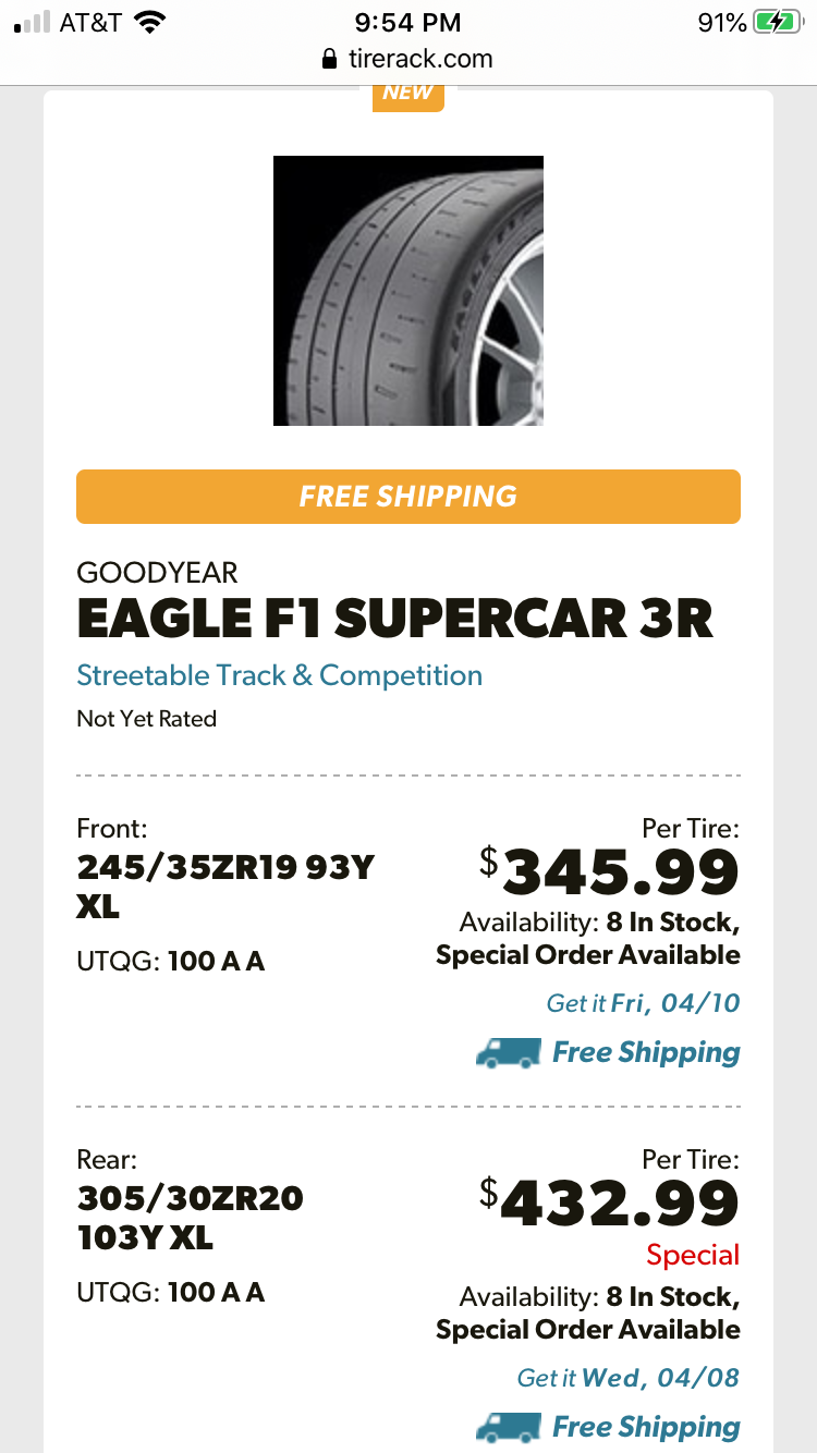

Originally Posted by GSpeed
were working hard to go the route that most who track the car will go. If you have a tire suggestion, we can run it up the flag pole and see what the consensus is. It would be nice if it fit stock wheels, but we understand (as many do) that we might need wheels. (Aside from the hoosier shod finspeeds- they are 18x10ish and 18x12ish, fwiw)
Not cheap and won’t last long, but these are in stock and OE sizes...

OE ZL1 1LE tire compound is a little cheaper than the ones off Mclaren
