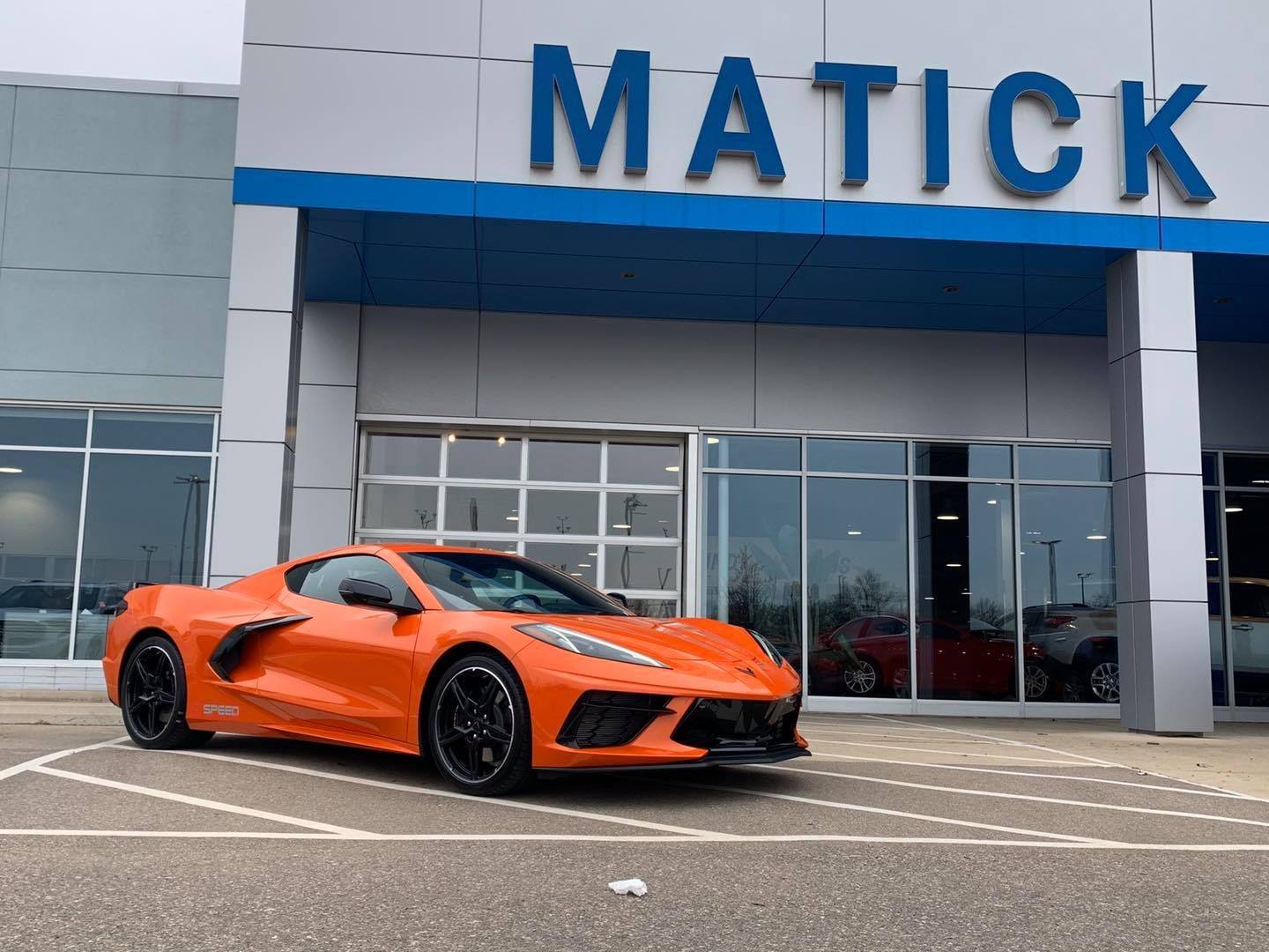

Introducing the newest addition to the GSpeed hanger.....our new Z51 C8 Corvette.
We picked up our new 2020 2LT Z51 Corvette this past Saturday and it is currently being trailered home to GSpeed were we can start getting pics, weights, dyno, and.....track times! This will be our leading C8 platform development car so stay tuned!!!!

Stunning color combo, cant wait for updates!
Are the windowswindows?

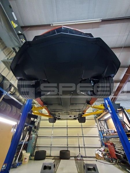

Mother Nature isn’t wanting to like us to much right now with light to heavy rain through Monday but we are getting some measurements on the car and prepping it for it’s baseline track runs here at our home track of MSR.
Up on the lift to get a good look at the bottom side of the car

How is the clearance looking for a rear 325 tire ?
no problems, we will have our hoosier situation sorted soon. Probably 315/335 or 315/345

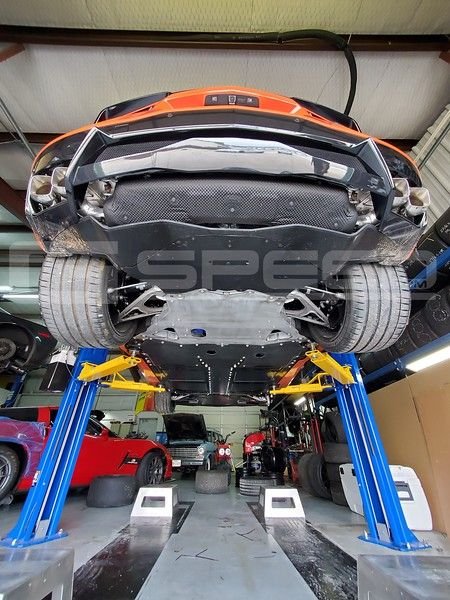

Rain continues.......
So let’s take it apart!
Might as well learn something right?
That massive rear fascia? Almost 40lbs
The NPP cat back? Not exactly light weight.
77.4lbs with the actuators in place.
As you have probably seen they have went to a external caliper for the parking brake, which is electronic like the drum in hat version of the C7.
Each one of these is over 6lbs hanging off the spindles on the back of the car.
It was while we were playing with the brakes that we also felt this was a good time to flush the OE stuff with a better, high temp fluid before we did our baseline runs just to eliminate a chance of brake fade due to fluid issues. We also ran into something we didn’t expect.
If you are doing the brakes at home with a buddy and are doing it how you always have, more than likely you are going to run it dry and have a very soft pedal. GM suggests using a pressure bleeder system to keep it from doing this. If you do not have the adapter and kit to do this at home, then take the bleed process VERY SLOWLY to make sure that no air can enter the system.
So it can be done at home....again just have to go real slow with it and keep mindful of the pedal as you go.
Found the ECU while we were poking our heads around the car too....
Nice shot of the engine and transaxle while we had everything apart.
Work continues as more storms are forecast for tomorrow. Possibly Friday afternoon we might see some dry time on a cold, green track. Not the best for times but possibly some feedback from the car and driver.
