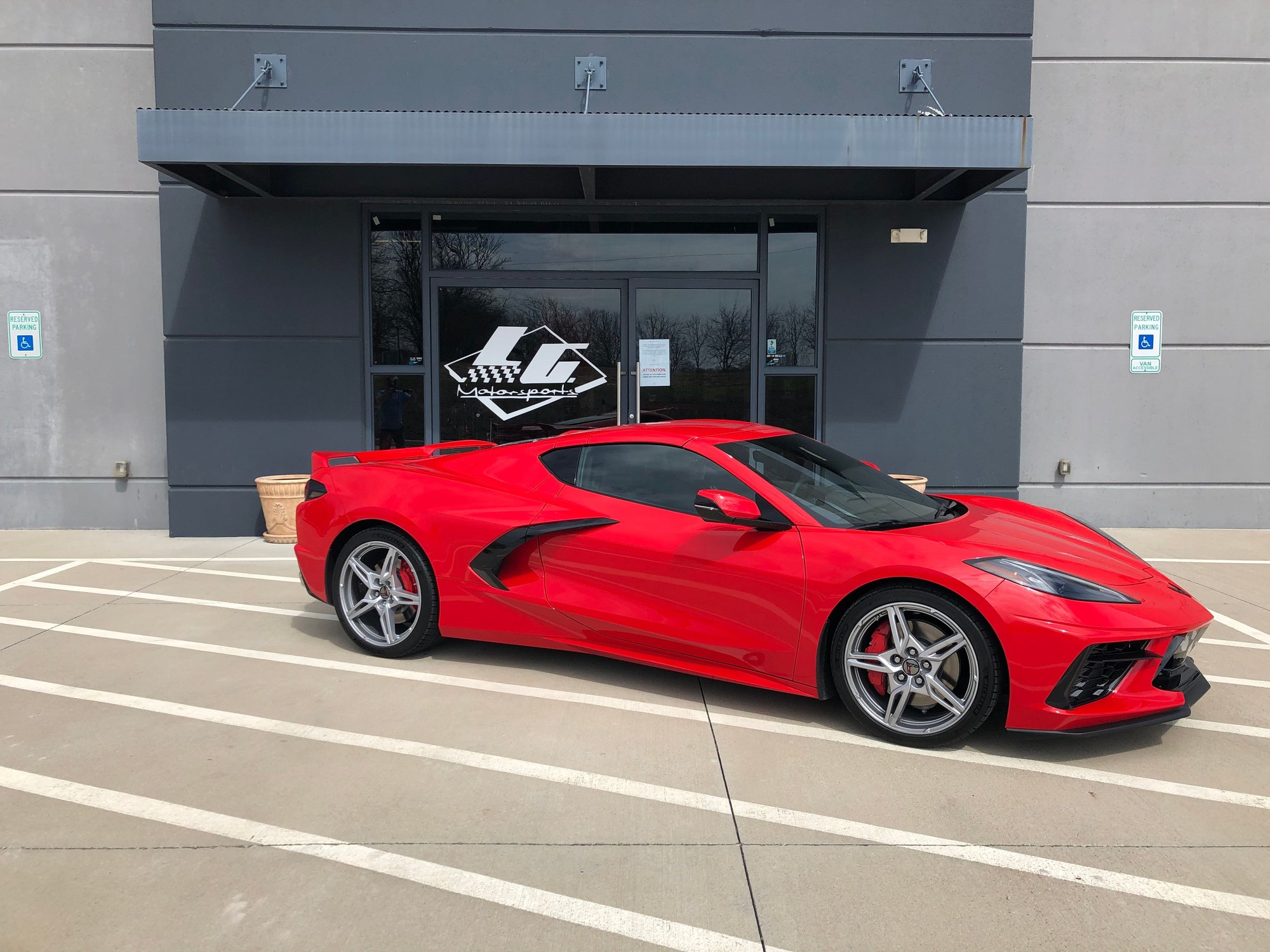

Day 1 Arrival at LG

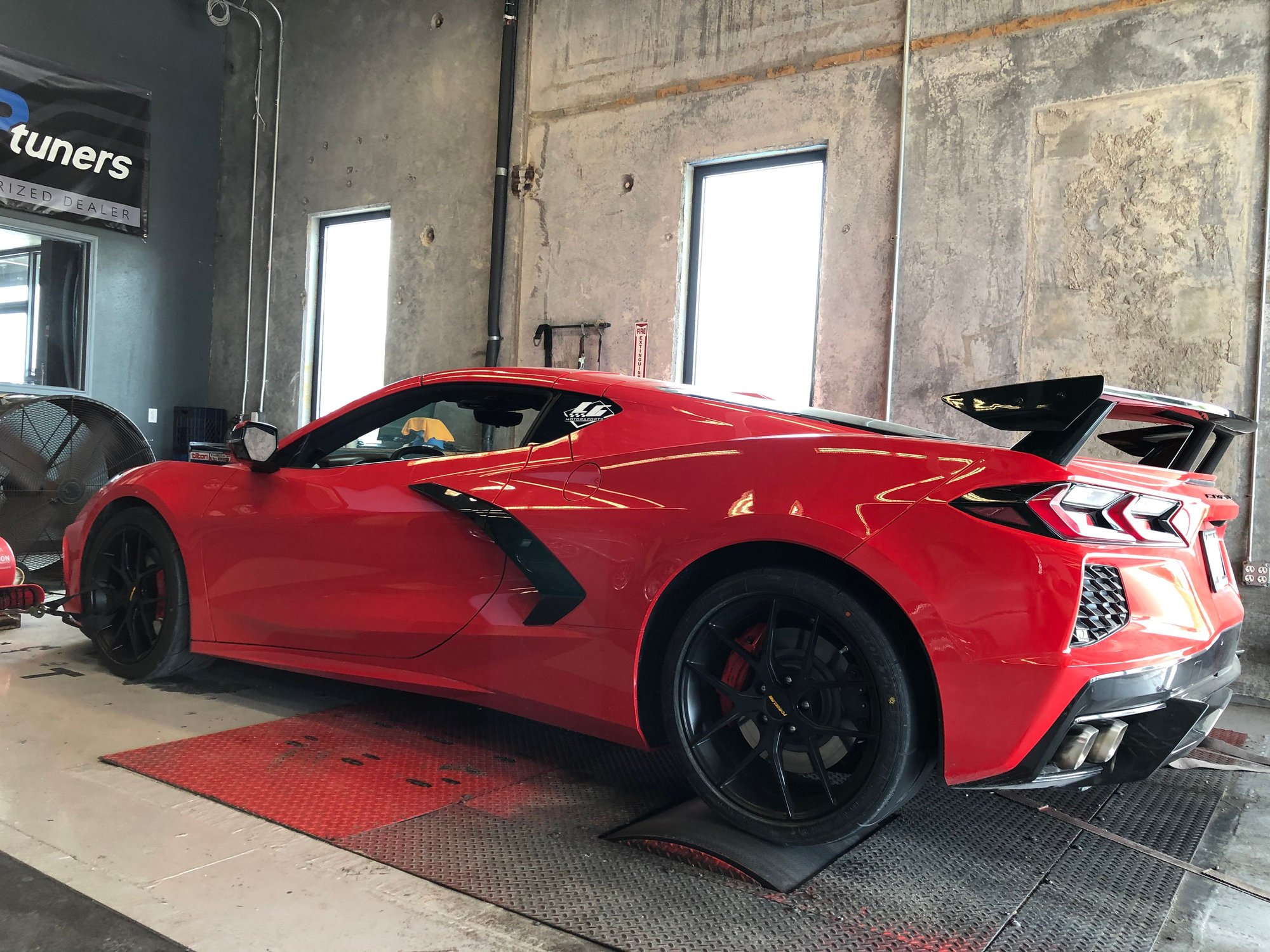

Day 2. Nitrous on the car netted a 100whp power increase with no tune. (We felt that the conservative factory tune along with race gas we would be safe to run a 100 shot).

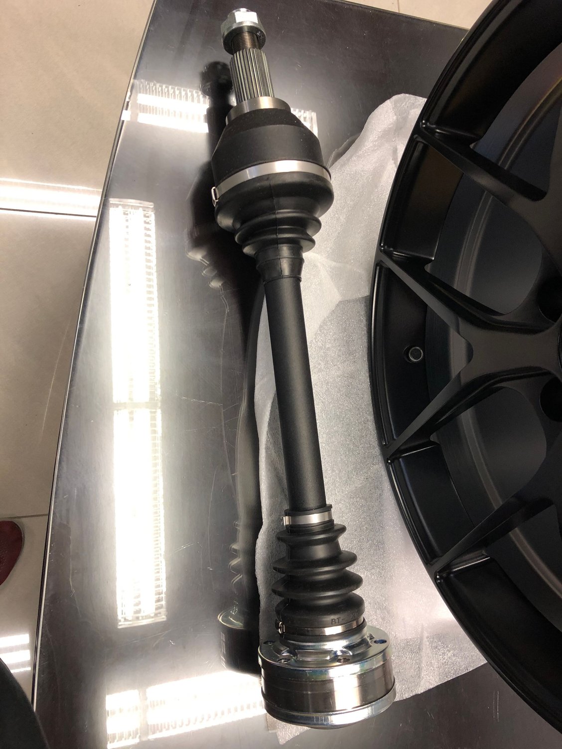

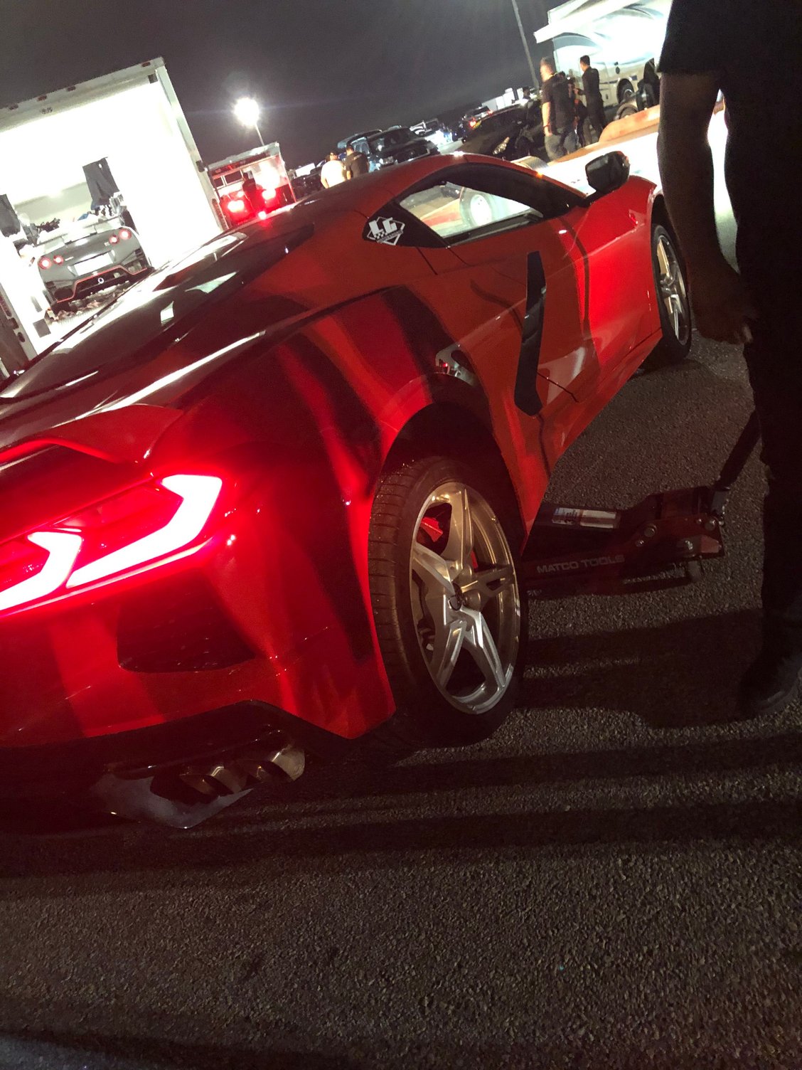

Day 3. We drove to TX2K and on our third pass on an extremely well prepped track experienced wheel hop and broken an axle.
We returned home and sent the axles to our friends at The Driveshaft Shop. New upgraded axles were to us in less than a week.

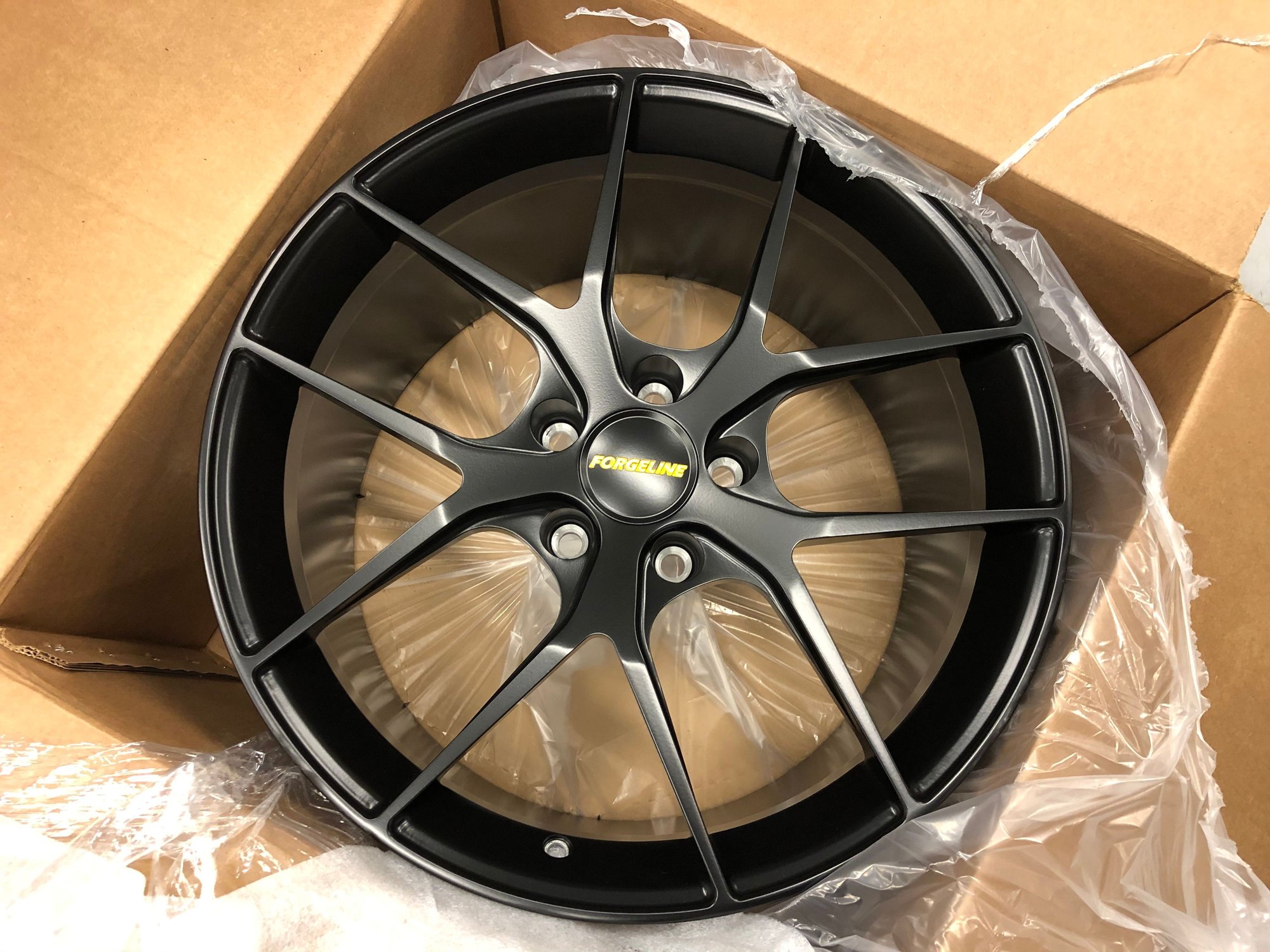

Forgeline wheels were next on the list.

Why can GM not put simple elegant wheels in the order sheet ???!!?
{And sorry for the thread intercept} But those wheels are gorgeous.

All good! I can't say I'm overly upset at the things GM leaves off, gives us aftermarket guys a market.

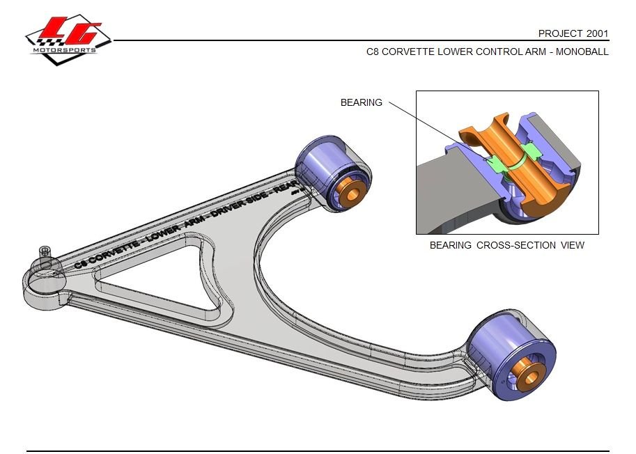

Quarantining ourselves at the shop is getting a lot done!

Nice. Get rid of the eccentrics. My tubular uppers have two Heims and one ball joint. All adjustment is done at the top. The bottom gets a one time shim adjustment.

We'll get there for sure, eccentrics are trash. Nice!
