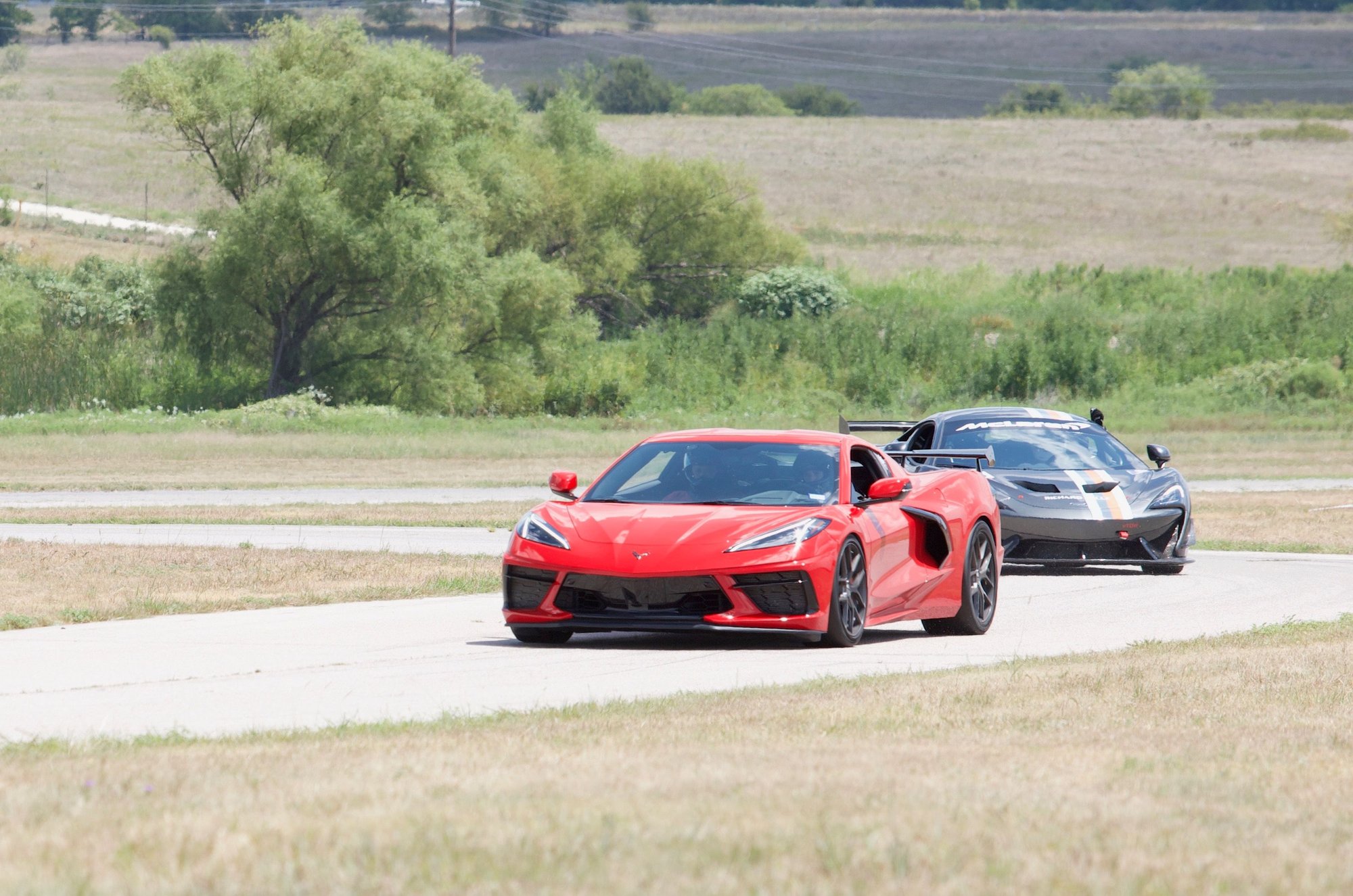

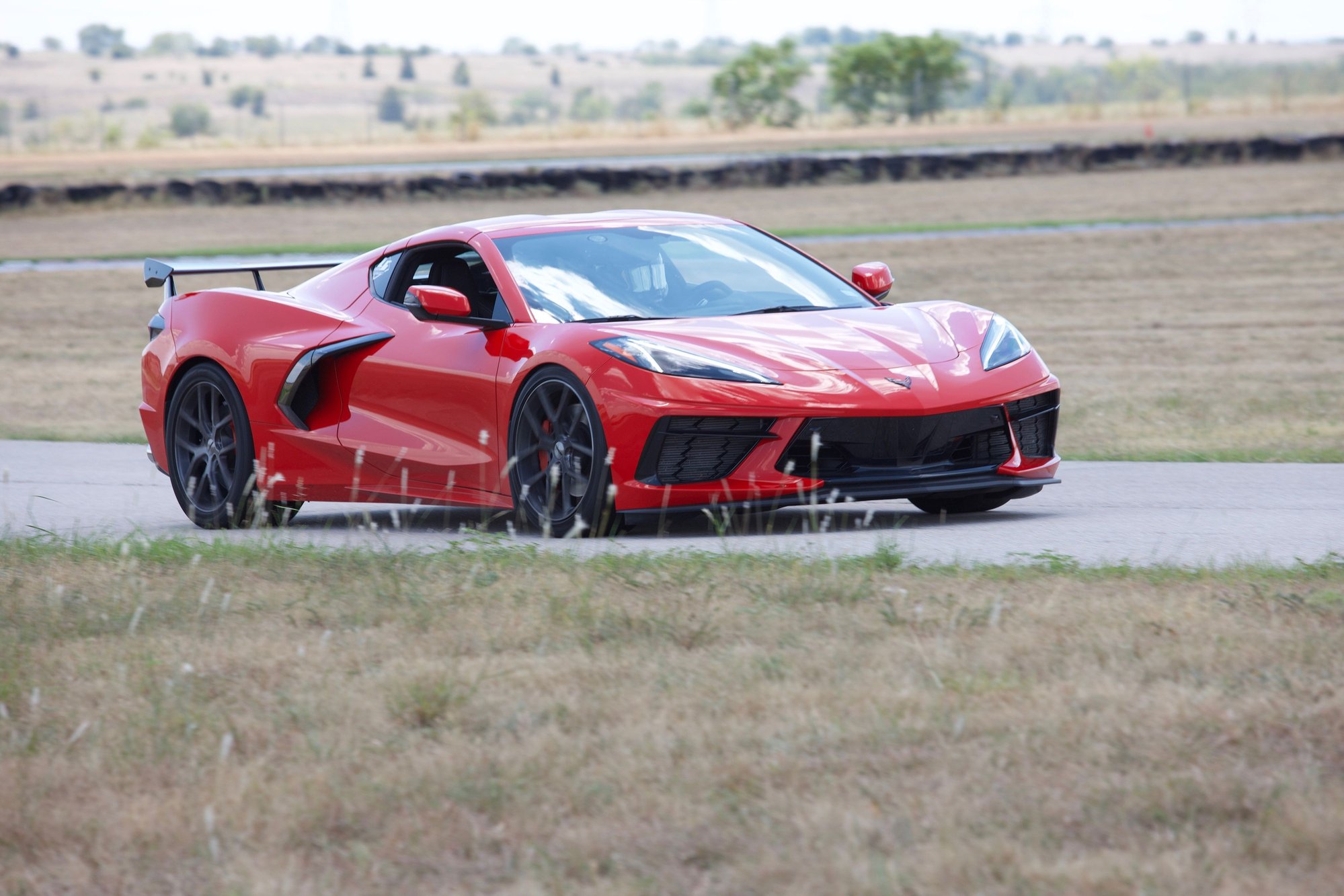

FINALLY have some time to update. Initial test a couple weeks back at Cresson MSR went well with monoball control arm bushings installed on the car. Adam was out with us to put in the fliers, 1:20-1:21 lap times on 94 degree day, C7Z06 would be in the 1:18-1:19 area. The car definitely had a 1:19 maybe 1:18 in it but not with the heat. We also battled a power steering issue that didn't end the day but definitely grew worse as the day progressed and temperatures increased. Heading to COTA this weekend to test sway bars.

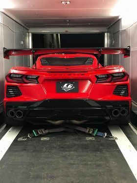

I can't believe I forgot to update after COTA round one.
So COTA round 1 last month went really well with prototype sway bars and monoballs. Quickest time was a 2:26 ambient temps were about 91 degrees and we had 265F/315R Hoosiers on the car.
Fast forward to this past weekend and a LOT was done to the car.
Front Splitter, Frame Mounted Wing, Harness Bar, Harnesses, OMP Seats & Forgeline GS1R's wrapped in 295F/345R Hoosiers
We finished up the upgrades at 7am Saturday drove straight to COTA and hit the track around 11am when temps were already at 94 degrees and quickly climbed to 97 by the time we were out on track. Lots of rubber on track and high heat so it was very greasy but we still dropped 4 seconds off of our non aero time while battling a brake issue. Definitely more in the tank as far as times with better ambient temp and brakes operating like they were in our first COTA test.
High speed stability was brilliant, low speed was decent but will get much better when we finish our Bilstein Coilover kit and get it on the car.
