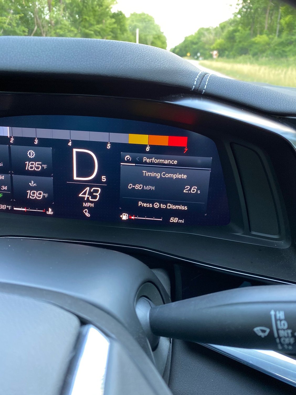

New low 0-60 using launch control .....
Great! Almost no fuel in the tank sure helps it seems.
