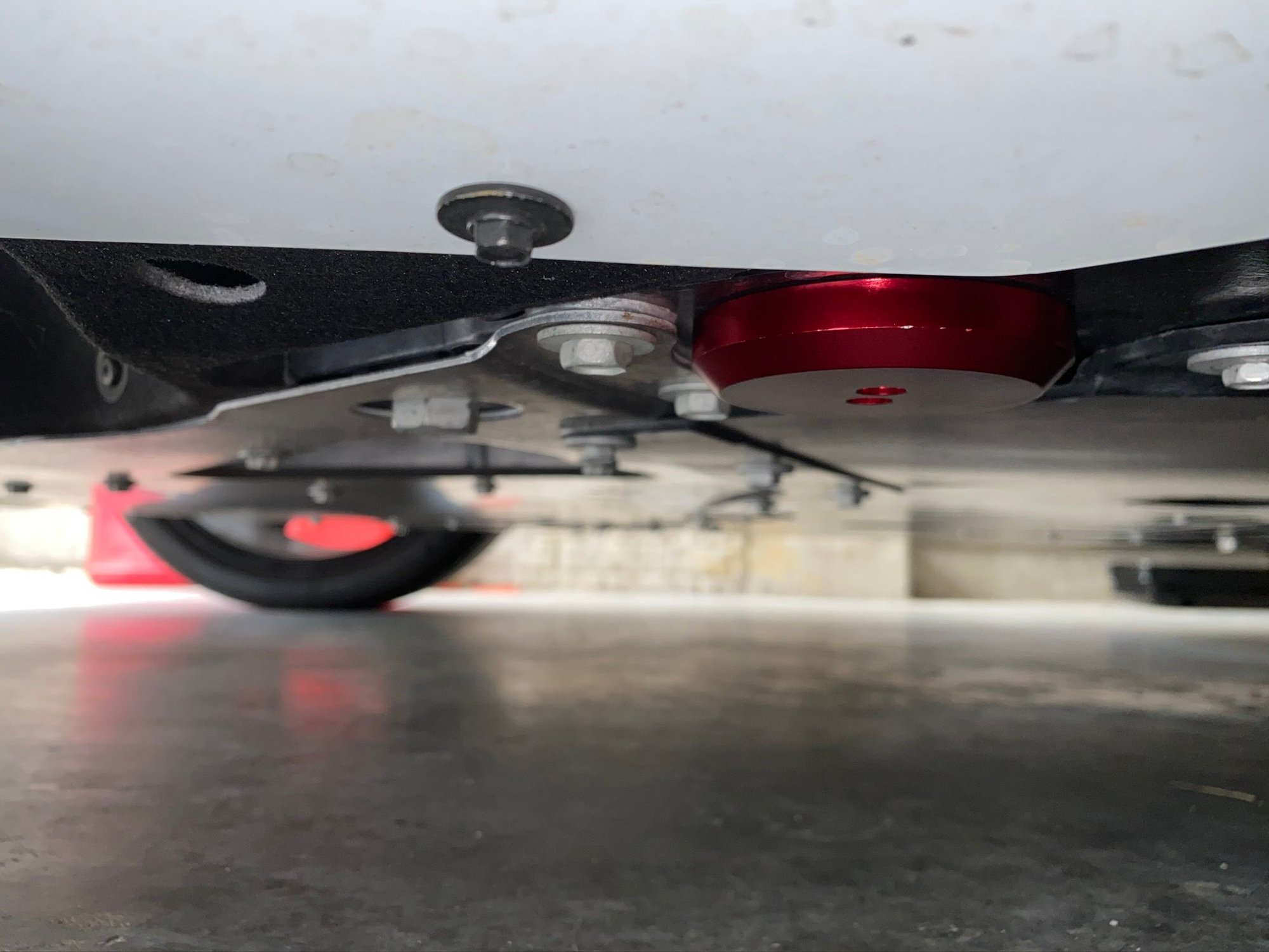

What is the measurement in inches from the floor to the bottom of the C8 when its at full height on the quick jack?

19 inches with 1.5 in blocks. I have 2 in Blocks but they almost contact the RED lift pucks at the ground/start position. The Quickjack needs a little distance between the block, and in my case the lift puck, to lift the car. BTW I have the 5000 SLX with the SLX Extension (must have extension with 5000SLX to reach the distance between the lift point— probably best to buy the 5000 EXT). This extension adds 1.5 inches to the standard height of the 5000SLX without blocks. The 19 inches accounts for the additional 1.5 in from the SLX Extension.

If you needed to raise the car higher, is there a place to set it down on jack stands and then insert higher blocks to get that extra couple inches of car height??
These are some pretty cool pucks. Who makes them, what was the approx. price and do you leave them installed on the frame when you are done lifting the car? .

I got the lift pucks from Amazon for $40. I keep them installed so that if anyone else lifts the car they know where the lift points are (which happened when I had EXPEL installed and Ceramic Coating).
The only place I know to lift the C8 unlike my C7 (has multiple places to lift car) is where the pucks r installed. Jack stands and QuickJacks can’t use the same lift points at the same time. The underside of the C8 is completely covered—no cross beams/axle to use as alternative lift point.
