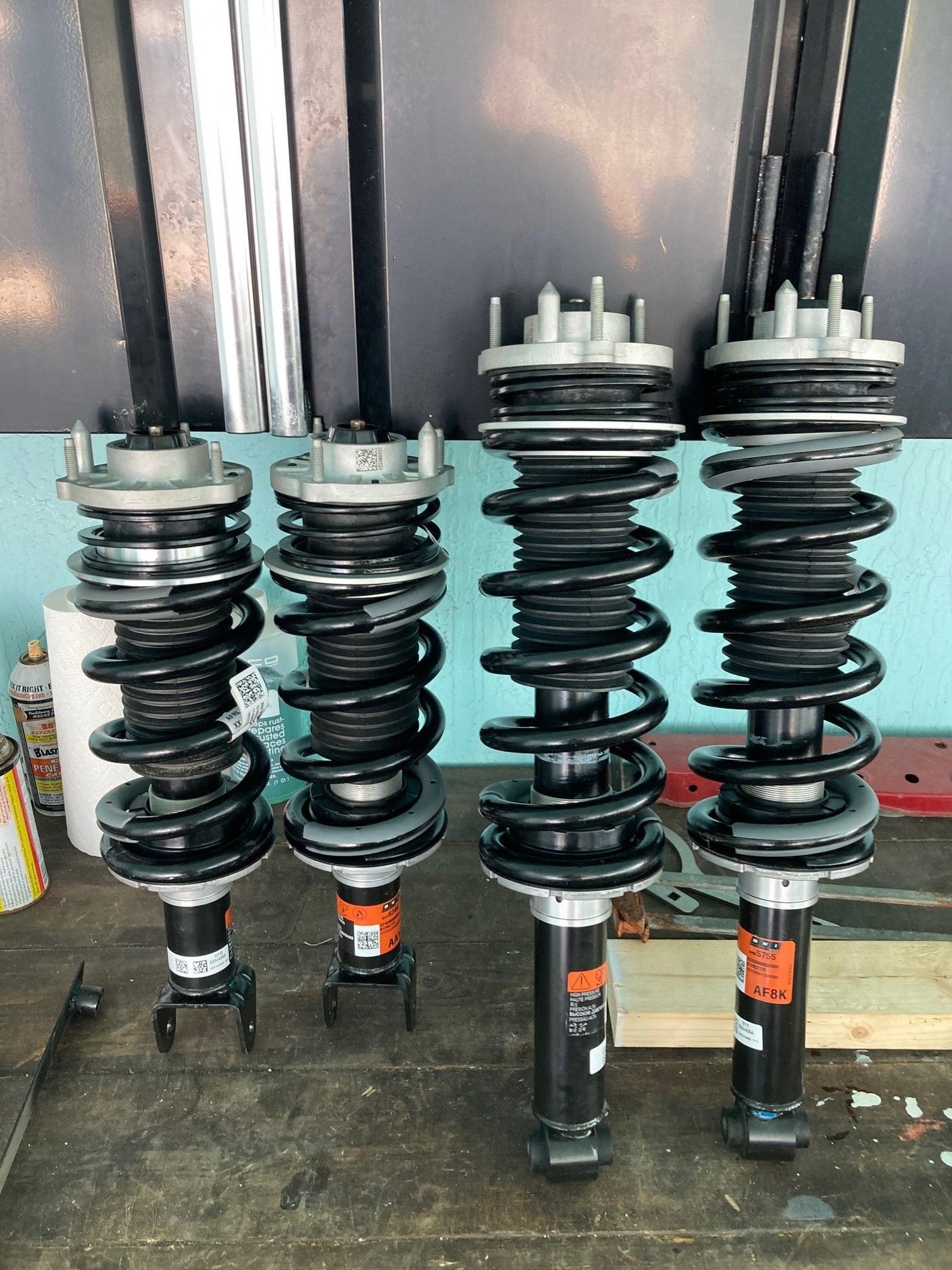

Assuming no front end lift, it's a threaded perch. There is nothing to screw up and no special knowledge needed, only a couple of special tools. It's as simple as moving a nut down a bolt. You just need to lower each side the same amount. What IS a PITA though is getting the )#&($)&#$ rubber boot off.
To your point about the boot. I'm putting a set of new Z51 shocks together off the car, they'll replace what's on the car. After getting that boot off I couldn't for the life of me figure out what it would do or protect once lowered. I cut them off.
