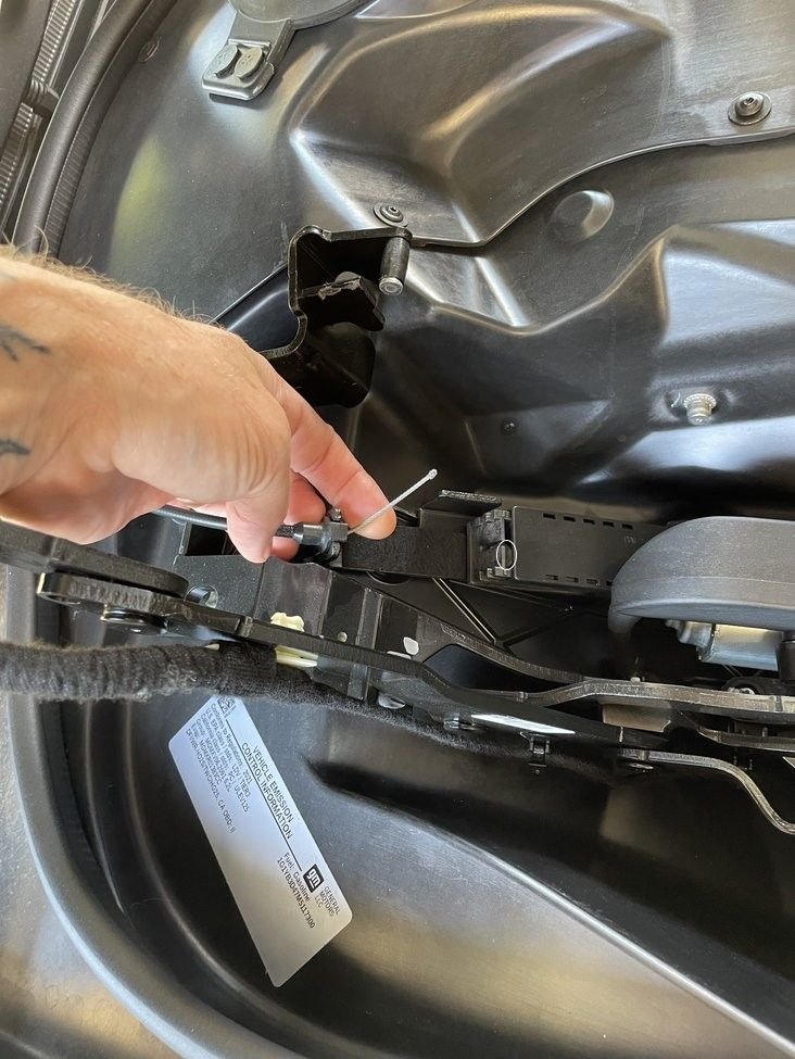

Could someone perhaps post a picture of the wire/mechanism with the roof partially open so I can better visualize this?

Old Sep 25, 2023 | 09:37 AM

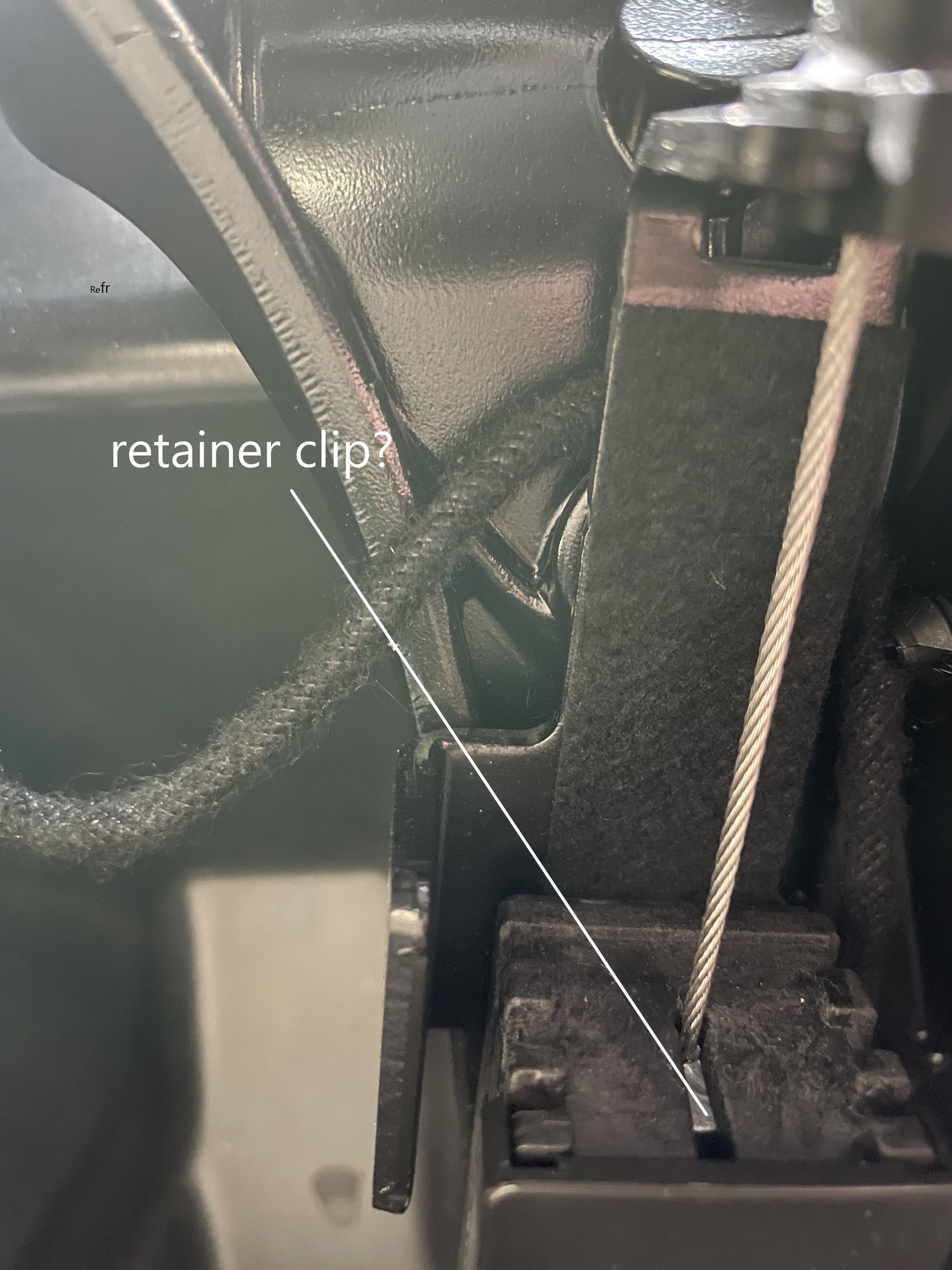

Thanks for posting a photo of the issue. Now I can ask the question I have been thinking about. Did your cable actually snap, or did it pull free from a retainer clip? And, is it possible to repair it? I'm not suggesting you should attempt that - its under warranty and I would let the dealer fix mine because these tops are sensitive. But looking carefully at your photo, I can see what might be a metal clip in the plastic holder where the cable goes. I marked that in your photo, attached. Also attached is a photo of mine. In this photo you can see that the metal piece is in place. I don't know if it is a retainer cip, or actually part of the cable (like a "button" on the end of the cable"). Your photo looks like it has a small ball on the end (or is that just frayed cable) that might fit into a retainer clip.
