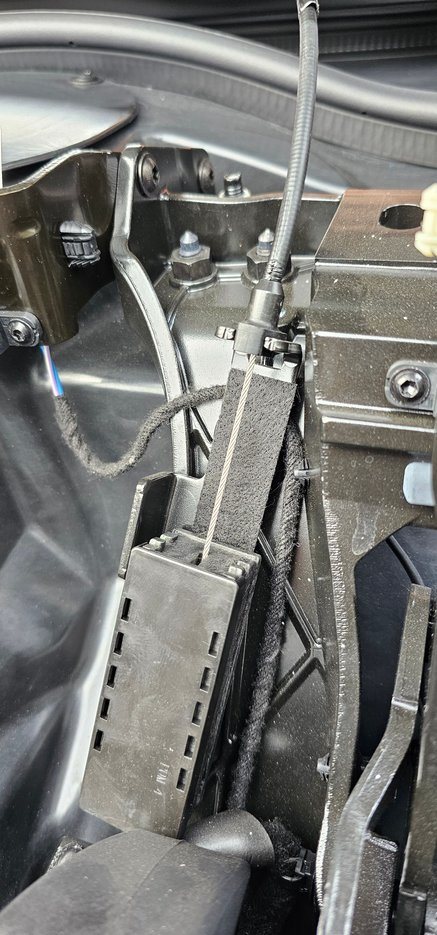

Originally Posted by tsigwing
I experienced the exact same failure a couple months ago. Same side too. Fixed under warranty.
Funny - I also used a tie wrap, looked exactly like yours, to hold it in place until the dealer got the part in.

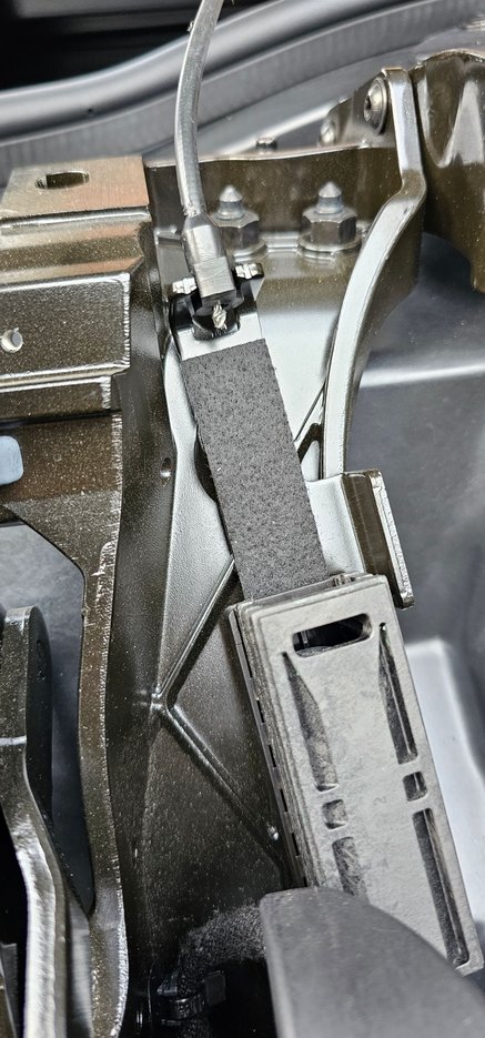

Happened to me today. Put the top down after lunch to go home and heard a pop. Initially I thought it might be the top sticking to the seals but when we got home and tried to put the top up it was apparent something was wrong. I was able to put the top down again to be able to drive it to the dealer. Time to schedule an appointment around the weather.
LH good
RH broken

You can zip tie the plastic "ear" that pops out to the frame behind it in order to be able to close the top.
