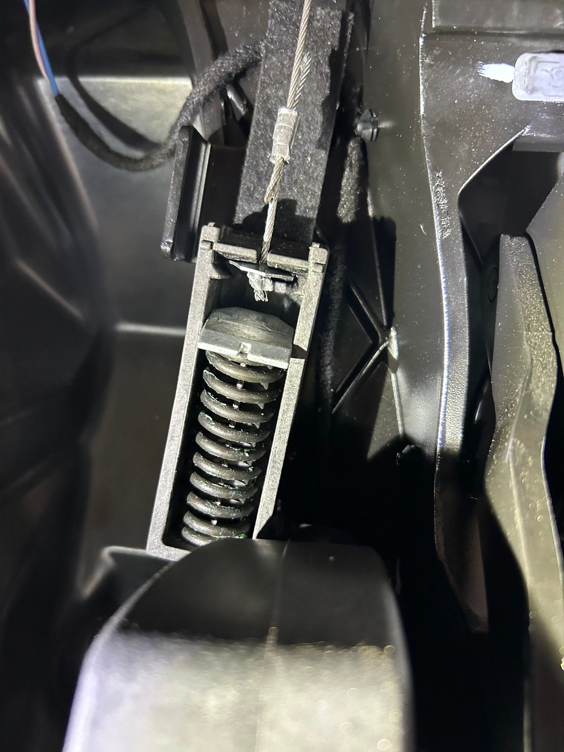

Just had my drivers side fail, exactly like the passenger side. Wondering if the extended warranty will cover, if not, has anyone replaced it themselves yet?

Here is a video of the guy who fixed it with crimping a speaker connector. I do not have enough slack to do this.

Ok, on further review I think I may try a similar repair on my own. Using aluminum ferrule and some 1/16" steel rope. Crimp a stop on one end, put that in the plastic box, then put the other end and the broke end of the other cable in a ferrule and crimp them together.

Is there a special crimping tool for this?

https://www.homedepot.com/p/Everbilt...E&gclsrc=aw.ds

Success!. Ran the top up and down several times works fine. Should have made the cable just a bit shorter as the ears are out of sync, and the drivers side doesn't tuck in quite as far, but it closes just fine. Had to remove the cable to cut off the bad end as it was swollen enough to not pass through the ferrule. Not sure what the official procedure is for installing this, but it is a real tight fit. Time will tell if it holds up.
I did reach out to my local Chevy place that did my passengers side and was told that it is not covered by the Platinum warranty. Bummer.

If this continues to work I suggest making a seperate post detailing the repair so it can be made a sticky in the DIY section.
