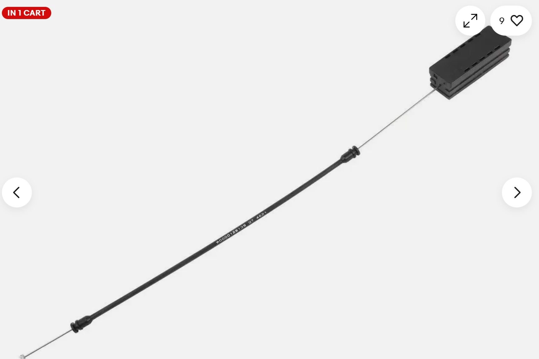

Default Cable replacement
Originally Posted by op z
Replacement cable part number is 85150325. About $270.
That part number is for the box and the cable that goes BELOW the gearing for the top. The top cable is another number: and the box opens to allow the top cable to be installed. I've been trying to find that darn number.

Default Bracket and Cable P/N
I believe you are referring to the Pivot Bracket which includes the upper side cable - P/N 85153567
P/N 85153567

Default HTC cable
My passenger side cable broke. I was under the impression that I needed the cable with the box attached but that was my bad. The actual part needed is the upper cable bracket that retracts the bumper. The part number is shown on the box along with the part. This part costs $150 from the dealer. Don’t make the mistake thinking you need that other end with the black box it costs in excess of $400 to $600 dollars. Check out the photos. You really don’t need to replace the bracket that’s totally up to you. I just replaced the cable and it worked out well. Not sure why Chevrolet includes the bracket but oh well. All you really need is the cable. Good luck.
