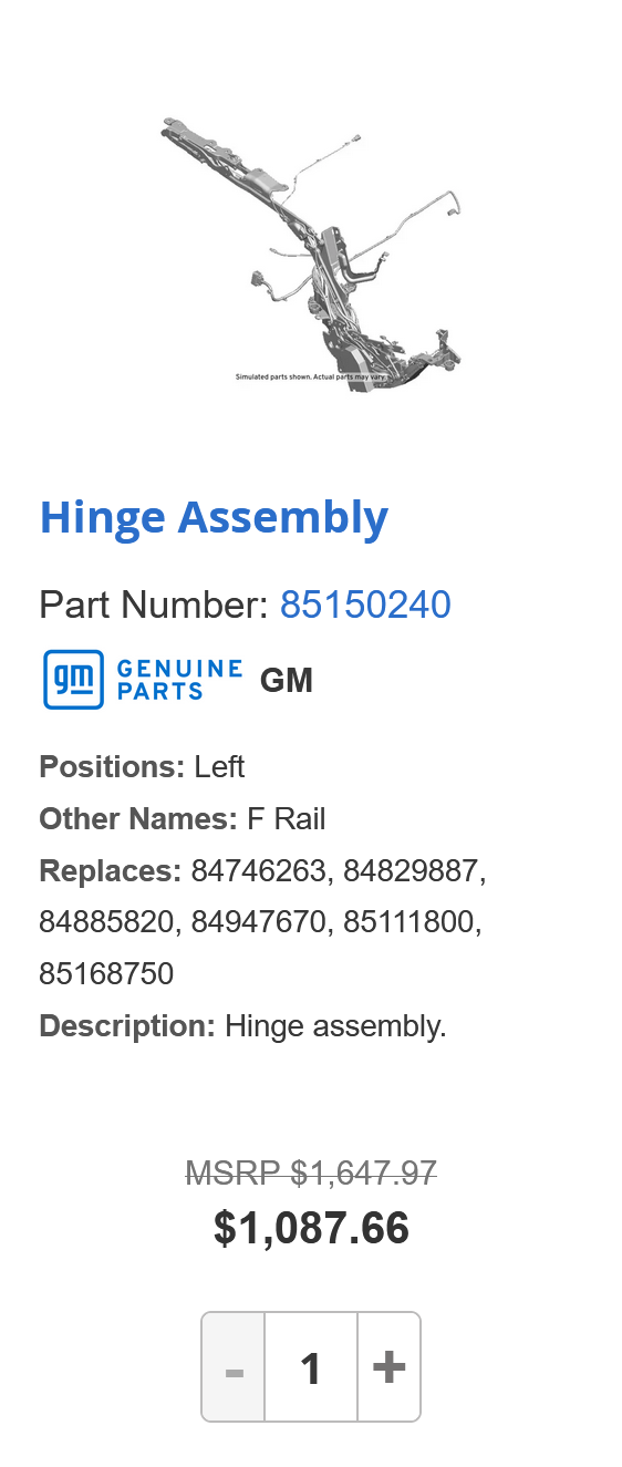

I would have expected it to be covered. Of course what I think doesn't count. But..... The Chevrolet Platinum Protection Plan excludes only CONVERTIBLE TOP FRAMEWORK and VINYL AND CONVERTIBLE TOPS. They like to be technical about the wording when its to their advantage, I suppose. But the wording is ambiguous. Try and find a part called Convertible Top Framework. For one thing, the HTC is called a "folding top" in the parts lists. And the cable, part number 85150325, is called a Folding Top Cover Side Tension Cable. (I got the part number from another thread on this subject, so I assume that is the correct number). But its not referred to as "framework".
In the illustrations below, which part is the Convertible Top Framework? And where is the cable even shown? That large component that looks like its the "framework" is called a "hinge assembly". I think the loose use of generic terms in the Protection Plan contract for part names contributes to the confusion about what is and is not covered.

For those that have or had a claim rejected it may be worth asking exactly what clause in the contract caused the claim to be rejected. Here's what Google AI considers Convertible Top Framework:
A convertible top framework is the underlying structure of a car's retractable or removable roof. It provides the support and mechanism for the soft top material or hard panels to fold, retract, or be removed and stored, allowing for an open-air driving experience or an enclosed cabin as desired.
The cable doesn't provide support but it is a mechanism. But it isn't directly involved the the top hard panels folding or retracting.
The Protection Plan needs to update its wording to be more specific of what parts of a retractable hardtop are not covered.
Prior to purchasing my Platinum Protection Plan I called the plan administrator and asked about the convertible top coverage. The way he explained it things related to electrical problems (wiring, motors, sensors, modules, switches, software, etc.) would be covered. Strictly mechanical items (panels, hinges, linkages, etc.) wouldn't be covered.
So with that definition by the administrator, the cable would be excluded then? In another recent thread, someone had a issue with one of the top latches and was told its not covered. But a top latch is not strictly mechanical - its electro-mechanical, just like the the motors I would say. They are probably actuated with a solenoid, or possibly a servo motor. They should be covered, right?
Add: my service manual does not have a complete set of procedures or information for the folding top - but one of schematics shows a "folding top latch actuator motor".
Edit: Didn't someone post some procedures for the folding top? I thought I saved them but can't find it now. The did, and I found it.
