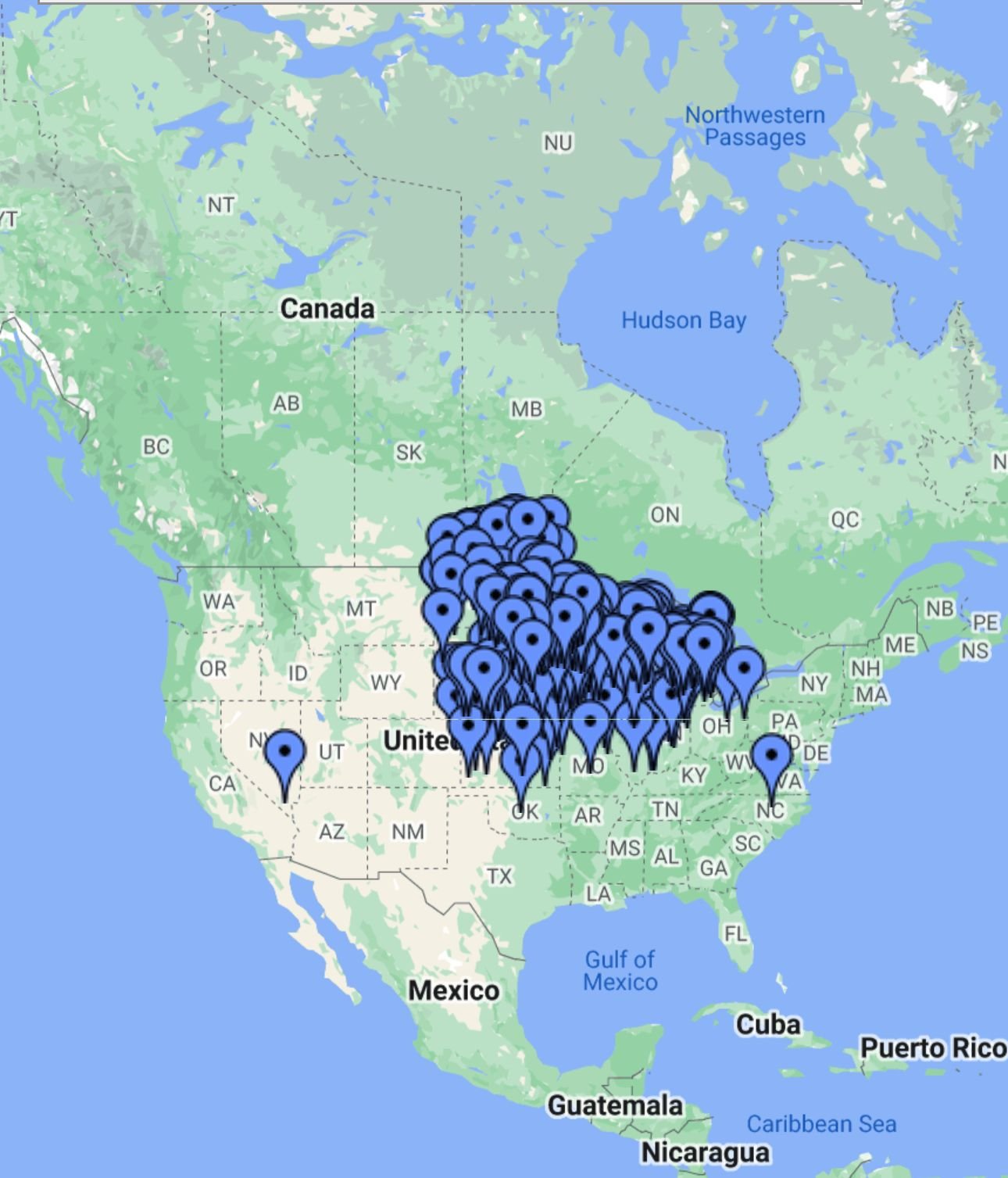

Thanks for the confirmation.
When I looked at the blender fuel map the Midwest seemed to have them all. East coast is a bust.
