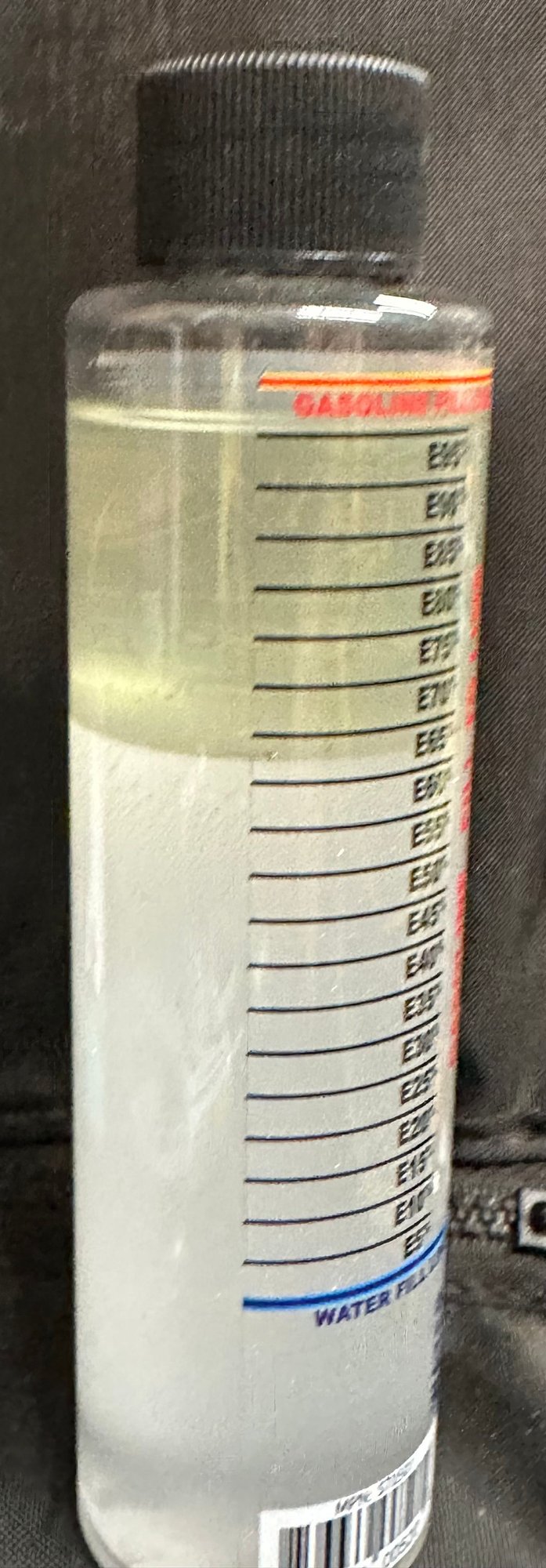

get a fuel tester, and test the content, there is absolutely no need to guess what the mixture is.

got a tester. The local Sheetz tested at 62.5.
Guess I need to find a place with actual e85

I’m using a station called race track. It tested at e68. The only place to get true e85 is out of a can or drum. Race e85 is not 2.75 per gallon though

Hey Kracka, I need your help. I have about 2.5 gallons of pump E85 that tests with my tester to be E65. My cars low fuel light came on and I figure there is only about 2 gallons in the tank now and its 93 (E10), how much more 93 E10 gas should I add to the tank before I dump the 2.5 gallons Of E65 in to get me a solid E30 fuel. I am guessing 4.5 gallons add to the approx 2 gallons in the tank now ... Thank you in advance.

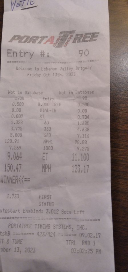

Drove to the track Friday with a nine 9 gallon mixture of 93 and E65 to create E30 thanks to Forum members Kracka's Formula and 65sohc. The DA was about 1000, 7-9 mph head wind. My car is a base 1LT, non Z51, Non npp, factory all season tires. The entire exhaust system is untouched, have a blue attack air filter, and 1st time introducing a E30 mixture utilizing the 2 gallons left in the tank to create the mixture, the car has never been tuned.
Tire pressure set at 25psi rear, 41 psi fronts, front sway bar links disconnected to enhance weight transfer. Nothing removed to save weight other than the windshield wiper jug is empty. The car ran 11.100 @ 123.17 mph. My 70 mile drive to the track on the highway included some 3rd gear wot pulls to redline shift into 4th 3 times, I can feel the power difference. The ET and trap speed tells the story I truly believe.
