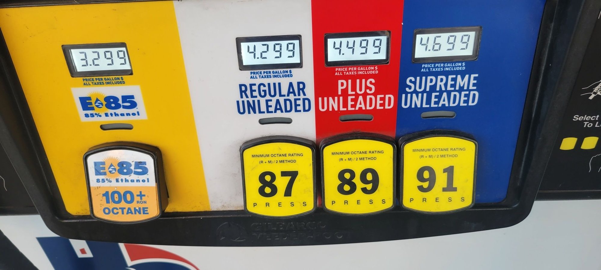

This is quite the conversation and has me intrigued. Ironically I have a station which I use down the street with E85. The price is extensively cheaper. I never considered the fact I could run any amount of E85 in my C8. Typically I run 91 from this same station which is literally $1.00 cheaper then the 76/Chevron/etc. across the street.
C8 full intake, ported intake manifold, ported tb (95mm), catback - Nitrous but not connected
Without being a math major if I were to pull in with say a 1/4 tank. How many gallons would you put in of E85 before topping off with 91 here in CA?
Are there any real benefits outside of price?
In the same topic, after I had a Maggie (2300) installed on my 2017 Camaro, I was pissed to find out it can't handle straight E85 because I didnt touch the LT1 fueling while it was apart. I even added the sensor but at this point its useless. Car makes 550rwhp and is tuned. Runs great.
Could I mix E in that car as well safely?
Again how much should I consider?
With the Camaro I have the capability to look at HP tuner logs but have no idea what to look for which is why I never touched. I essentially but HP Tuners for the Camaro and C7 so I could log if ever needed.
I know I am all over the place here but now I am a little excited I might be able to take advantage of a little E85????

5 gallons of E85 in the C8's tank will get you E30 creating approximately 95-octane mixing with 91 E10.

Chris I should of just text you. LOL I am going to start running 5 gallons in the tank. I am curious to see what my MPG look like. I get about 23 combined in the C8 and about 13 in the Camaro so it should be interesting.

I can get up to about E20-25 before seeing a slight impact to MPG (which you will see a little of at E30). But at a 30% discount, well worth it before you even consider the power/performance gains!
