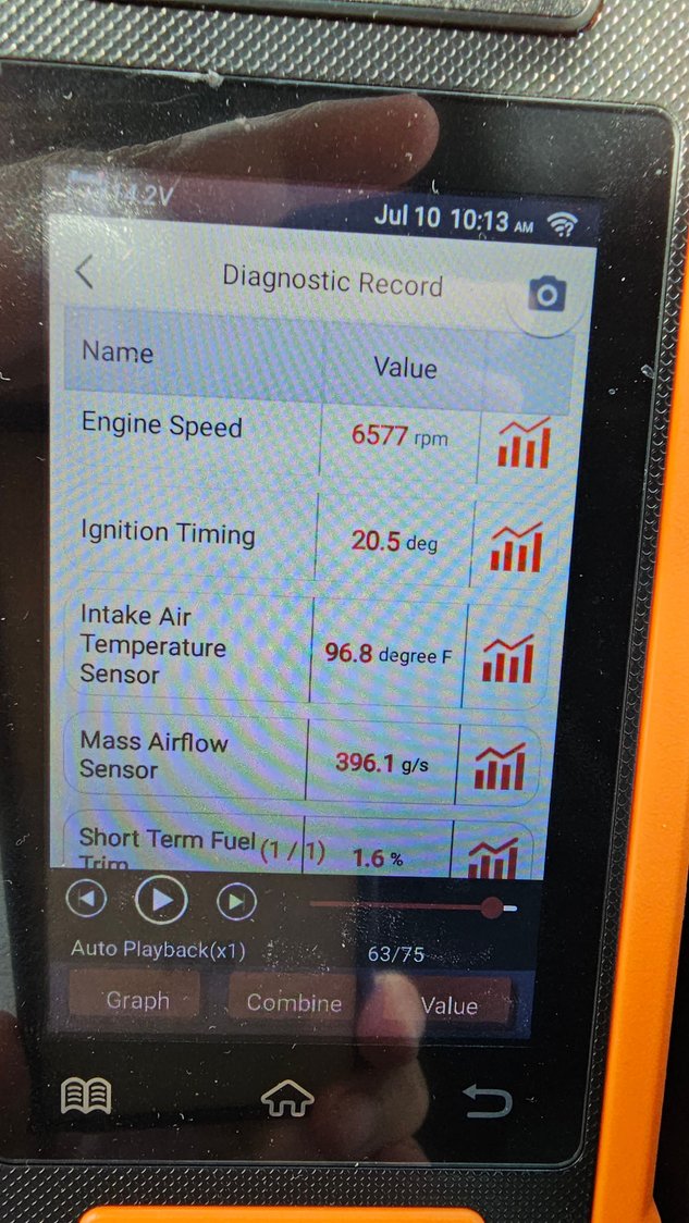

Now put your car in 4th gear and grab the following data....
Here you can compare your air intake volume before and after any changes.
I'm sure you know your intake air volume will tell you about power.
All this can help you in your testing to get you ready for better times.
The e.t. will come. It's not what you care about in testing performance mods. You want data that will speak to power differences so you can know what mods are doing, what mods to choose and then you can go focus on e.t.

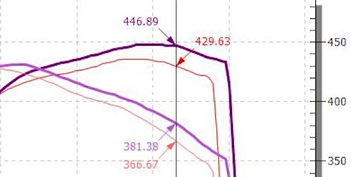

Here's a post of mine from back in April 2022. The Halltech intake really only shows gains for about 750 RPM worth of powerband, and in that same 750 RPM range, is absolutely decimated by the Corsa intake. Plenty will disagree with me which is fine, but the Halltech design is basically nothing more than an enlarged stock design retaining the negative attributes of it, including reusing the restrictive/small factory inlets along with the forcing already turbulent air to make an immediate 90-degree bend as soon as it passes through the filter media.
Originally Posted by Kracka
If the absolute top-end is what you're after, here is a comparison I made Halltech vs. Corsa from just 5,000 to 6,500 RPM.
Halltech:
Corsa:
Quick summary of peak numbers with gains, in order of appearance, so we have it documented:
Brand / WHP / WTQ (gains)
  • stock / 436 / 428
  • K&N / 441 / 430 (+5/+2)
  • aFe Pro5R / 441 / 429 (+5/+1)
  • aFe ProDryS / 444 / 435 (+8/+7)
  • Halltech / 443 / 428 (+7/+0)
  • Corsa / 448 / 431 (+12/+3)

Won't disagree at all. Halltech hits pretty hard at low end but kind of smooth out on top end similar to stock. AFE seems to pull very hard up top. I guess that's similar to the Corsa. One member trapped 125 with a simple bolt-on down here in Orlando with AFE. But for now I am satisfied with my Halltech. Thanks for the info.
