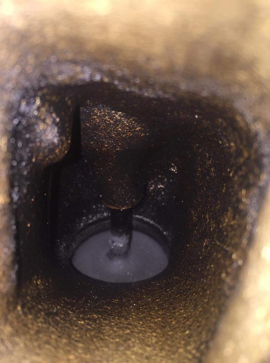

Here is a picture of a LT engine intake valve after 27K miles without a catch can:
https://www.camaro6.com/forums/showt...'s%20above.
And a LT engine after 40K miles without a catch can:
https://www.camaro6.com/forums/showp...9&postcount=42
And a L83 motor after 117K miles without a catch can:
https://www.performancetrucks.net/fo...e-also-552370/
I'd be interested in seeing how much better engines with catch cans look after these kind of miles

Spirited driving (particularly track) will significantly increase the amount of blowby compared to a lazy Sunday morning drive, so if the purpose is to reduce oil in the manifold, the "need" for a can really depends upon how the car is driven.
In RKCRLR's first pic, the guy purchased the car used @ 27k miles... we don't know how the car was driven. The second pic shows his wife's Camaro SS (not his) @ 40k miles... we don't know how she drives. Last pic was stock Sierra @ 117k miles (disturbingly clean... like, this truck has never been driven, clean)... but we don't know how he drives. Seeing the pattern? It's difficult to draw useful conclusions without all of the data. Several here, however, have shown their cans are catching significant amounts of oil in only 1k miles, and we do know their driving pattern as they usually tell us.

I agree how much you catch is dependant on how you drive. If I was frequently tracking I'd probably add one. And if I was doing engine mods that affect breathing I'd definitely add one. But I don't believe it is necessary for stock LT engines even during the most spirited street driving.
Some believe that it is a self-fulfilling prophecy, i.e., the very act of installing a catch can upsets the balance of the PVC system and will cause you to collect more fluid. I don't know if I buy into this but it is a plausible theory. Nor do we know if there is a correlation between the fluid in the LT PVC system and carbon buildup on the valves. It would be interesting to see an analysis of what the fluid is.
What we do know is that the LT engines have been out for a decade now. If there was an inherent problem with intake carbon buildup on otherwise normally operating LT engines you'd think there would be at least a few reports of it. There is certainly no shortage of reports on the internet of engines that do have a problem with carbon buildup.
