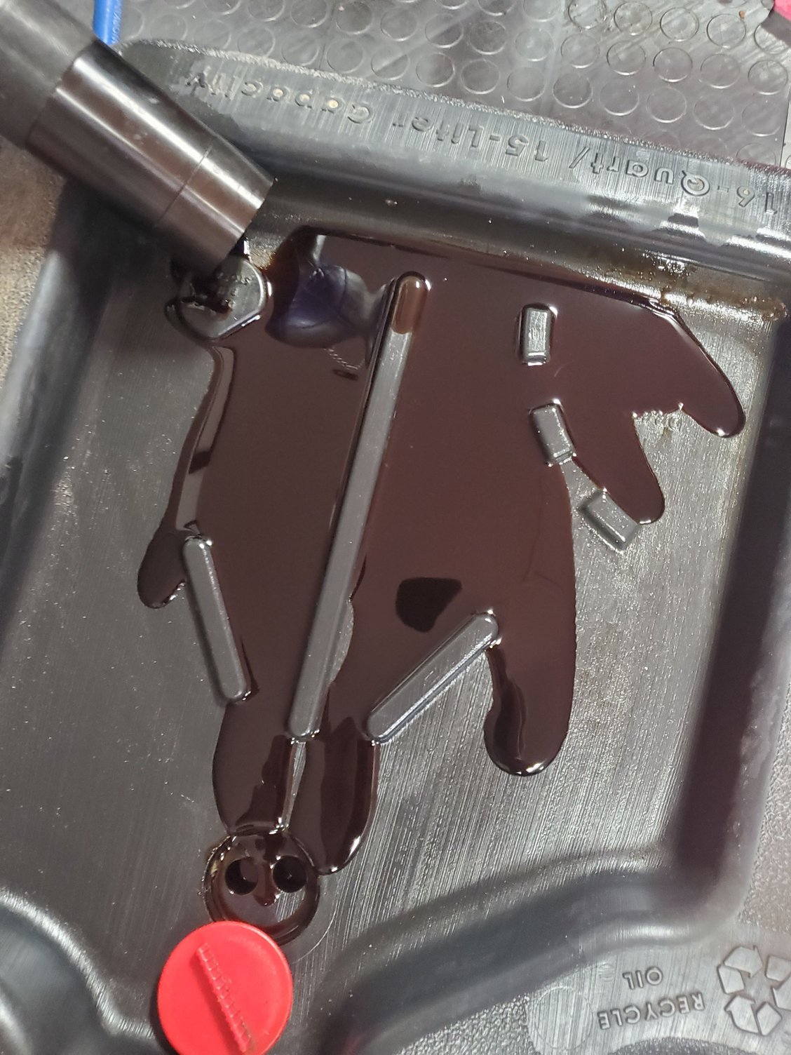

When I first bought this car I originally bought a catch can. Every car I’ve ever owned has always needed one. Especially for heavy use. When I went to the PTR intake I didn’t have the hoses and fittings I needed right off the bat so I lazily went with it. Pride is hurt a little today. I always do full inspections after every track weekend and I was getting a very little pool of oil in the coupling leading to the throttle body. I’d clean it and move on. It didn’t seem to worrisome.
The last few weeks I’ve been going through this car like a fine tooth comb getting it ready to go to the shop for my heads and cam. Maybe more. Cleaning the whole engine bay, suspension, and so on. It’s usually clean anyways but I want it spotless for my shop. Just who I am. Being mostly track car I’m diving in more and deleting simplifying several items along with deleting the EVAP system (hold your opinions to yourself on that ). So needing to remove the PTR intake I get this slight hint of sloshing sound as I pull it off. Video below shows the rest. I was planning on putting a catch can back on this winter. So I fired myself today but had to rehire to get it done. 😀
This car along with all others show that no engine is that great from any manufacturer when it comes to several factors. And they’re not meant to be honestly. In the long run all cars are seen as just street cars from the manufacturer. Period. Even then some things are questionable. Take this for whatever you feel. My shop plus LME have both identified from multiple built motors from the LT2 dry sump system have some minor flaws within the new design. Especially the crank case pressure. More so under hard driving (tracking), especially under deceleration as I was told and all FI setups. LME had already made few changes to their products as briefly explained on their site. I’m just catching up. Everything has its learning curves and at least they’re being discovered and altered. Just putting up some of my experience. I'm sure there may be some slight other underlying issue and this was over a period of time but doesn't change the fact to much.
“But it’s designed perfectly from GM”. I’ve had so many laughs to that statement. But I knew better.

Wow, i did notice oil in my intake manifold when swapping it out for the modified one. So, I installed a can.

Well that makes me rethink not installing a catch can. How many miles/hours do you estimate are associated with getting that much oil?

Im going to say about 4 track weekends about 18 hours and roughly 300 street miles. You can easily get away without one for normal use but why not. Pretty inexpensive and peace of mind. Like to remind you, LME engine builder a reputable well know company has said they found a few things that could have done better with these motors and have made a few changes on their builds. There is more than desired crank case pressure in these cars. I just blew a rear main seal from this. Keep in mind my car is driven harder. Just sharing possibilities.

I installed a catch can with less than 10 miles on the odometer. Its good insurance and the video op posted reaffirms that

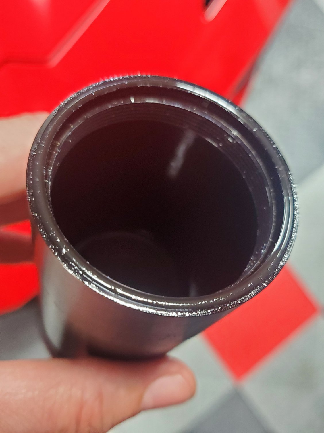

This is after about 1k miles, I swear by a catch can. Rather be dumping out the oil vs it going thru my intake and coating my valves.

I agree, I also empty my catch-can usually after putting about 1,500 miles on the car. I have read other threads about people thinking its not needed or why didn't it come with it if needed. Clearly guys who install catch-cans are showing genuine proof of the oil that is produced through PCV system. I know some people may think it's not a big deal. It's their car, so it's their decision.

thanks for sharing. I know a popular argument as you also mention is the engineers would have put one on if it needed it.
As we see on this forum and elsewhere, some people can't even change their oil once a year so how would they empty their catch can out more frequently and the disposal of that oil is a concern since a lot or people do not do their own oil changes or have the means to empty it. The cars will be out of warranty by the time any problems may arise from carbon build up so its not as big a concern by the manufacturer I believe.
Some of us feel better having them on and it's a cheap and easy mod if you feel the need to add it.
