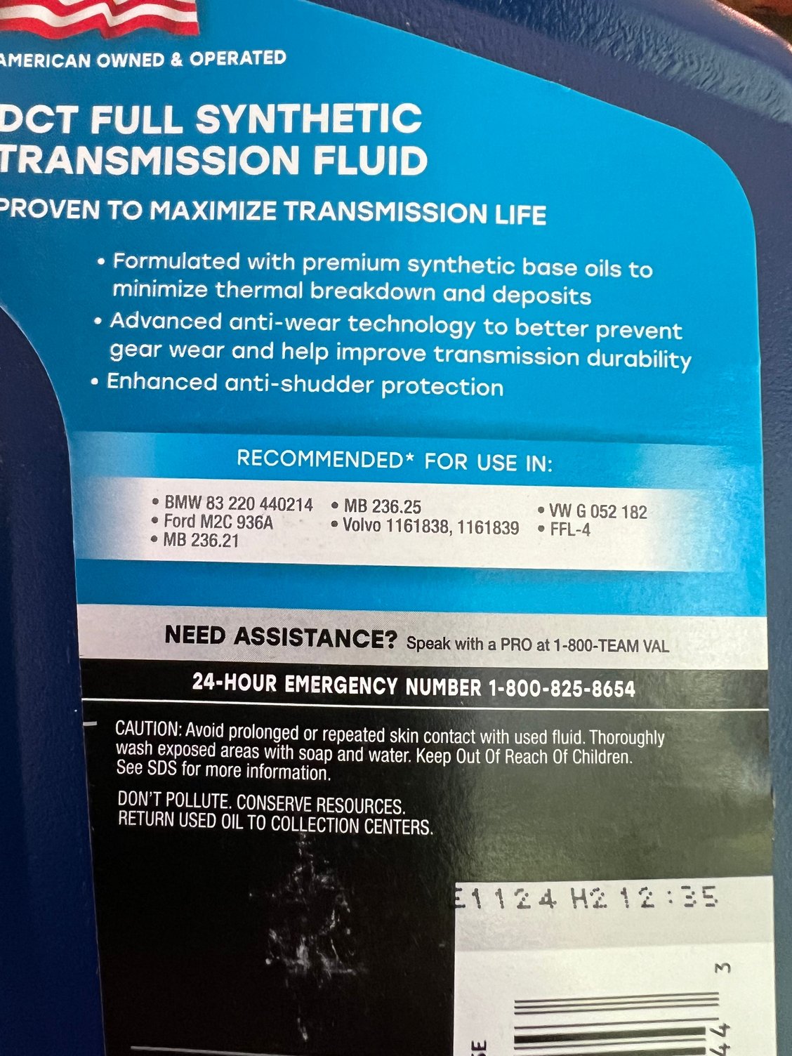

I'm sure the Valvoline product is fine, and I never said otherwise.
But the Ford and Getrag specs are great examples.. The Fuchs Titan FFL-4 website lists "approvals" and it lists "recommendations". It lists only one approval and that is GETRAG (PWA05043). The others, including the Ford spec, are recommendations. It does not list FFL-4 because that is not even a specification. The product data sheet for Valvoline DCT has a long list of recommended uses that include FFL-4, but lists no approvals and no licenses. And, it doesn't even include the GETRAG spec in its list of recommendations. I'm sure if they had approvals or licenses for a specification, it would be listed as such, as it is for other Valvoline automatic transmission fluid products. For example, Valvoline has this to say about their Dexron VI/Mercon LV product.
"Valvoline Dexron VI/Mercon LV ATF is the full-synthetic automatic transmission fluid that has been uniquely engineered to meet and exceed the requirements of the General Motors Dexron VI specification and is officially licensed and approved by GM. And in the product data sheet, we find “It is officially licensed and General Motors approved for the GM DEXRON-VI specification and recommended for use in Ford Mercon LV applications.” Note they are careful to distinguish the GM approval from the other recommended application. There are no other licenses or approvals listed – just recommendations.
My points were really just 1) TREMEC and GM recommend specific products (Pentosin FFL-4, Fuchs Titan FFL-4, and Delco DCTF FFL-4 depending on where you look) but do not references a "specification". 2) FFL-4 is not a specifcation - there is no approving or licensing authority - unlike API, or dexos, or GETRAG etc., 3) the Valvoline Dual Clutch Transmission Fluid lists recommended uses, but list no specification approvals or licenses.
Valvoline is a great product with a great reputation. I'm not saying otherwise. My concern is statement such as "any FFL-4 transmission fluid will do".
The Valvoline website finder tool recommends its Dual Clutch Transmission Fluid for the C8. If one chooses to use the Valvoline product, the choice is based on the Valvoline recommendation and trust in the reputation of the manufacturer, and not a specification. Valvoline very likely analyzed the Fuchs formulation and developed a comparable product that meets or maybe even exceeds the performance of the fluids that GM has recommended for the C8.
