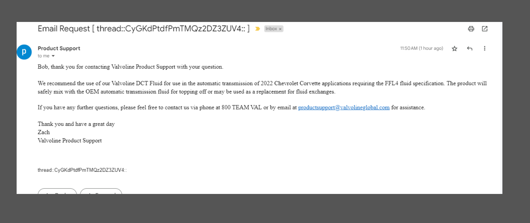

While I agree that using alternative fluids may be ok, I will offer my anecdotal story of using Redline MTL in my M5 and the shifting was just not as smooth as the BMW branded fluid. I also used a diff fluid in the LSD and then I got some noises at low speeds while turning. Switching to the BMW branded stuff fixed both issues. So, there are details in OEM fluids that may not be totally replicated in other manufacturers' stuff even if they have some form of specification listed on the bottle. But, I agree, the Valvoline stuff seems legit for the DCT. I may consider it next year when my fluid change is due.

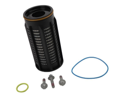

Originally Posted by cmck0916
I'm surprised that after 5 years and 170,000+ cars produced, no filter companies have stepped up and offered an alternative to the insultingly overpriced $110 GM filter. I mean it's a pretty basic filter with no exotic/expensive materials used...perhaps someone who has contacts at one of these filter companies can drop a hint!
Oh the make 'em! Here is one (not recommending it):

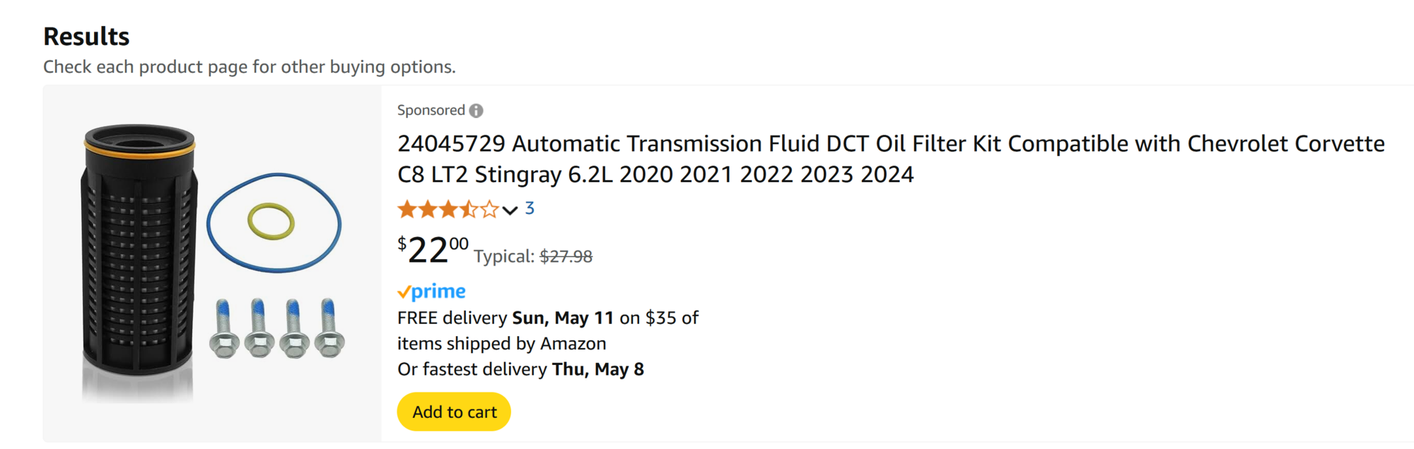

There are non-OEM filters available. This might be the same as OEM but procured through a different supply chain, a knockoff, OEM reject, etc. I don't know if anyone has purchased one to compare it to the OEM filter.
Amazon Amazon

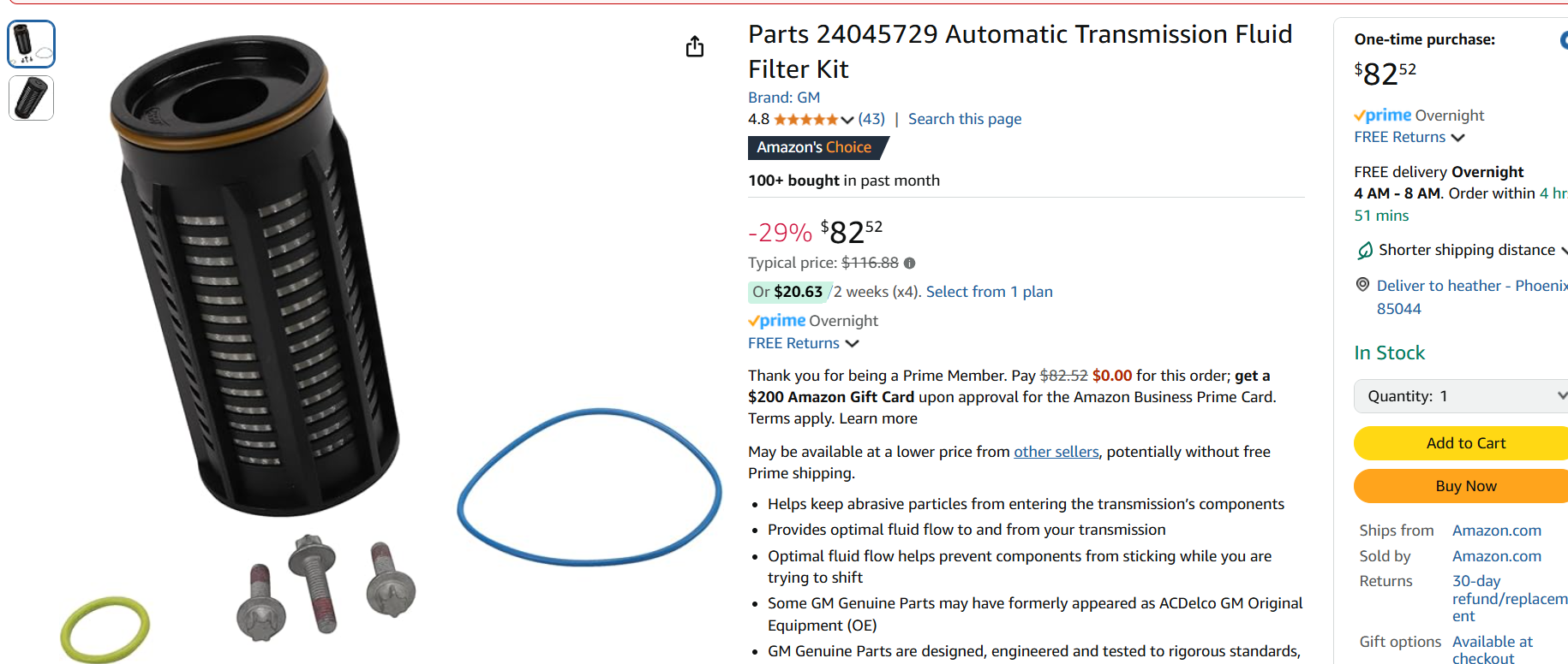

Based on legit, this is as low that your going to find. Believe when the C8 first arrived in 2020 these filters were over $200.

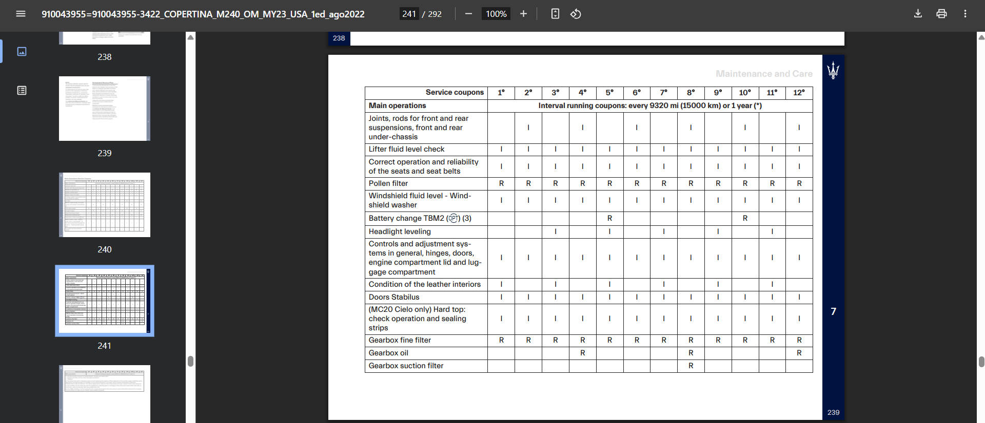

Also I'm following the Maserati MC20 TR-9080 gearbox fine filter change recommendation, "every 9300 miles or 1 year". Feel GM's filter changes are over extended for the Tremec DCT.
