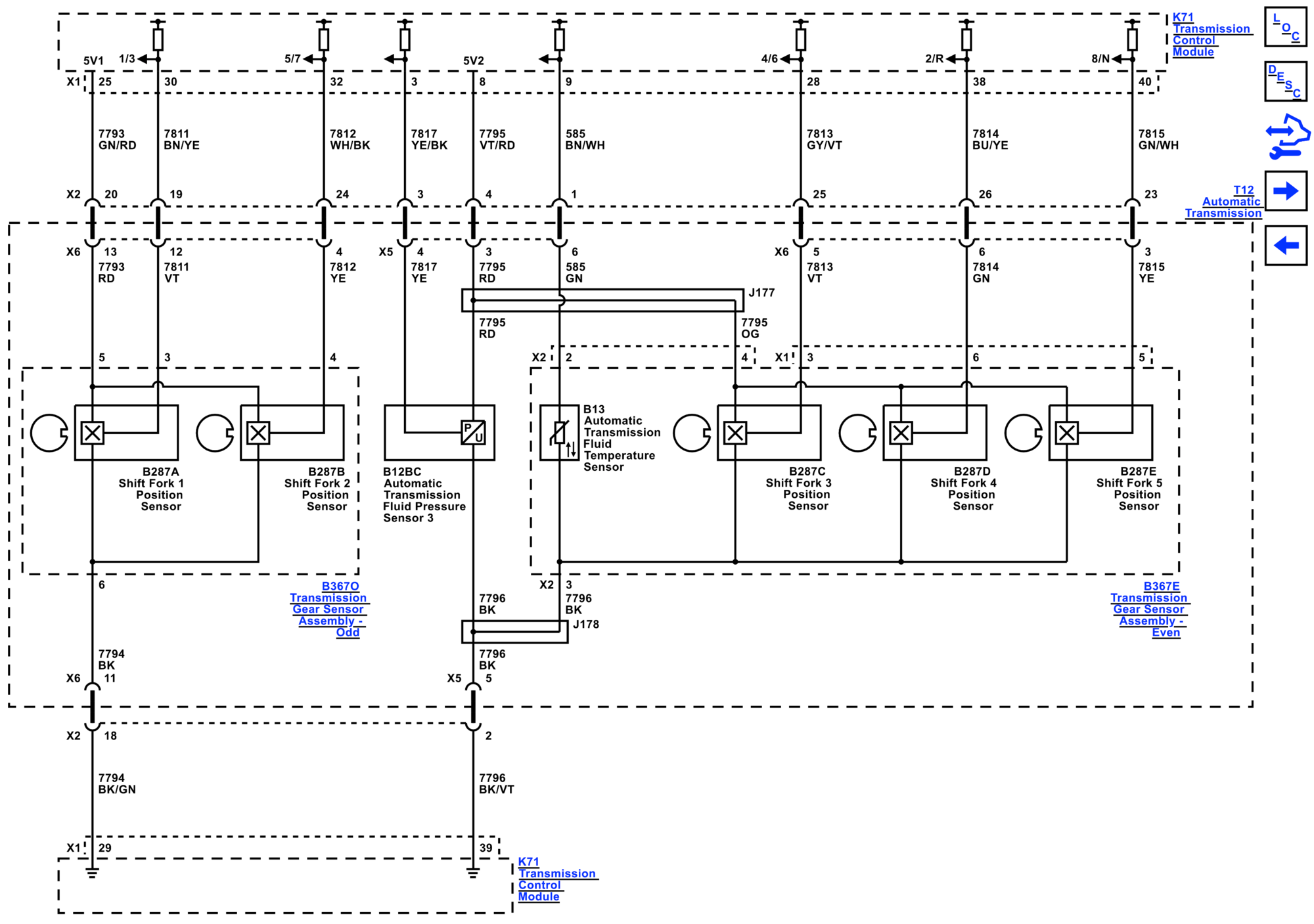

As Mittens and Mitchell_B posted, the parking sensor has two failure modes: metallic contamination and alignment drift. All C8’s whether Stingray or Z06 that have a DCT mfg date of 2/23/2023 (Wixom) or 5/15/2023 (Canada) and earlier, are subject to either failure. This affects the entire MY2020-MY2023 production run up to the release of Die-3 DCT’s @ BG in August of 2023.
While Die-3 DCT’s resolved the parking sensor faults, there are five more similar sensors that detect even/odd shift fork position. There have been numerous problems with metallic contamination on these position sensors as well, and they are in ANY TR-9080 C8 DCT ever manufactured…..including the ZR1. I was told that to redesign these sensors was a significant change and not economically feasible. Attached is the TSB outlining the procedure to flush the DCT three times in an effort to clean the sensors and shift solenoids.
As I have posted numerous times, I formerly worked for GM Engineering, and the number of catch-22 situations that go on behind the scenes with vehicle engineering and design is boggling…..the bean counters call the final shots…..not the Engineers. For reasons I cannot understand, GM/Tremec designed a bespoke DCT using a shared sump. Against any other proven split-sump DCT design in other hi-perf cars, they decided to go it alone and use FFL4 to lubricate an entire wet-clutch transaxle. I can guess it is the same idiotic committee engineering that I saw in the 90’s when I worked there.
GM Tech Link - DCT Transmission Faults
Personally, I’m not particularly worried about metallic contamination on the other position sensors because as I have posted several times, the DCT fluid/filter on any C8 that I own will be changed yearly, which is normally 2-3k miles at most. 10 quarts of Valvoline DCT fluid and a GM filter is $175 and 2-hours of my time to potentially avoid a HUGE amount of nonsense.

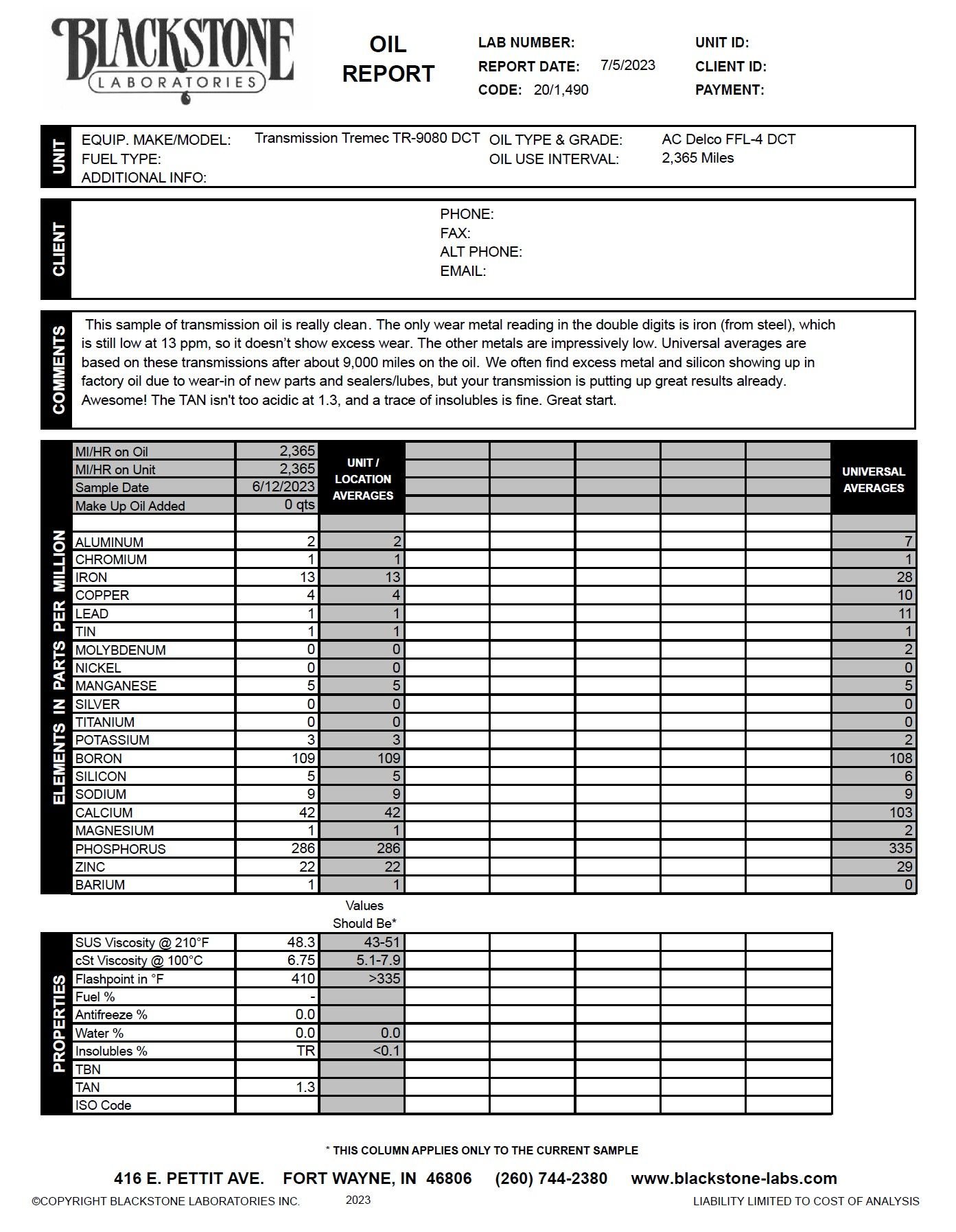

Old Jun 16, 2025 | 05:19 PM

The bulletin, which refers to the park lock sensor drift issue, shows that after a certain date, the bulletin does not apply. The die 3 change was introduced in late 2023 and all 2024 Stingrays. It would take a little more checking to confirm that the cutoff does coincide with the die 3 change. But would suggest that there is a change that may prevent the issue called park lock sensor drift.
The name tends to imply that this has something to do with actual unintended motion of the sensor or a communication error - and I think some posters even said that - nothing in the bulletin mentions anything about accumulation of metal particles on on the sensor, or the placement of shield to prevent that. As far as I know, the only source for that additional information was a technician that talks with the factory a lot and asks lots of question. I did not dispute that, and am not now disputing it. But it would be more interesting if we could see an image of that sensor and the shield that was added or a GM document discussing it.
Regardless of what factors contribute to the park lock sensor drift that is discussed by the bulletin, the cutoff date for the application of the bulletin tends to imply that change was made affecting the issue in the bulletin. If it does coincide with the date when the die 3 transmission was introduced in the 2023 models, it would strongly suggest that the change was included with the die 3 changes. And if that is true, it also seems to be at odds with GMs statements about it that said the alterations are unrelated to the reliability or durability of the transmission. It has been touted as primarily being a change to the case and pan to eliminate the need for the track fill, and a change to the cooling system - with very little other detail publicly shared.

Generally speaking, most good oil analysis methods will detect particles below 10 microns. This is well below the average micron rating of most oil filters. The point is - iron shown to be present in my DCT fluid will remain suspended in the oil until I drain it from the unit. In the meantime, it will be attracted to and build up on anything that is magnetic - just as it will on a magnet in the oil pan or on a magnetic drain plug. If components in the transmission are susceptible to failure from ferrous contamination, then there exists a built in failure that no filter can avert. In the case of the park pawl sensor, if a baffle can divert oil splash away from this sensor, that should increase it's longevity. A better solution would be to make components/sensors internal to the trans impervious to contamination from wear elements in the oil.

Iron (Fe) 22 ppm @ 6,433 miles, 1 external filter changed, before the service. Just looked up the trans fluid analysis report. Anyone else?

2365 miles. Filter changed once previously at 550 miles.

We know there are magnets in the pan, How does that factor in? I asked the company that also does my engine oil, about the filtermag units on my oil filter. He told me that was the first time anyone asked that question. His guess was the filter would have caught anything bigger than the 30 microns anyway. The outlines on the filter can was the consistency of Anti seize, and about that messy to get off your fingers. The outlines on the first 5 filter cans were very similar. Yes 5 engine oil changes in 7,653 miles.

Thanks for the UOA. I forgot to ask on the other thread……is the assumption that the wear metals in your UOA would become excessive if the GM 45K mile OCI was used?
Thats a-ok for my 2025 ERay, but there are 120,000+ MY2020-MY2023 C8’s out there the bulletin does apply to. GM’s vague language aside, three consecutive flush procedures (and in some cases more) to resolve DTC’s indicates a debris problem. Doesn’t matter the lawyers won’t allow it to be said directly.
In short - yes. Way before 45K miles.
The TR-9080 has proven to be susceptible to fluid contamination. In addition, the oil filter is too small and bypasses too easily. I perform all the routine maintenance on my car and it is all too easy for me to change the fluid and DCT filters, so why wouldn't I?
Next oil sample I send out will include a particle count which will give a more complete picture of what I'm looking at.
The concern is wear metals and nonmetallic debris coming from the both the input clutch assemblies and the eLSD clutch packs.
