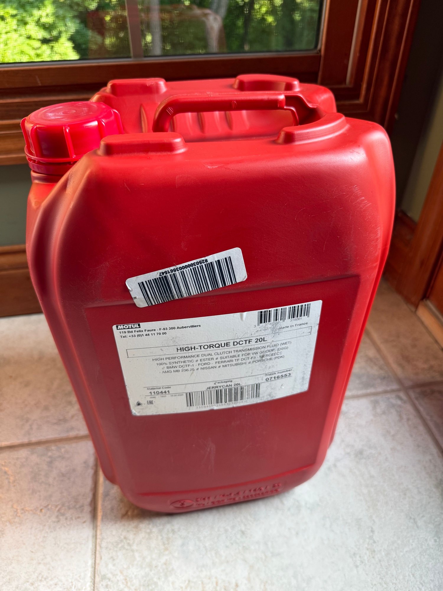

I decided to do the same.
UPS delivered a 20L jug on Friday from Ebay……$290 delivered to my door = $13.50/quart. Fresh - dated 2/25, and enough to do the initial change here in the next couple weeks + the yearly service this winter. By the third DCT service @ 7,500 miles, a UOA will have some insights.

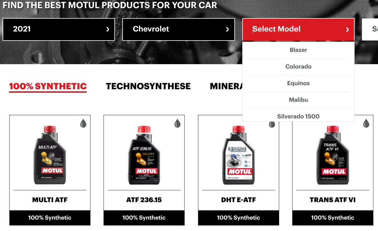

Originally Posted by gsvette
Wondering what you've done to get C8 products to list on Motul's website. I can't seem to get the car to pull up anywhere.
I did my last 2 (15,000 & 18,500 miles) DCT fluid change this winter and will continue to change yearly with my track mileage. I was going to switch to the Valvoline next time... but this is also interesting.
