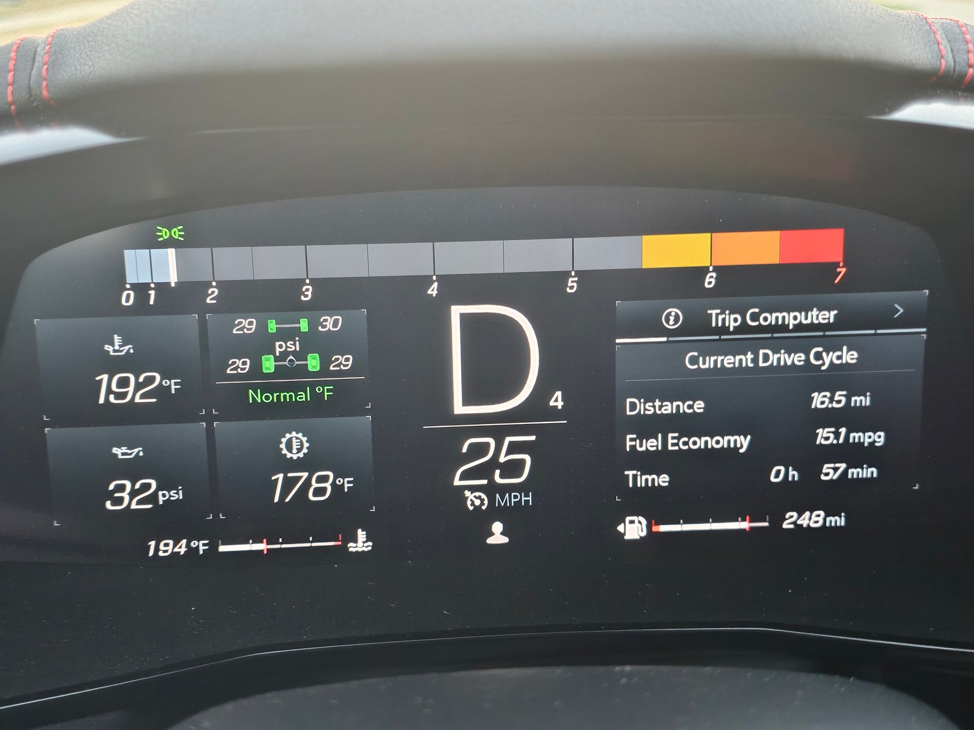

Here are my temps after driving in bumper to bumper rush hour on a 92 degree day.
*Edit* the car is a '21 z51.
