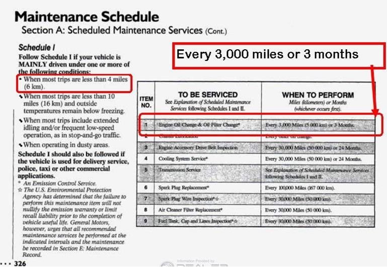

The pic below is from my 1993 Vette Owner's Manual. Particularly for "Garage Queens" who question why with low miles MUST I change in 12 months (which the OLM includes in it's algorithm.) The worst thing for an engine and oil is cold starts. If the engine oil does not get hot enough long enough to evaporate the water of combustion that passes the cold pistons it will form things like sulfuric acid that eats metal when the car is parked! The OLM actually monitors the oil temp after cold starts and if it does not get hot enough long enough will shorten the minimum 12 months to a lower number. Don't have to guess with milage!
Yep forget wondering why you change oil minimum 12 months in a "Garage Queen," the 1993 Owner's Manual BEFORE the very sophisticated OLM had to use foolish miles. So it states if most drives are less than 4 miles or most stop and go driving change oil EVERY 3000 MILES OR 3 MONTHS WHICHEVER OCCURS FORST!

Yep, to validate miles is a poor indicator, look at the Pic below from my 1993 Vette Owner's Manual before there was an OLM. Particularly important for those with "Garage Queens" who wonder why they are changing oil every 12 months when they ONLY drive ~1500 miles per year. IN FACT, they may have waited far too long at 1 year, should change every 3 months!
Note the 1993 Vette Owner's Manual (before the OLM) states if most drives are less than 4 miles, or mostly stop and go driving, change oil every 3000 miles OR 3 MONTHS WHICHEVER OCCURS FIRST!
This is the reason for the change every 3 months and why you must change minimum every 12 months under the best driving conditions. Cold starts are the worst thing for an engine and oil. The cold pistons shrink, and it takes several minutes for the ~2500F combustion temps to heat and expand. In that interim, combustion products pass the pistons. That puts water (main product of combustion) and some unburned fuel into the oil. IF the oil does not get hot enough long enough to evaporate the water, it forms things like Sulfuric Acid that eats metal when the car is parked. There are some other bad "stuff" but the Bottom Line you are changing oil NOT that it is worn out, IT'S BECAUSE OF CONTAIMINATION.
