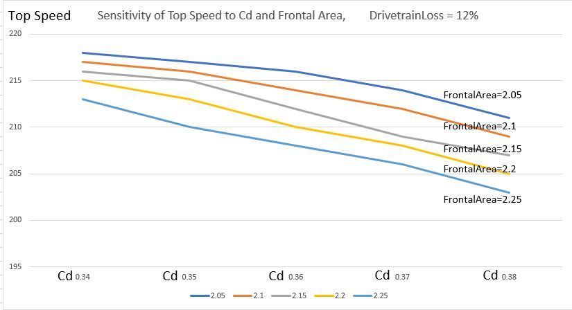

Thanks to Iker for starting the discussion; I just incorporated the RWHP data along with the 5-6 shift, and also ran a sensitivity analysis on the coefficient of drag and the frontal area. I used Iker's formula for Vmax as it's part of a well recognized textbook Vmax formula (the rest of the formula considers other parasitic losses).
Some notes; In my simulations the C8Z always attained top speed in 6th gear; the 5-6 shift was not a limitation, when I varied estimated shift points to hit 6th anywhere from 188 to 195mph.
In the top graph, where the lines intersect, is the Top Speed. The bottom graph shows the variation of this intersection as parameters are varied.
Also, this isn't necessarily an accurate prediction, this is just fun with math for now as it contains assumptions and error bands.

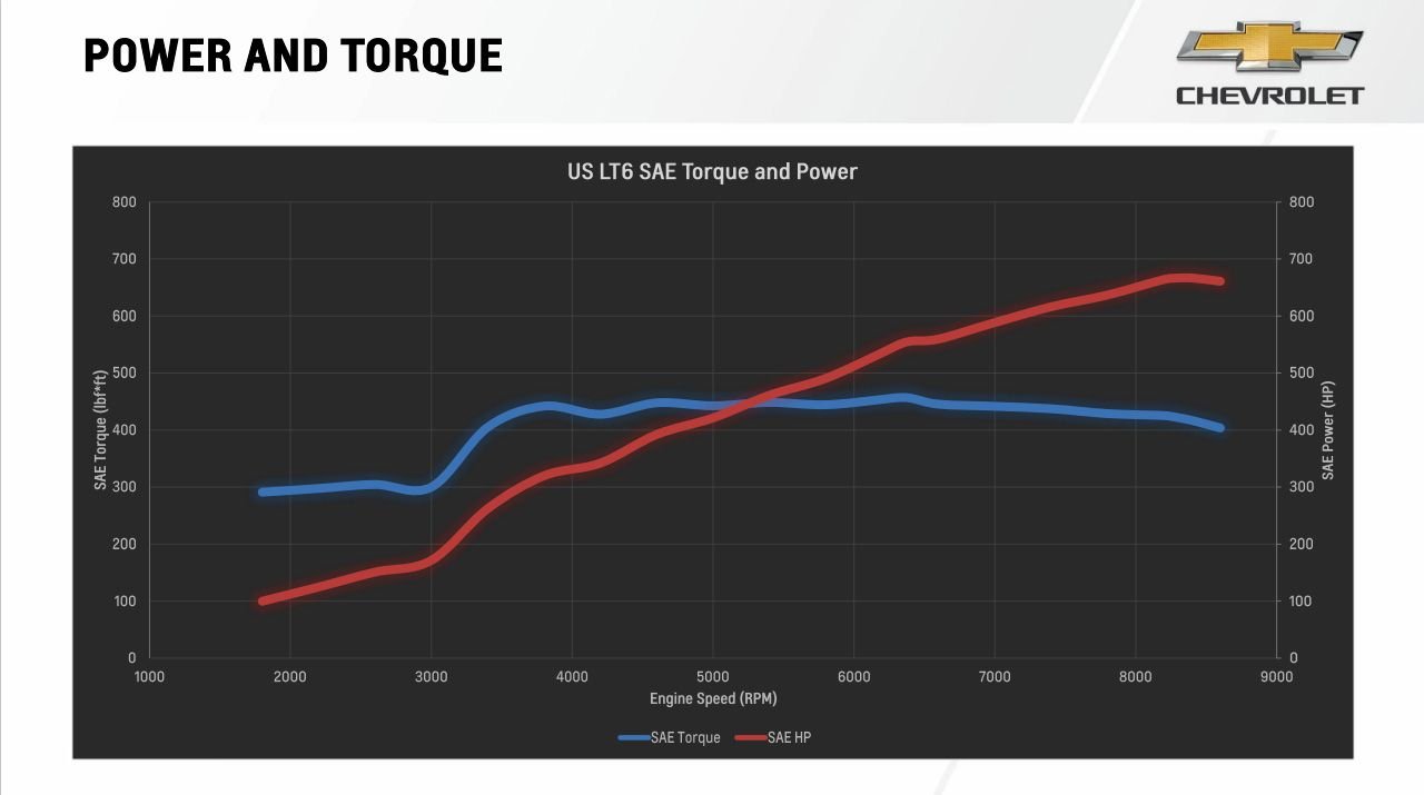

Of course, these equations assume the engine speed is at the horsepower peak, and that coincides with the top speed of the car. Based on the gear ratios published on another thread, that's not lining up with the speeds above. So the +/- 2 mph error band is way over optimistic.
However, let's keep working in it. Is there a horsepower curve published for the Z06 engine?
Old May 24, 2022 | 02:01 AM
Telepierre's Avatar
Telepierre
Joined: Oct 2009
Posts: 5,000
Likes: 2,261
[PIC] First Look at the Torque and Power of the 2023 Corvette Z06's LT6 V8 Engine - Corvette: Sales, News & Lifestyle (corvetteblogger.com)
To add to your great work above in an attempt to narrow the error band by getting the assumptions closer to reality, the number for RWHP needs some minor tweaking. Using a percentage of FWHP as a means to estimate RWHP is incorrect as there are exponential and constant sources of HP also. Using percentage only ignores both of them and implies the linear source is the only component of HP loss.
A more accurate way is to take the HP loss of a similar drivetrain like the base C8/Z51/LT2 and use the total HP loss with a few minor considerations, basically treat it as a constant loss plus or minus. Going through the C8 Tech forum, I found a post from a tuner stating he sees an average of 442 RWHP from the Z51 cars giving us a loss of 53 HP. The higher RPM of the LT6 will give more loss to churn/windage but not by a lot as the dry sump does its job. Another area is the sweep rate of the Dyno, the typical is 250 RPM/second which causes losses due to overcoming rotational inertia losses. While approaching top speed, the “sweep rate” is approaching zero also which means we can back out the HP loss due to rotational inertia. It’s not a lot to begin with due to the FPC of the LT6 and no driveshaft so I would call the small decrease a wash with the small increase in churn/windage.
Can you run the graphs again using 53 HP loss for a maximum of 617 RWHP? It looks like it may come out close to the OP calculated 208 MPH.

There goes the theory?
Flat plane 2023 Chevrolet Corvette Z06 revealed (sae.org)
Ready to rip, LT6 delivers remarkable 670 net (per SAE Standard J1349) horsepower at 8400 rpm. The redline is 8600 rpm, while the torque curve peaks with 460 lb-ft (623 Nm) at 6300 rpm. The super-short stroke minimizes the crank’s rotating inertia, expediting the rush to the redline. Though executive chief engineer Tadge Juechter insists Z06 is not a “numbers” car – its official GM-listed top speed is actually slightly slower than that of the conventional Stingray – he does tout a 2.6-second 0-60 mph time.
Edit: which means the cD/frontal area are magnitudes (non linear) above base C8.....?
Not necessarily, it appears from reading the article that Tadge was talking about the Z07 equipped Z06. There was an interview/reveal where a GM rep (can’t remember who) stated the regular Z06 will slot between the C7Z and C7ZR which puts it between 205 and 212…right where the above calculations show.
I think that article is assuming that the 186mph speed that is used to describe the cars downforce is the cars top speed. Back when that article was written there wasn't (and still isn't) and "GM-listed top speed." Sometime last year I remember a video where Tadge was asked about top speed and he simply said they didn't know the top speed yet. But I've watched so many random Z06 videos over the last 6 months that I can't remember which one it was.
5th at peak HP rpm is low 190s according to my estimated gearing, so that would match up for Z07 atleast.

Originally Posted by glass slipper
A more accurate way is to take the HP loss of a similar drivetrain like the base C8/Z51/LT2 and use the total HP loss with a few minor considerations, basically treat it as a constant loss plus or minus. Going through the C8 Tech forum, I found a post from a tuner stating he sees an average of 442 RWHP from the Z51 cars giving us a loss of 53 HP. The higher RPM of the LT6 will give more loss to churn/windage but not by a lot as the dry sump does its job. Another area is the sweep rate of the Dyno, the typical is 250 RPM/second which causes losses due to overcoming rotational inertia losses. While approaching top speed, the “sweep rate” is approaching zero .......
All good points, sweep rate makes a difference - the vacuum pump and isolated block bays in this engine are a step above previous Chevys as well. I think the 617hp would be an upper limit -
corrected a typo as well, frontal area in the graph was 2.2 and not 2.25. One takeaway here is that we're really sensitive to area and drag coeff when counting MPH's, small changes make large differences. If you move the 5-6 shift to the low-mid 190's to account for any error in tire diameter I may have, the top speed difference isn't dramatically different, there may be a MPH or so here.
To Top speed.. let’s do some math
It is clear how tiny change in the numbers lead to a big difference in the results. Sure accurate numbers are needed for better results.
Do you have any idea how can we calculate the acceleration time from 0-186 mph and 1/4 mile trap speed for the base car?
Thanks for the update, looks like about 209 MPH.
I agree, 617 HP would be an upper limit. If pressed for a guess on RWHP, I would say 612 +/- 5 HP corrected to SAE on a DynoJet with smoothing 5.
