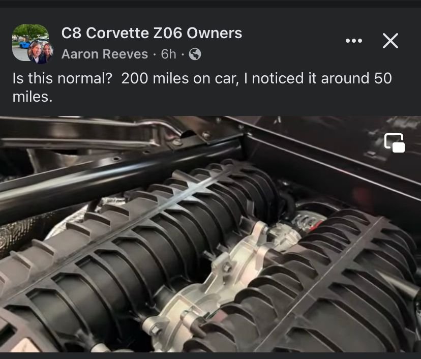

Originally Posted by RapidC84B
Video on FB group showing a prominent ticking that isn’t injector.
https://www.facebook.com/groups/9810...ibextid=ykz3hl
It's definitely not normal, but it is not completely continuous. Might be something very minor (like a loose butterfly valve), or more sinister. We don't know how it changes with temperature or higher rpms. It's a task for the Chevrolet service technician to find out.
