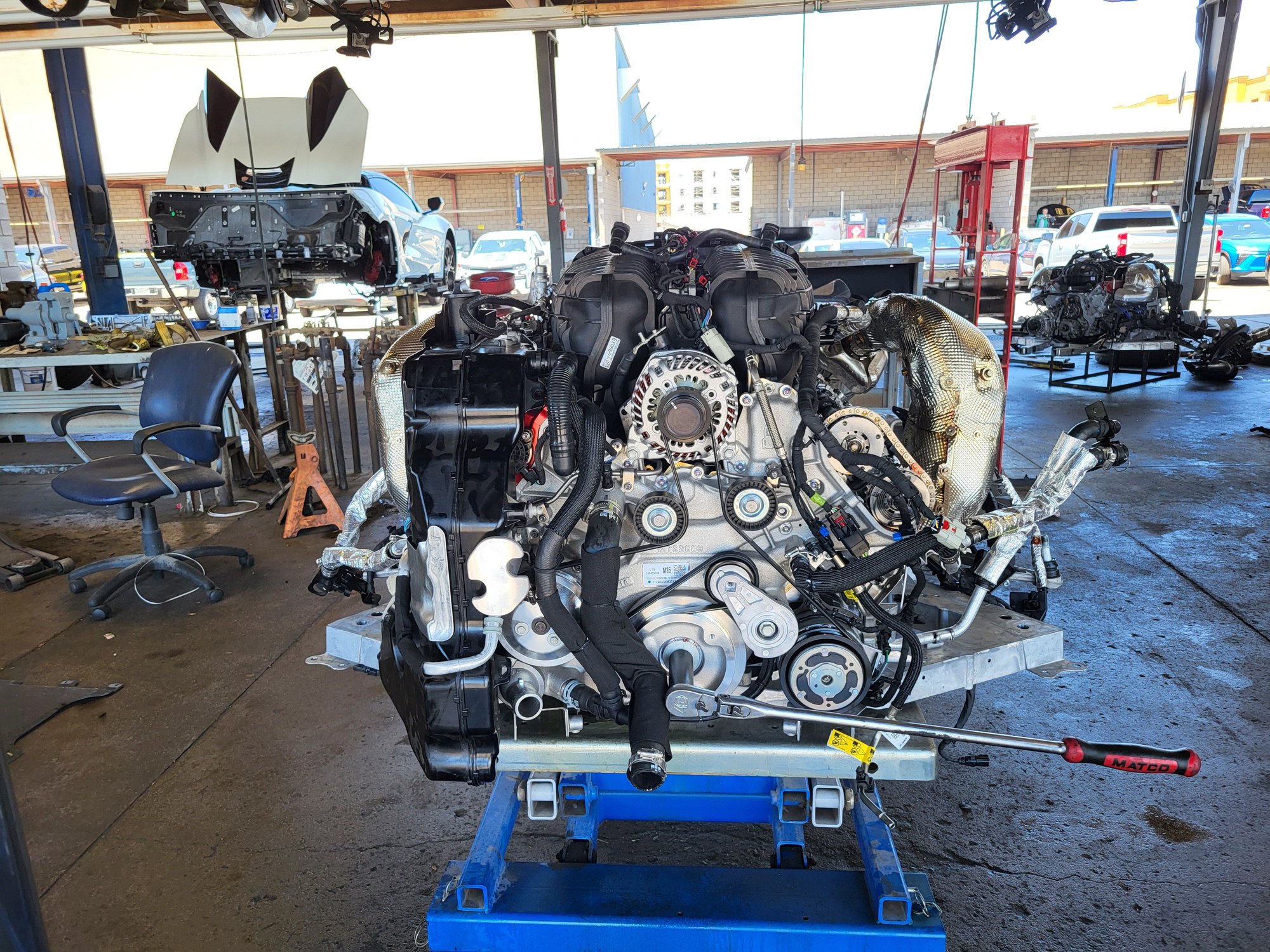

Update on my ticking Z......
Talked to the Service Writer early last week and he said the parts were on order and in transit, once the parts got here they could schedule the car for work.
"Any idea when the parts would get here?"
"I can't speak for Fed X. They don't work for me,"
"Can you call me when they'll get here? When you start on the car? I want to see it."
"I can call you. but I can't let you go back there. Insurance won't let us".
"That was never an issue before with my other Z or with my truck....."
"I don't make the rules. We can't take you back there."
This is a short tape of how the conversation went, y'all can imagine how it transpired, but you get the idea. "Customer Service" just doesn't seem to be a part of the overall culture with this dealer since they changed ownership a few years ago.
Anyway, I called yesterday, couldn't get the Service Writer on the phone so I left a message. Crickets.
Called again today, couldn't get the Service Writer on the phone again, left a message. Went to lunch with friends. Went and picked up some welding gas. Crickets.
I'd already made up my mind to stop by the dealer after getting the gas. So, I did. Got there just after 1PM. Went looking for the Service Dude, poked around in a few of the offices since there was no receptionist arround, and talked to a couple guys in one of the offices. Said I was looking for Joseph.
"He's at lunch. Be back in about an hour."
"I'm trying to find out the status on my Z06."
"Is it a Black one?"
"Yeah. Been trying to get the status on the car, nobody will talk to me."
"Want to see it?"
"Well, yeah...... that'd be cool...."

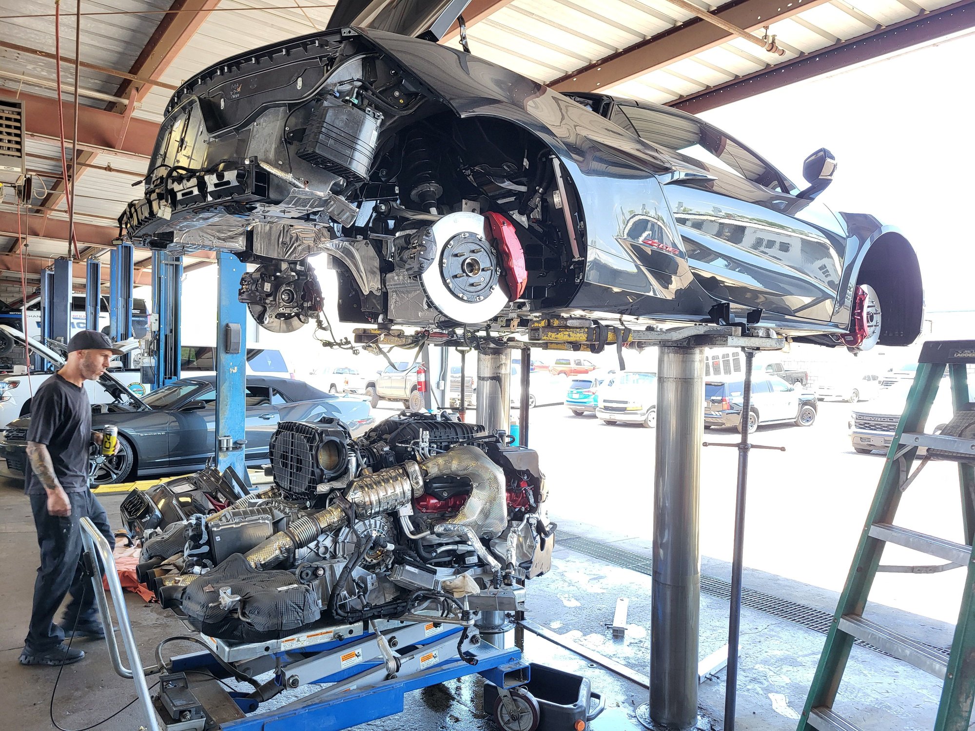

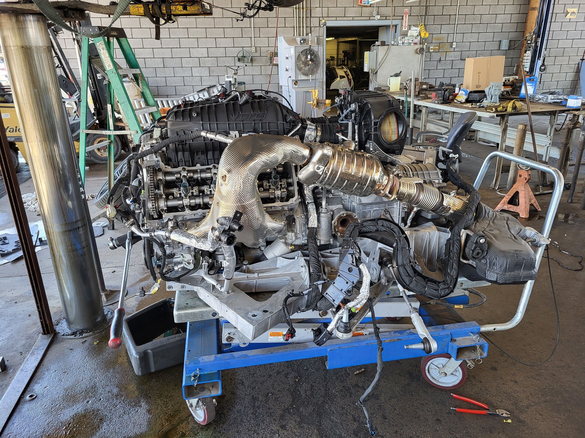

So it turns out I stumbled on the technician that's working on my car and he walked me back to see it.
The guy in the hat ain't the tech working on my car.
The technician was very friendly, easy to talk to, knew his s***, and very forthcoming with information and answers to my questions. He said that he'd already done the "fix" on the driver side, but felt he needed to do both sides while he was at it; it'd be crazy not to and maybe later have to drop everything out again. He had more parts on order, he hoped they'd be in tomorrow and if they are, he'd try to get it done by the end of the week or early next. I told him I was going to ask about that, and thanked him profusely several times. Then he left me alone to walk around the car and take a bunch of pictures. Good thing the Insurance company didn't have someone hanging around.....

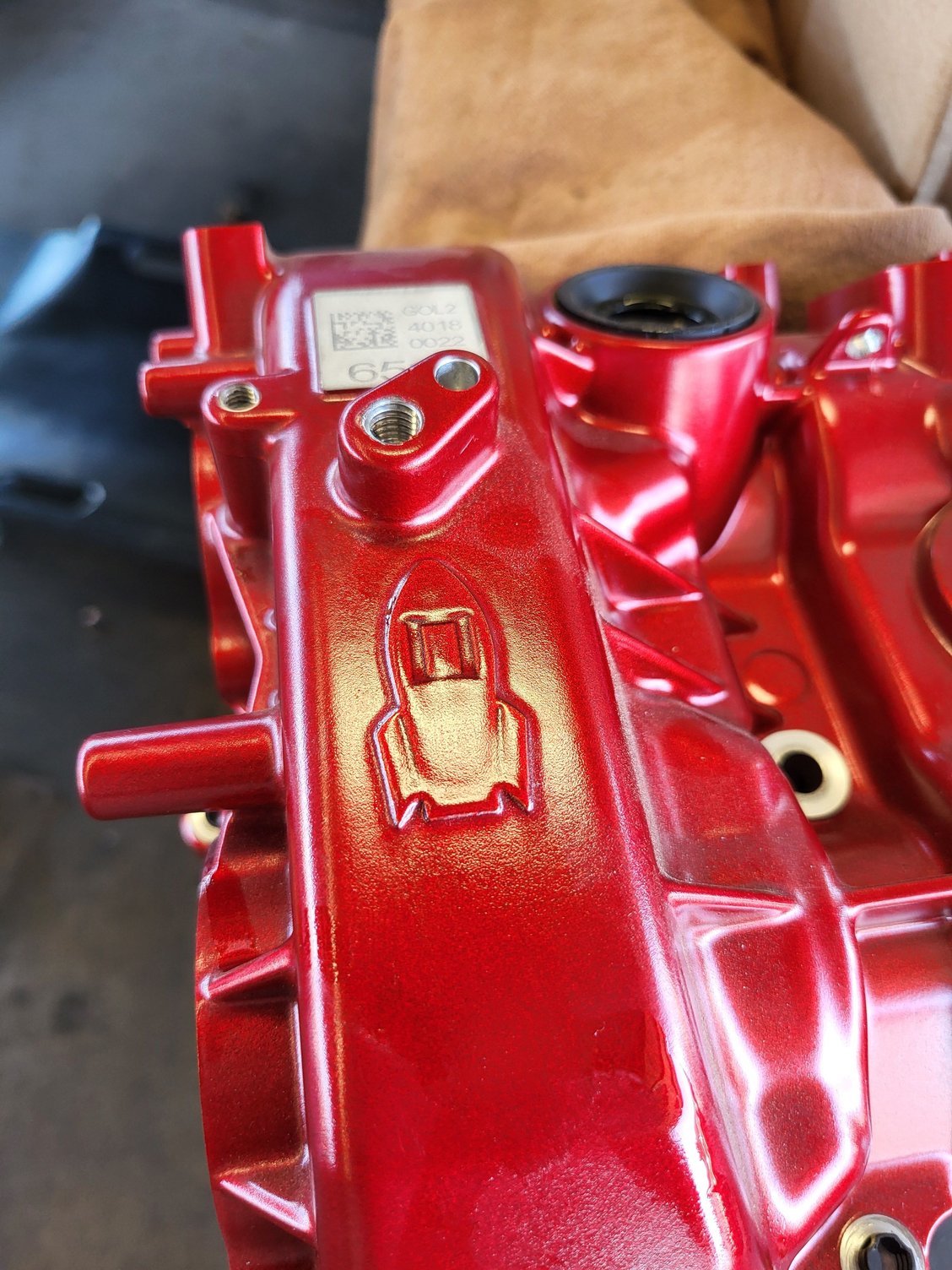

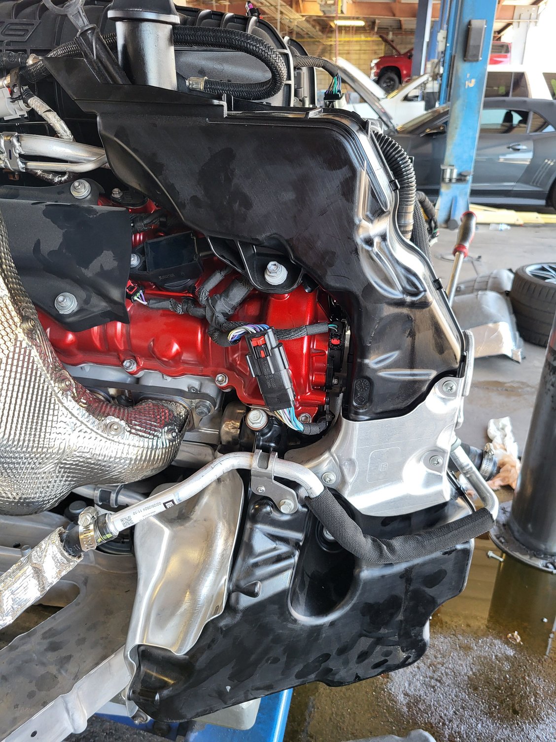

The fix:
See those two bolts holding the top of the cam journals? Those bolts come out, clean things up and inspect, and re-install torquing to spec. That's it. That's the fix. You'll note there's no adjustment on the cam followers, nothing else they can do to address the ticking. Also note the little rocket figure on the journal caps. That's not an arrow, it's a little rocket. That cute little stylized rocket appears all over the engine in various places.

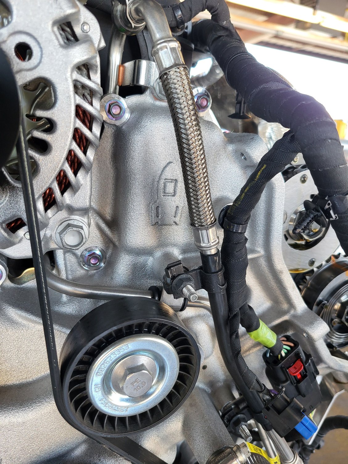

Couple more pics:
Front cover rocket ^
Dry sump Oil tank - all that black plastic is the tank
Cam cover Rocket

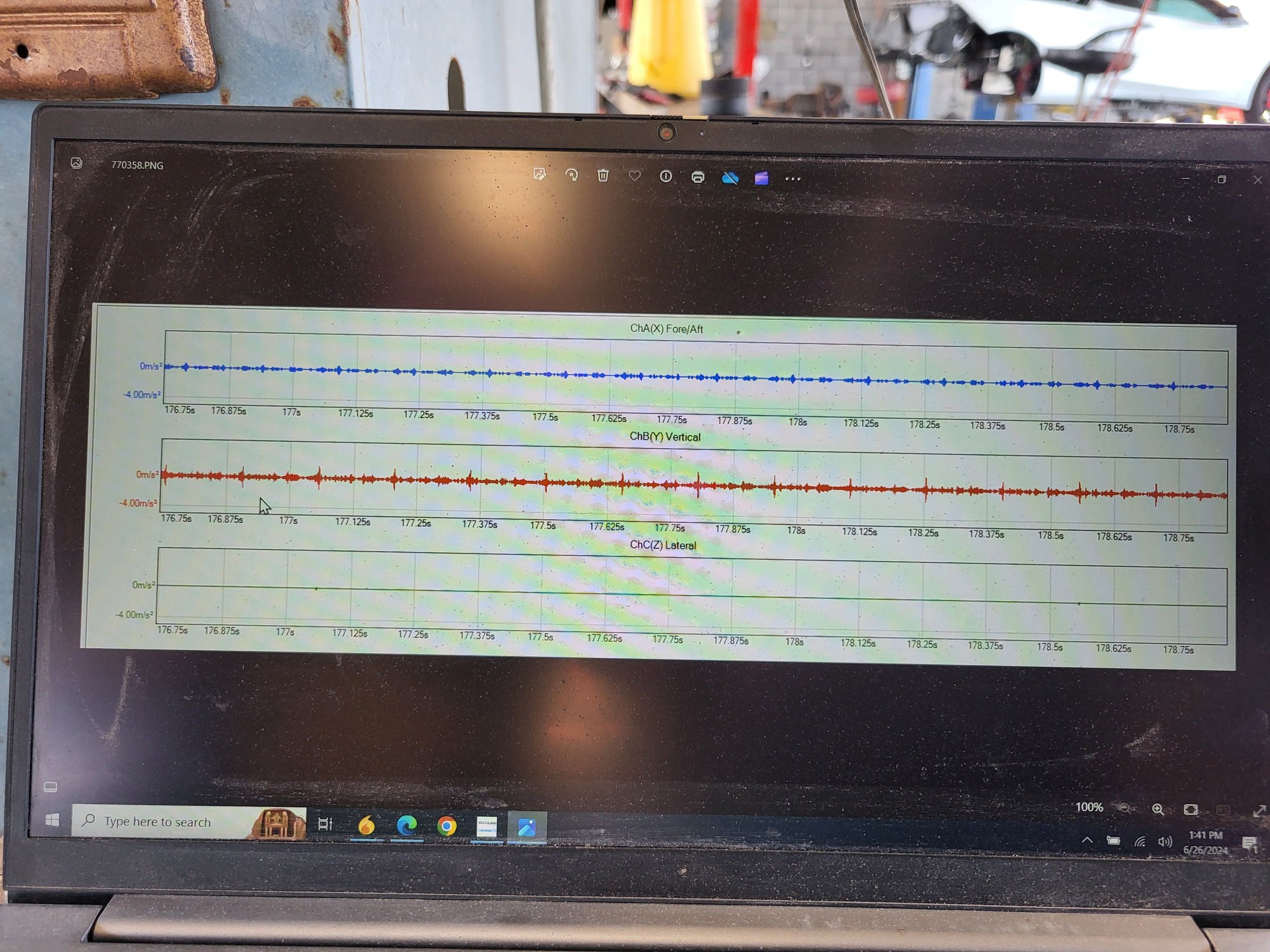

Pico scan example. See those red "peaks"? TSB says to compare those to example in the TSB to identify the source of the ticking. They "match"...
OK, this has gone on long enough for now. Hope to get the car back no later than early next week. I liked the technician. He promised the car would back together so I'll never know it'd been apart. I told him "I Like that kind of talk." Fist bump.
I'll spare y'all the conversation I had with the Service Writer who finally called after I left the dealer. Let's just say I (politely and professionally) let him know that it's kinda disappointing when the Service Writer gets and update on the status of a customer's car - from the customer. Instead of the other way around.
