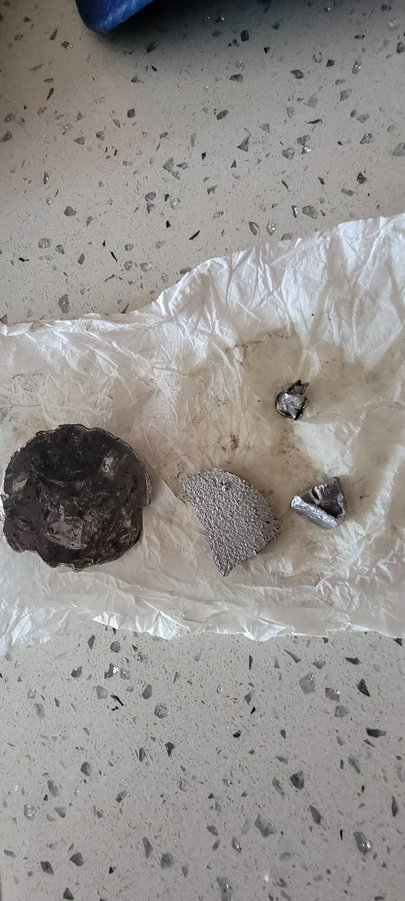

Unfortunately, my 24 Z06 just blew up at 30 days of ownership and 829 miles after being cautiously broken in. I was 240 miles from home and cruising at around 40mph in 4th when it happened without any warning! I was stranded in a puddle of oil with a chewed up intake valve and shiny little pieces of engine block to stare at! Just unfrekkinbelievable!
Got Onstar at least To send a tow truck, but the driver had to go back because he did not have the proper wheel dollies. And then we had a hell of a time getting it onto the flatbed since the wheel Dolly's were slightly too wide for the flat bed. A real nightmare story.
Next I had to get it towed to a certified Corvette Dealer in the area which turned out to be a very small rural dealer with virtually no Z06 experience. I was told to immediately contact GM customer care and open up a case file. GM tech has confirmed a total failure of the left cylinder head involving at least 3 valves, but they haven't torn it down yet. And since then I have asked if I can have the vehicle repurchased or replaced but I'm told not until the California lemon law applies. The engine and parts on backorder without any sort of eta plus I haven't authorized repairs yet until I find out if GM will tow it to a local dealer or it will cost me out of pocket in case it gets repaired in less than 30 days which I doubt is possible, but who really knows?
So my dilemma is to try and get it moved to an experienced/preferred local dealer so I can monitor repairs closely and in case they fix it in less than 30 days and I am stuck with it? Otherwise after 30 days I will hopefully be making 🍋 ade and get all of my investment/add ons back so I can start all over....makes me 😫 having to contemplate this inexcusable situation that GM puts it's customer in‼️

Really sorry to hear it. While it sucks to wait, I wouldn’t worry about whether it will meet lemon. 8 months and counting here - GM still can’t figure out what’s wrong with mine. The engine replacement took almost 3 months, transmission cooler took another 2 months, new transmission took another 2 months, and the last month was spent scratching their heads and GM delaying looking at it again because the new transmission is still overheating.
Either I’m the minority and GM doesn’t care (certainly feels that way), or there are way more issues than we know about and they’re working a big backlog.
Either way, the chance of a new engine within a month is not very likely from my experience, but maybe you’ll get lucky.

That really, really sucks. Nothing worse than getting a brand new beautiful / expensive car and have it go boom.
Essentially they have 30 days to get a new engine installed and back to you or they have to re-purchase the vehicle. If it were me, I would be praying they don't get it back to me in time.
However, if they do, then you should negotiate some compensation (cash, extended B2B warranty, etc) for the fact that the vehicle will have diminished value because of the replaced engine.
Cal Law
The problem first occurred within 18 months of delivery or 18,000 miles (whichever comes first);If required by the warranty or owner’s manual, you notified the manufacturer about the problem; and
  • You have taken the vehicle in for repair by the manufacturer or its agents:
    • Four or more times for the same problem and it still is not fixed, or
    • Two or more times for the same problem, if that problem is big enough to cause death or serious injury, and it still is not fixed, or
    • The vehicle has been out of service for repair for more than 30 days (the 30 days do not need to be in a row).
