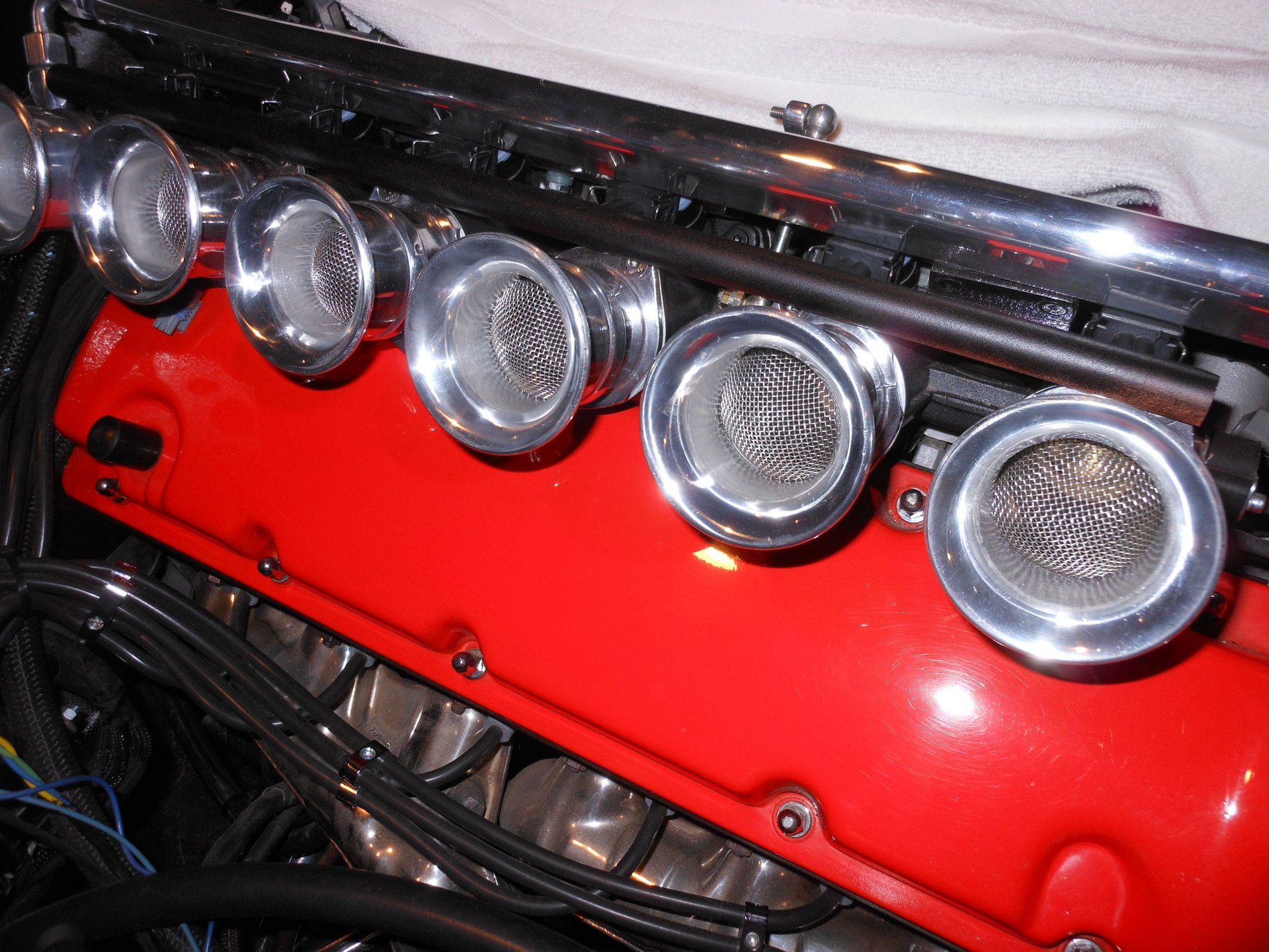

Mines sort of a Frankenstein C3...
A BMW all aluminum V12 modded with a 3 stage dry sump to fit the frame.
I fabbed up a custom intake and run Jenvey ITBs
Got rid of the twin distributors and running 12 LS coils
Using Megasquirt MS3 Pro ECU
Custom bellhousing and hydraulic clutch - BMW flywheel with a Chevy clutch connected to a Tremec 5 speed.
Suspension- Vansteel coilovers all the way around

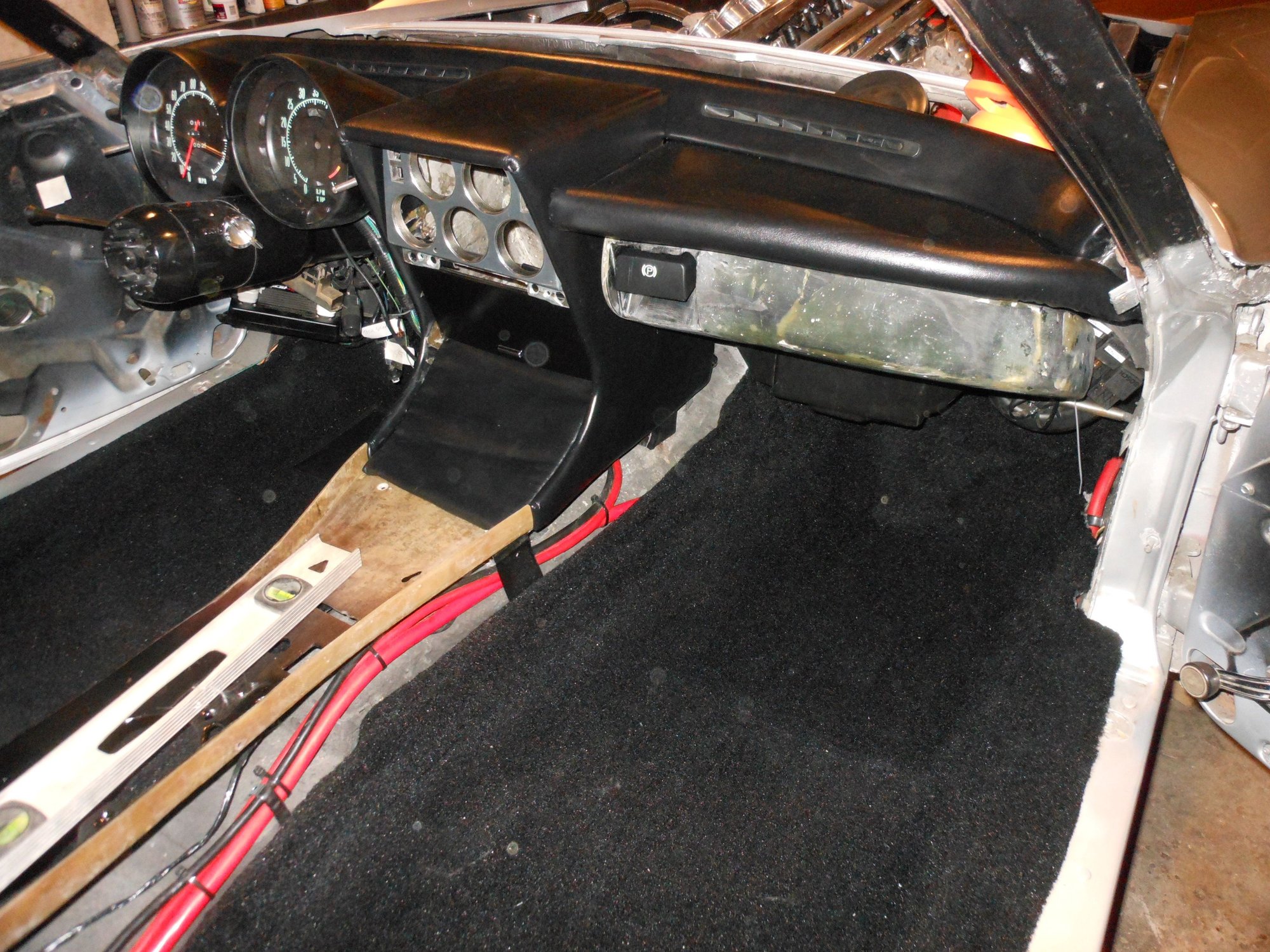

As far as the interior- I sort of went
"period correct" and copied a late 60's Lamborghini Miura.
Here's my build- I've been messing with it for years and hope to finish it up for next summer!!!
https://www.corvetteforum.com/forums...vette-v12.html
My interior mock-up
What a real Lambo looks like-
