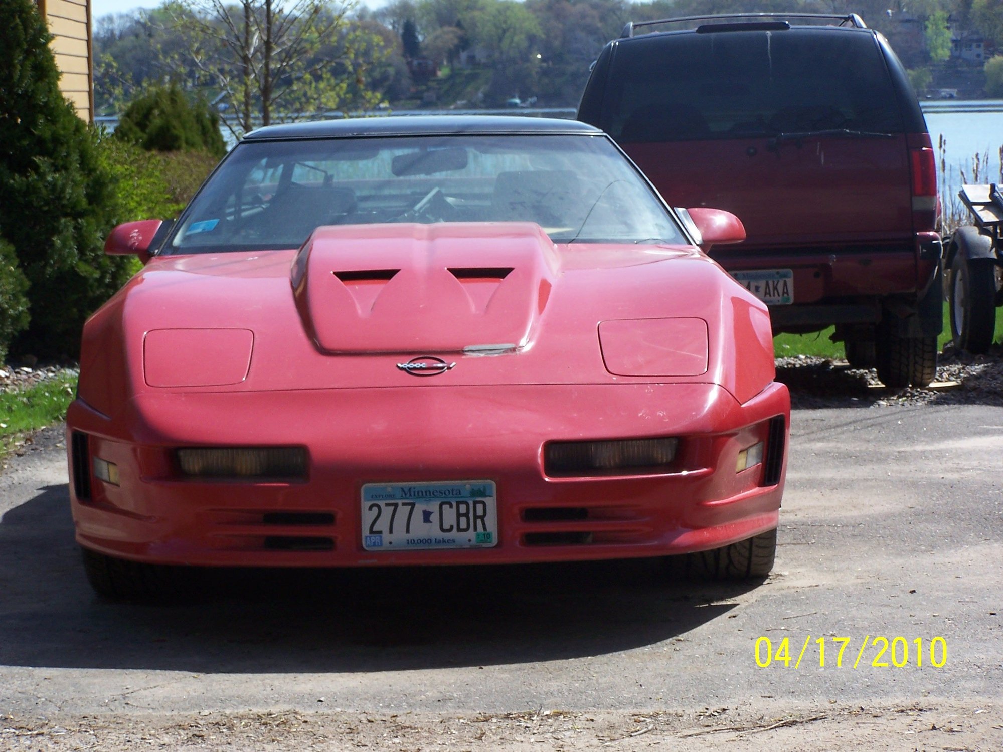

I’m going to prep for 89 coupe for paint this winter but I’m not sure what I should use to repair the hood.
It has a 4” cowl added that is cracked pretty much all the way around. It’s a little hard to see in the pictures. I was told by someone to use 3m panel bound would this work or is there something else I should use? There is also a fairly deep gouge about 7 inches round that needs to be filled. Looks someone may have set down a grinder on it before it was turned off.

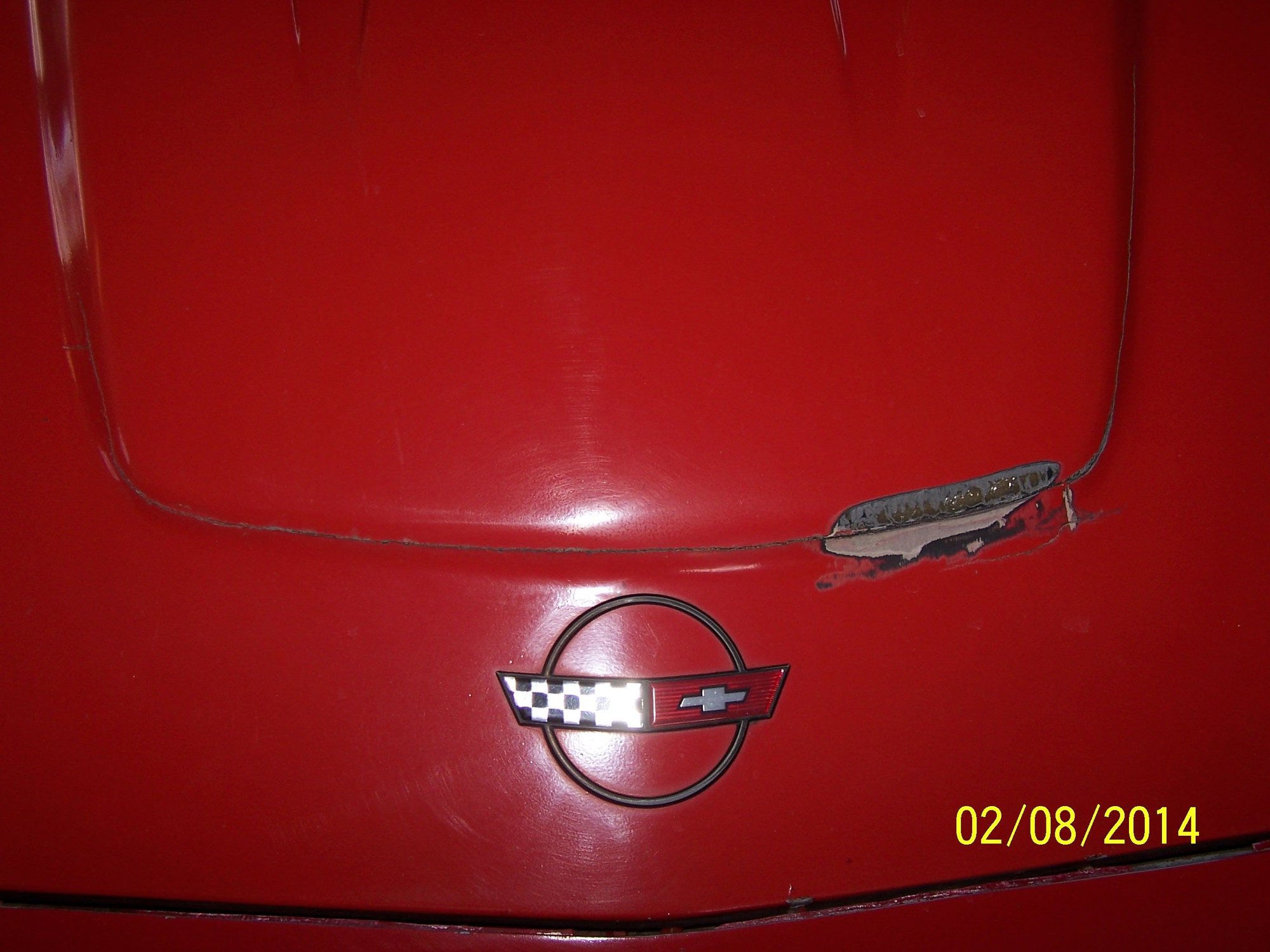

Need more photos of the damage and what the underside of the hood looks like. I assume that the hood scoop is bonded on. Is it bonded or bolted in place????
Need a decent close up of the damaged area on the hood.
The repair procedure is depending on what was used to do this hood scoop.

It's hard to tell how this was attached. I assume it is just bonded with bondo and I don't see any bolts on the underside. The hood was cut open when I got the car, someone must have thought it would make a functioning scoop? But it was convenient for me to put the HSR on.
I had the brand name of the cowl at one time when I found it and the stalker noise cone on a website but am unable to find it again. It may have given an idea how they are attached?
I was able to easily pick a chunk off with my fingers seen in the second picture. I thought the crack went all the way around but its just in the front and a few places on the sides. If the pictures are any help what would be the best way to tackle this? Also is it a lot more work to change the color? I will be painting the entire car either way, the paint looks like a Maaco job. Not terrible but I'm sure I could do better even though I have painted a car in 40+ years. LOL

Found the website for the cowl it is from ACI (American Custom Industries). It's the Vader scoop.

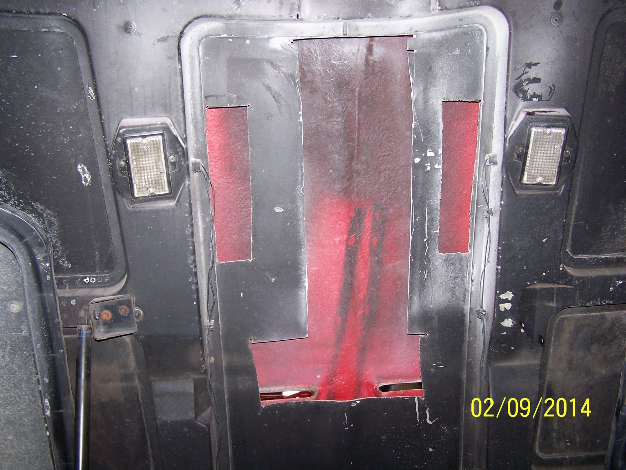

Here's a picture of the butchered underside. I was able to put my hand inside and felt a lip that apparently sets on top the hood. I assume there is panel bond between the lip and hood to adhere it to the hood and just bondo on the outside. There are also two bolts (not pictured) in the rear that appear to be going into the cowl.
Can the cutout area be removed entirely to clean it up? It doesn't look like it would do much structurally at least the way it is now?

WHAT A FUSTER CLUCK !!!! For what it is worth...I have dealt with bogus installations like this.
A lot depends on what was used to bond this scoop on...and if the inside is cut out further...it could possibly weaken it a bit more. Hard to say.
Which is why the material used to bond it on is important and hopefully it will stay put. I guess when a good visual inspection of the bonding material can be seen...then the choice will be up to you on what you may wan to do with it.
With the material popping off like in your one photo....that is NOT a good sign. That is kinda telling me we have a moisture issue.
