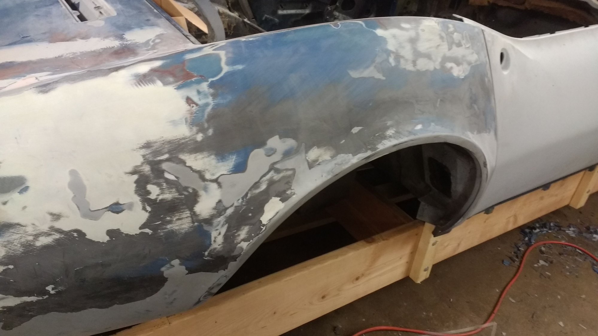

Default Glue Smell
The predominant white area to the left is what produced the smell while sanding.

Thanks for the photo...
Seeing how I was also waiting your response to my question in post #22. All I can do is guess.
It looks like a body filler or a primer...hard to tell from the photo. Just make sure you use proper breathing protection.
It can possibly be a glazing putty. Either way...you know it has to come off so it won't matter when the smoke clears.

I wonder if it is some type of polyester primer. That would fit. Powders away but hard to take off.

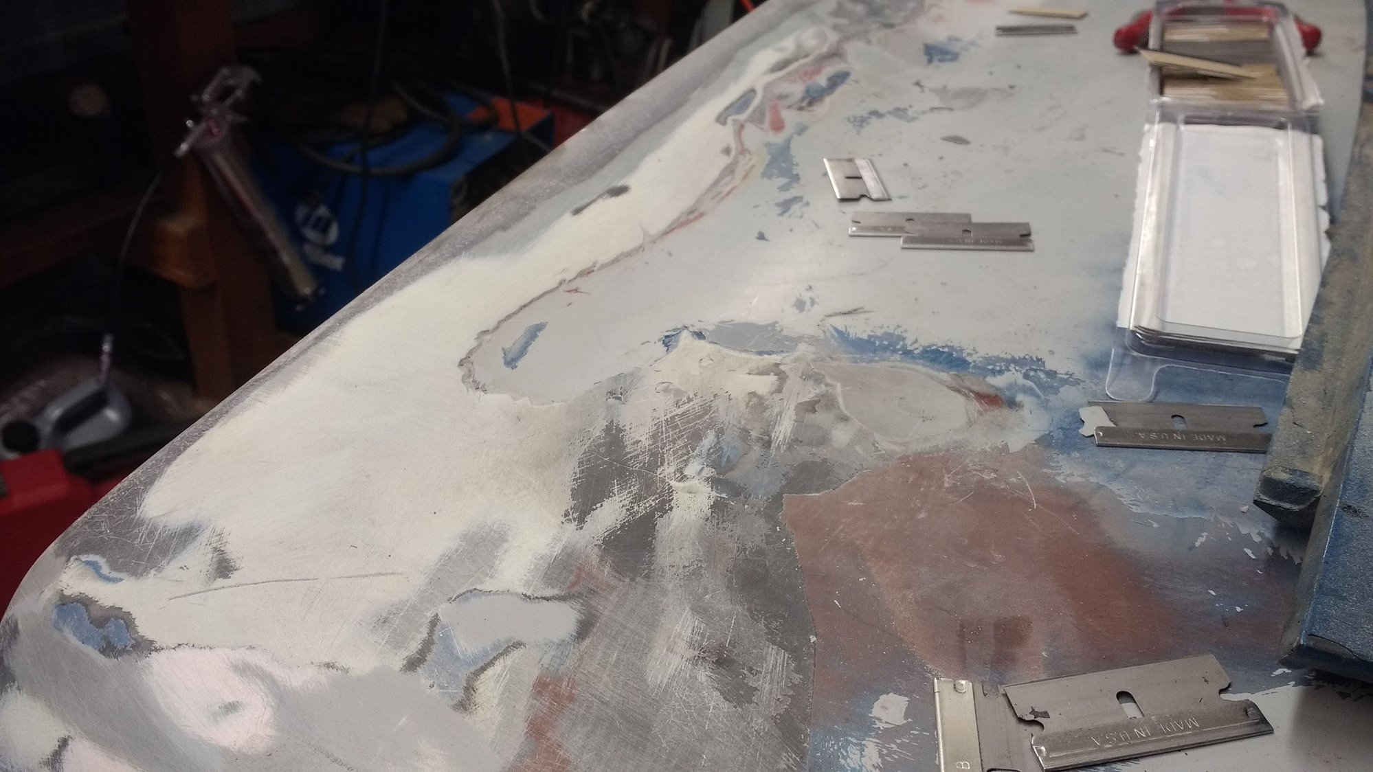

Default Guess the product
I'm finally getting some real time to scrape the paint and other terribleness off this car. I got to the front knows where I soon we'd have some issues. And as I predicted there's definitely some mystery product in the front. When I heated it up with the gun and became very malleable and peeled up really easy Once the blade got under it. So let's play the game. What product is this? Either way I'm pretty certain it has no place on my car.

Follow-up question. A heat gun shouldn't Delaminate a previous repair if it was done somewhat correctly, right?
It has nothing to do with a previous repair that failed...this is fresh delamination that was self inflicted ...and I can tell by how good the fibers look ...they glisten. MAN...I think you are getting it way too hot and you are going too deep with the razor blade.
I hope you realize and understand that using the razor blade method of removing stuff off the panel is to get some of it off ...and not so much being able to perfectly strip it to the factory fiberglass. You can actually do MORE HARM to the panel using the heat gun than if you sand it off by hand.... knowing you are not going to use chemical.
When you see you are going into the fibers and gouging it ..STOP.
DUB
I will be more careful. I'm trying to stop short of the primer two allow me to send it or whatever after the fact. But when I get to these parts where it's been worked on there's a whole lot of putty or something and I get at the putty and it gets soft and the fibers seem to go with it.
Only commenting in the manner I am so you do not create MORE problems.. I would HATE to see you have a major 'cluster' going on there.
Then...if you come to previous body work or putty STOP. Sand it off. Kinda like your gas pedal in your car...you do not drive around in town with it matted to the floor all the time. You gotta know when to 'lift' or stop.
AND...just becasue 'porchdog', others and myself say that using a razor blade will work. Often times we have hundreds of hours of experience to know when to stop.
Like I wrote before..I use a razor blade but rarely use heat because the amount of heat is touchy...or your get what you have.....delamination.
DUB
Understandable. I appreciate you trying to keep me from Causing more problems. Is there a way to tell what's a good repair and what's a battery pair? Or should I leave that to the body guy that I'm taking it to the determine?
Basically I'm just trying to keep the car from being painted with bad work underneath.
There is no way to tell if a repair is GOOD or BAD 100%...so...common sense is to remove it and repair it again so YOU know it is correct.

way too much heat. paint will come off easy just by warming it. primer or filler will not separate . anyplace porous will not release. go around those spots. you are working with a badly bastardized body . your going to have to do way more sanding because of how much primer and filler was dumped on it. it takes very little heat to soften old paint .
peel strips off . do not go straight on. start a line and take 1/4 in to blade width strips off .
