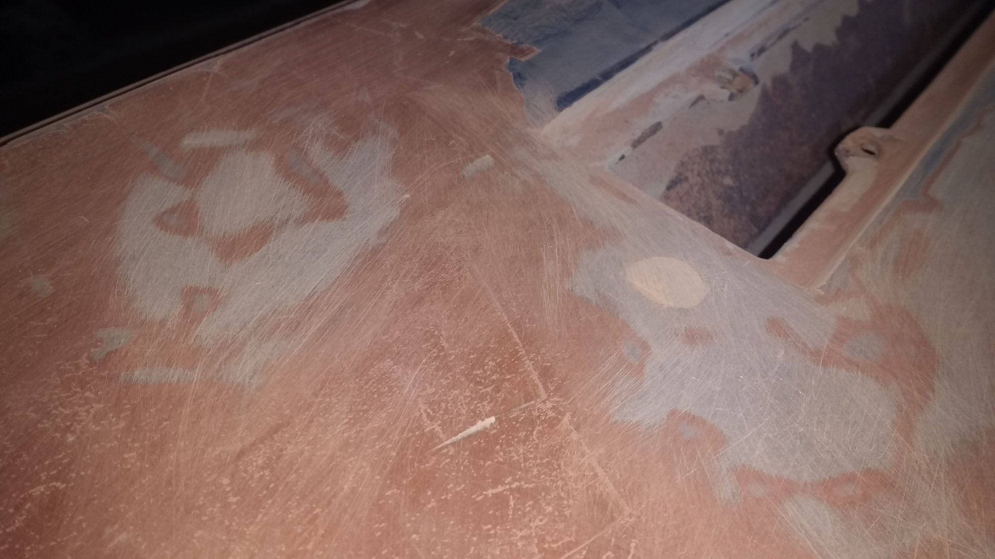

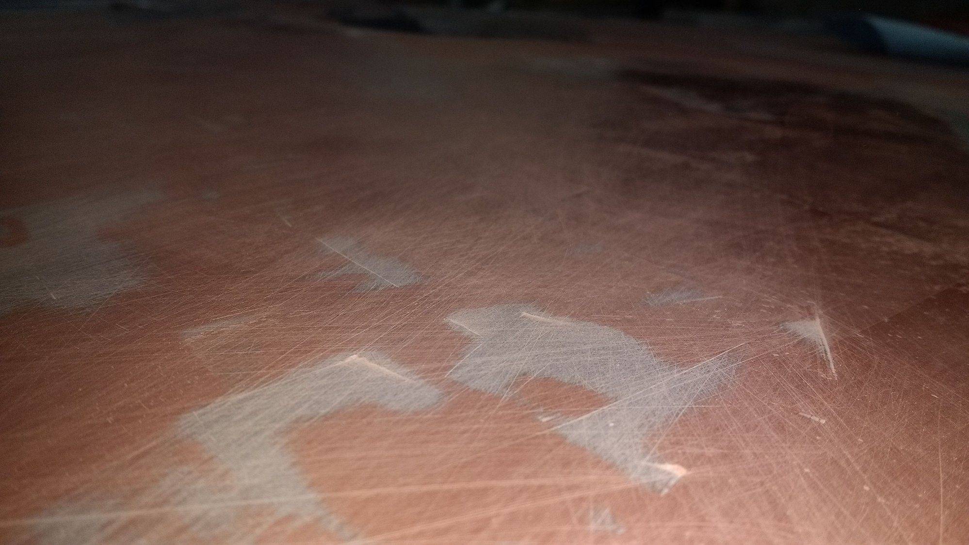

Here's another location I worked on with a similar method. I was using the heat gun to get the paint soft and I was able to scrape it down to the red oxide. I stay away from a couple work on areas as well. I figured this would be a good location to check to see if I was really goobering panels up and possibly delaminating them all together.
So I went to investigate further. I started sanding leftover blue paint mainly around the worked on areas. I sanded with 120.
These are smaller repairs but are at best just spots filled with filler. I'll leave those for body guy to handle. The fiberglass itself looks ok here but I guess it began the question. If it looks ok, could I have still done some long term damage?
I knew while blading I had gouged here and there. I can run my hand over it and feel em. Above is a picture of some of my more glaring missteps . If I read correctly in the past this is a fill with VPA situation right?
I appreciate the concern and direction. I do honestly want to do things right. If I need to just sand to keep things safe that's what I'll do. As always any review and feedback is appreciated

YES...the VPA is what you can use to fix any surface problems.
I know you know you are in for a lot of effort to get the paint off this. I wish your wife would reconsider allowing oyu to use the chemical...it will save you a butt-load of time.

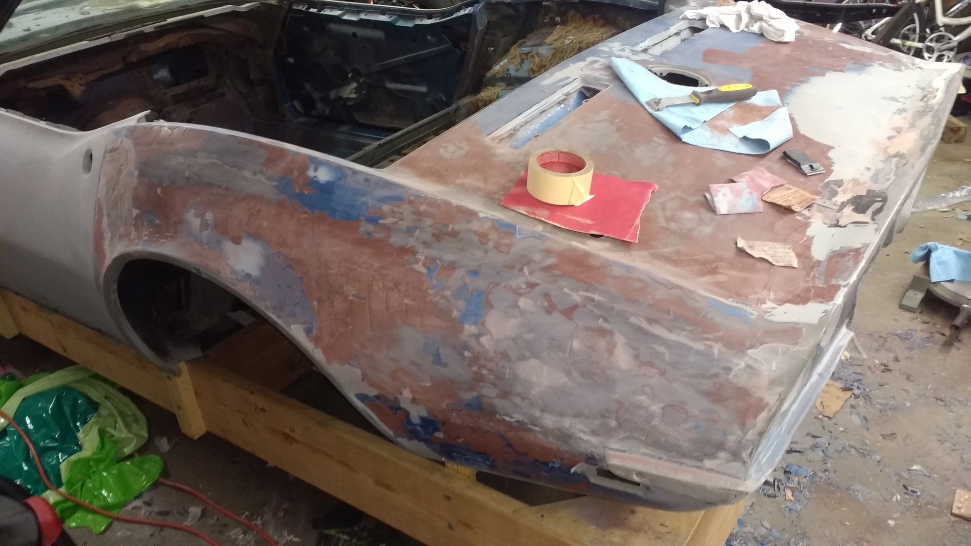

As far as that back panel does it look like I have any delaminating issues or would there even be a way to tell?
I am lost...you need to be more specific. You need to point to the area of concern when taking the photo IF you have a concern.

My apologies. Earlier you were saying you were concerned that I was using too much heat and potentially delaminating a lot of the areas I was working on. I think you were basing it off of that one area that had the gnarly crack underneath the "repaired" body work.
I just wanted to make sure that I didn't do any further damage and that's why I gave a picture of the back panel up to the point that I had it or was mostly free of any primer. On that panel itself there's not really any real problematic delamination issues that a guy could see correct?

It is hard to say IF you did any damage due to excessive heat with the heat gun.
Back in the day... I screwed up some areas on one due to not paying attention and I cooked the fiberglass and it showed up later in the body when I put it outside in the sun and applied heat from my infra-red heater.
So...by your photos..I cannot say with 100% certainty that you are good or not. It looks good....but so did the areas I screwed up.

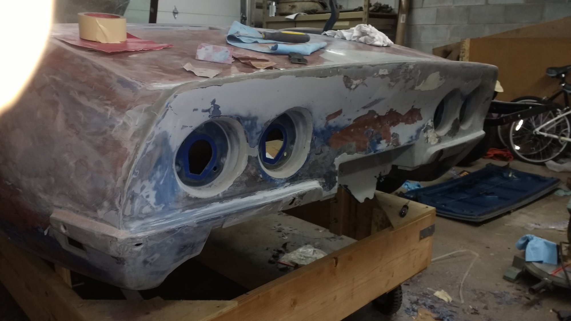

Here's an update. It really doesn't feel like much of one due to slow progress. It seems like any direction I work in the back is filler. A lot of cracks under the filler. To my untrained eye only a few repairs attempted to use fiberglass techniques to mend.
My new consternation it's centered around the tail light panel up to the deck. In the second to last picture you can see a parrallel cut above the tail light that runs through the center of the upper deck.
​​​​​​I think someone cut that and pushed it up. I couldn't tell you why it her than to maybe make it easier to contour their repair above? I dunno. I still need to settle down and let my body guy look at it. But I'm starting to think it's new quarters and a tail light panel at least.

Not that you asked and I will let you know this. Knowing that you do not do this stuff for a living...I know from at least the photos you posted on the rear taillight panel...I WOULD NOT replace it. It is reparable.
I have worked on and repaired some that makes this one look perfect.
If you look at you last photo...you can see the bonding strip..and how the mat and resin someone applied is ON the bonding strip...and above it and what is below it looks like they were just messy. So..that is why I feel the taillight panel is OK. The damage is above the bonding strip....and you do not want to replace that panel.
And seeing how I do this stuff...prepping the inside of this damaged are is NOT a big deal...especially with you having it on a body...heck...that makes it MUCH easier.
Laminating the mat and resin on the inside will provide the strength/reinforcement..and then what is done on the exterior is more for the shape and contours.
As for your quarters...do not freak out about them because I have also stripped paint off of Corvettes that had a butt-load of crappy filler in the and when I ground them down..they were not that bad and actually the bodyman who applied the body filler went hog crazy and did not need to apply what they did and as much as they did.
And hopefully this comment possibly helps you possibly feel better and not seem so overwhelmed...When I look at what you have going on....I have not even raised an eyebrow yet. Meaning..I have seen it before and it is not that bad to someone who deals with it. And TRUST ME..if I see something that is going to be a ROYAL PAIN to repair..I would let you know.
NOW...if you and your bodyman want to rip off the rear clip and put new panels or a full rear clip...that is your choice but that is NOT going to be easy either.
