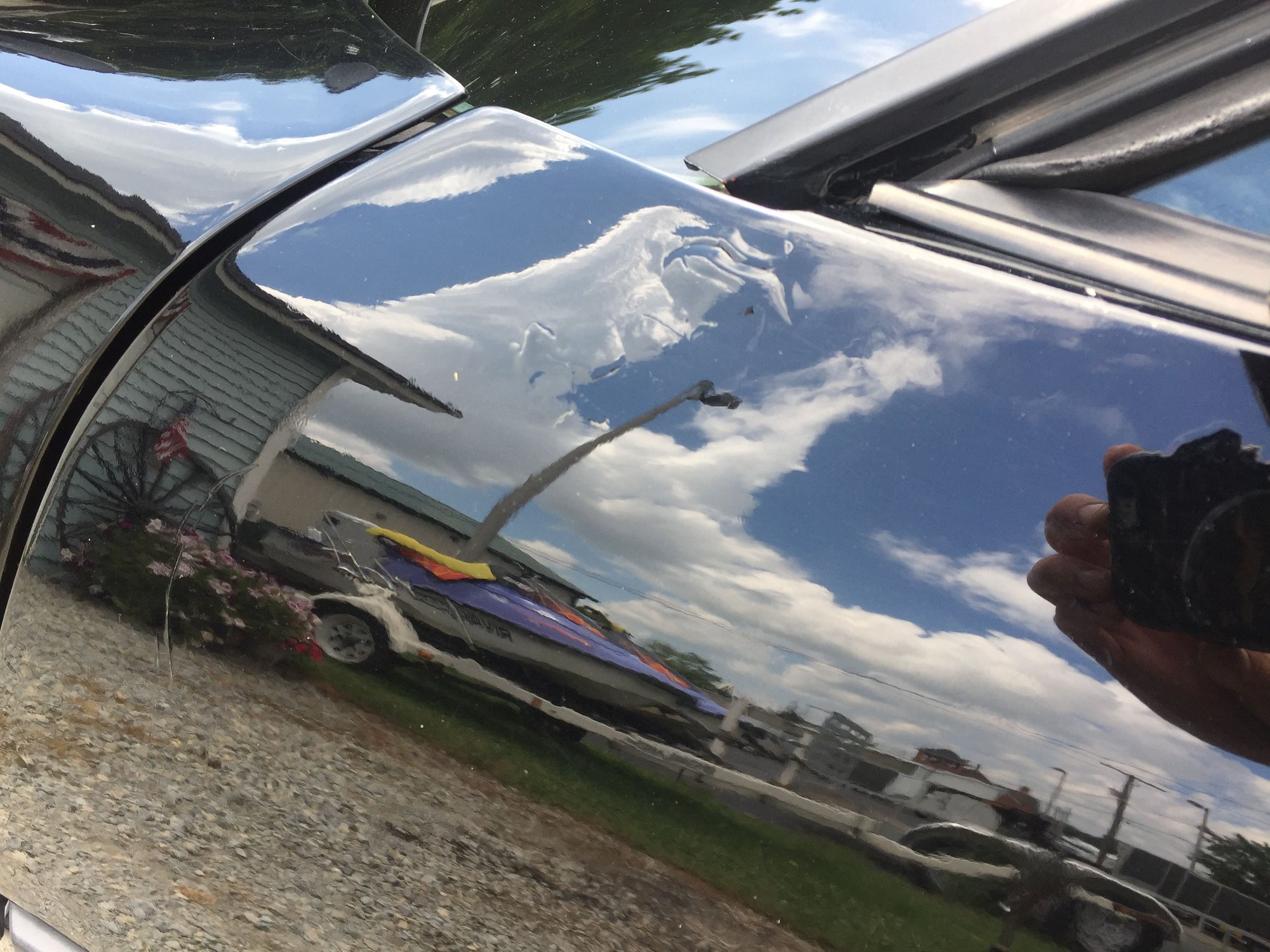

Here is some pictures of the messed up spots on it. I don’t notice any spots that should need body work, just chipped places where the paint came off.

That blistering is not a good sign and may cause you to take the paint all the way off and still possibly have a problem in the paint job due to contamination of the SMC in those areas.
I am guessing you are going to remove all the paint.??? Getting it down to raw SMC.

Yes, I’m going to remove all of the paint. There is a lot of areas where the paint has chipped all the way down so I filled them with some black touch up paint just for now to make it look a little better and protect it but I don’t see how there is a way you could get all of it smooth without removing it all. Plus I have heard that it makes for a better finish after everything is done when all of the paint is removed. I know it has been repainted but I don’t know if the person before removed all the paint when they did it because i can’t see any layers when you look in between where it has chipped away so that makes me think they may have removed the paint when they did it.
