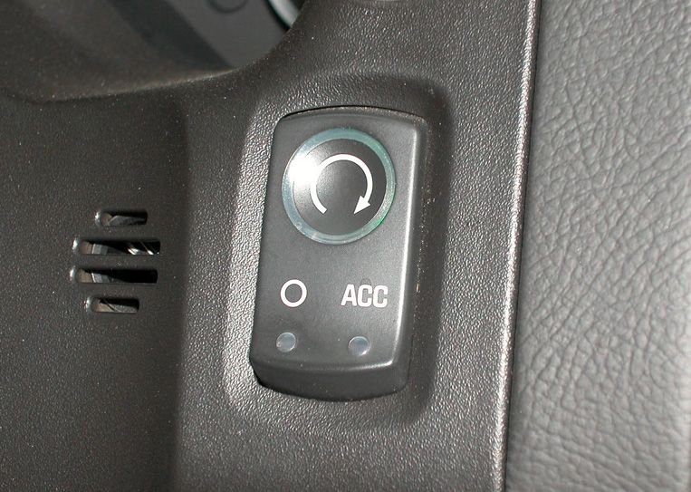

Step 1 – Push the "ON" button without starting the car
Turn the key to the accessory position or press the "ON" button without stepping on the brake pedal, but do not start the car.
Figure 1. Location of "ON" button.

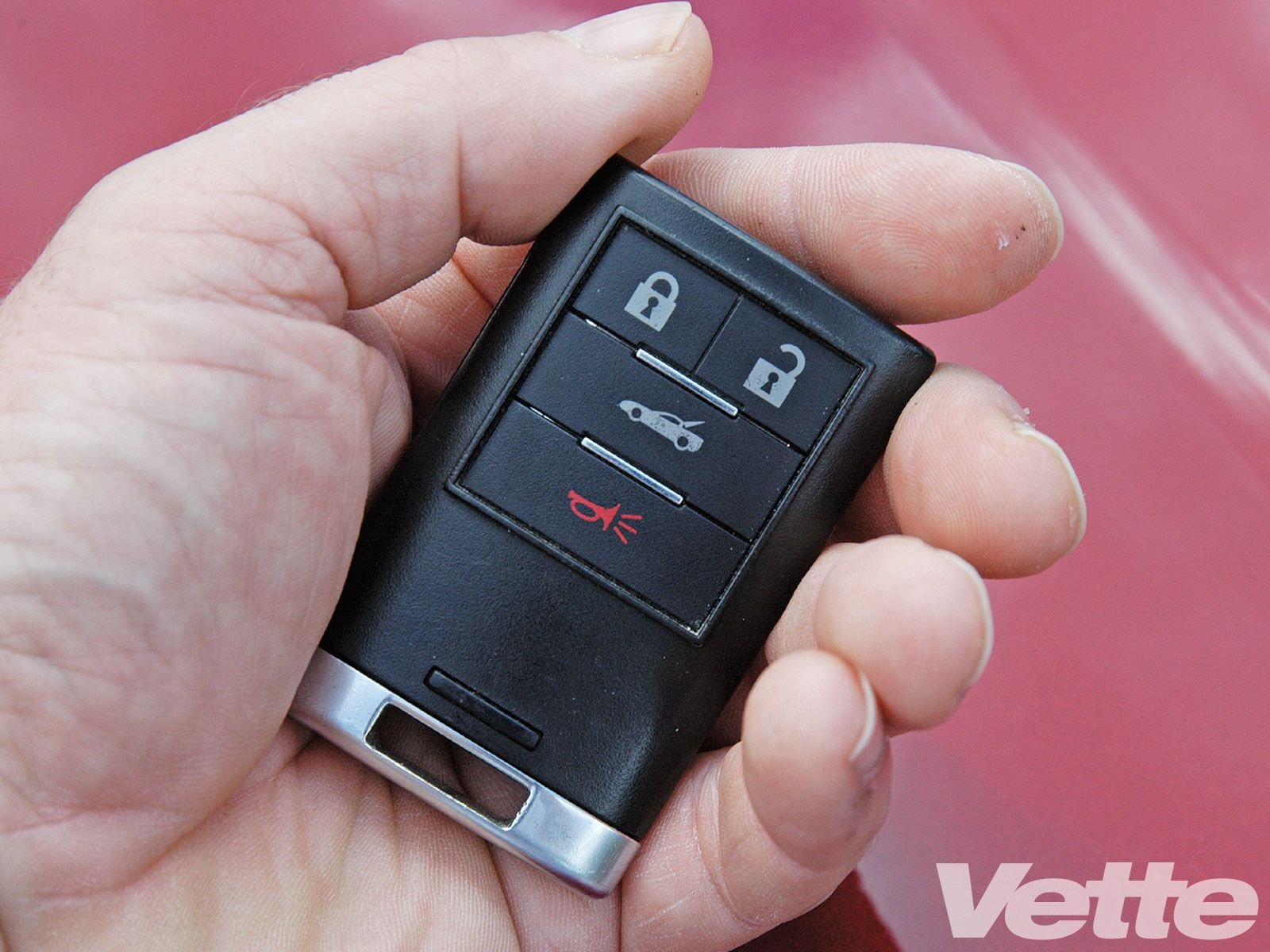

Step 2 – Utilize the key fob
With the key fob in hand, press and hold the lock and unlock buttons simultaneously. After a few seconds you should hear a small beep from the car horn, letting you know that the TPMS system is ready to be reset.

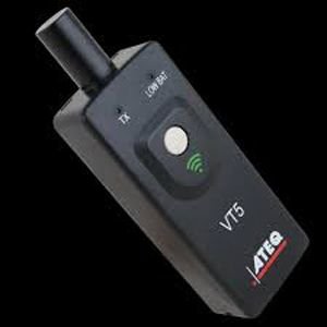

Step 3 – Use the TPMS reset tool on each wheel
The tires should be reset in the following sequence: left front wheel, right front wheel, right rear wheel, then left rear wheel. Press the learn button or similar button on the tool as directed by the instructions, and waive the TPMS tool around the valve stem of the left front wheel. Within 3 to 4 seconds, you should hear a beep from the car horn notifying you that the TPMS has been reset for that wheel. After resetting the left rear wheel, you should hear a double beep from the car horn, which will notify you that the TPMS reset is complete for the vehicle.
  • Figure 3. TPMS reset tool.

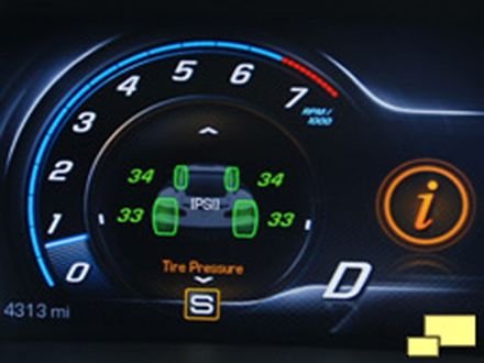

Step 4 – Double check the PSI readings
After completing the reset process, you may want to check the PSI readings on your Corvette's information screen to ensure that the current pressure readings are within manufacturer specifications.
Figure 5. Be sure to check for good PSI readings on the dash.
