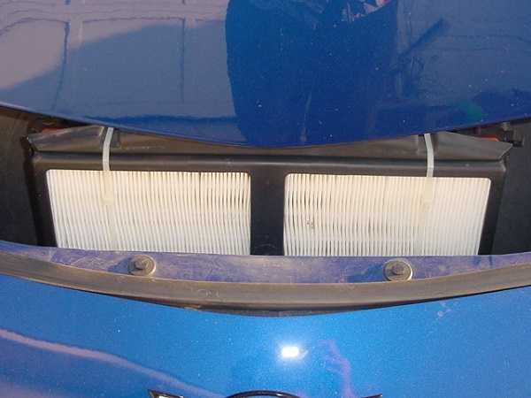

Daisy chain 3-4 Zip Ties to make one long one that will reach around entire lower airbox, filter, and filter cage. Make two.
c5intake1
c5intake2c5intake3c5intake4c5intake5
Tighten zips as tight as you can get them.
Reinstall, don’t forget to tighten hose clamp at throttle body.

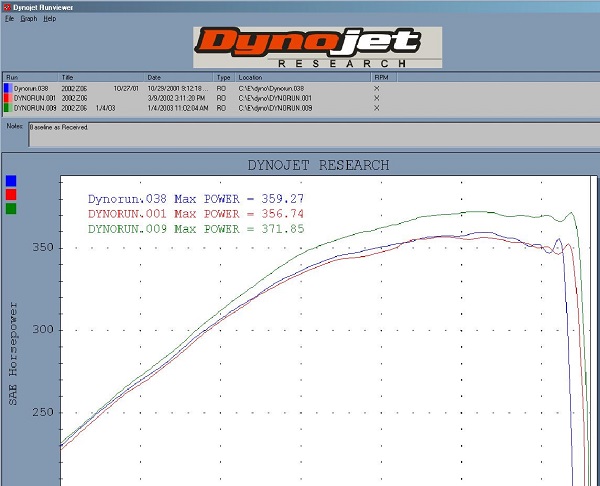

Here are before and after dyno charts for HP and Torque
