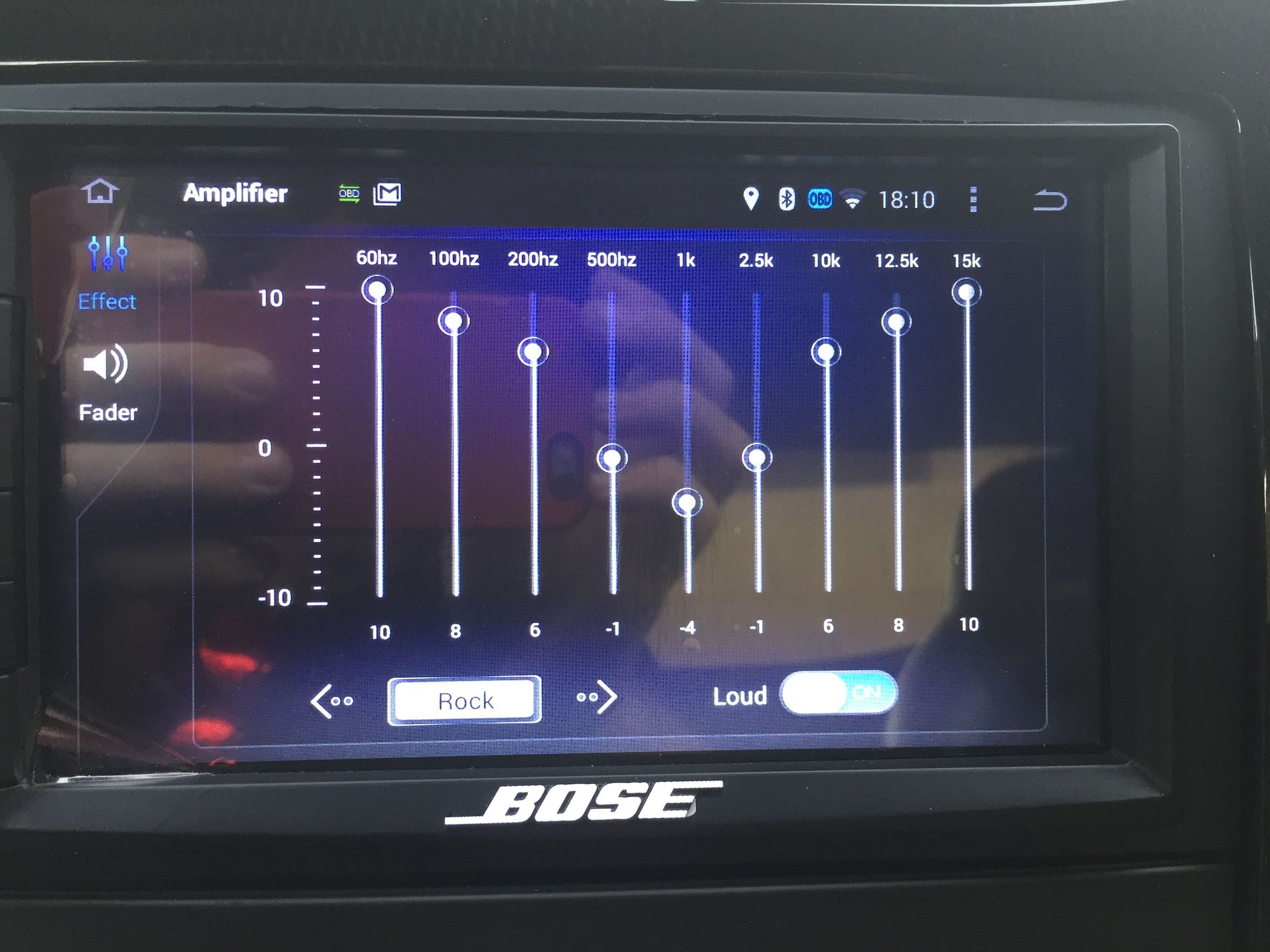

Originally Posted by Nathan1234
As far as equalization, yes, I would agree... that should be very easy to implement on any android device. Somebody would just have to make a quality app. But it is my understanding that there is separate hardware controlling the outputs. I think the others would have to be more proprietary things that could not be simply implemented through an app unless it was created by the manufacturer or 3rd party for a specific device.
I can probably live without time correction, but having crossover control is probably a requirement for me. If there is no control available on yours, would you happen to know the default frequencies and slope for the main outputs and sub? Thanks.
I believe I can help with some of this. You are correct that sound from the built in amp does not go through the OS. The builtin apps simply control the amp. I discovered this when I downloaded an audio visualization app and it did not work with the radio tuner. I would assume that this would be the same case for the auxiliary input. Not sure about bluetooth streaming from your phone, but I would think that that does go through the OS. Based on this logic, you could set your amp to flat and then install any equalizer that you want, but it would only work with sources within the OS(Pandora, Spotify, downloaded music, etc.)
Something interesting about sound quality to keep in mind... I have one of these in my 2009 c6z non-bose w/ onstar and a similar one in my 2014 Silverado non-bose w/ onstar. Both of my vehicles are using an entirely stock sound system other than the HU. I am very happy with the sound that I get and it has plenty on range to give me the rumble I want on the low end. My business partner and I just put one of these HUs in his 2016 Wrangler and the sound quality was terrible. I am by no means an audiophile and based on your specific questions I am going to assume that you are much more discerning than I am. That said, there was just no low frequency sound in his Jeep. We even swapped our HUs and the problem stayed with the Jeep. We tried running the stock speakers off of the RCA outputs and a 4ch amp but that did not help. We ended up having to install a small subwoofer to get the low range back into his system. I am still not sure what cause all of these issues, but I am inclined to believe that the Jeep had some sort of factory amp that was not turning on to drive the factory woofers.
tl;dr: These sound great in multiple generations of GM vehicles, but may have sound issues in Chrysler products.
as for your questions about default frequencies and slope for the main outputs and sub, I'd try emailing the manufacturer. I purchased all 3 units from carjoying.com and they have been very helpful to me.
Here are some pics I took for you of the factory amplifier settings. And one more to show off the sweet big screen in my truck
If you can find an equalizer app that you are interested in, I'd be happy to download it for you and offer some feedback. I will also be testing out the different sources to see what actually runs through the OS tomorrow.

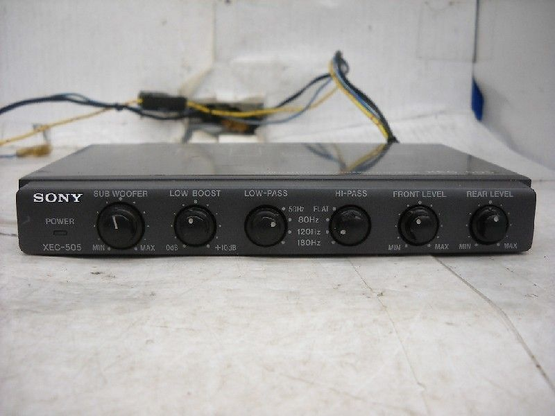

I am in the same boat as I want one of these head units but without a crossover it's a true deal breaker for me.
I thought about using one of the old school Sony 1/2 din crossovers with one of these Andriod units. I used to have one about 20 years ago and it worked out great!
