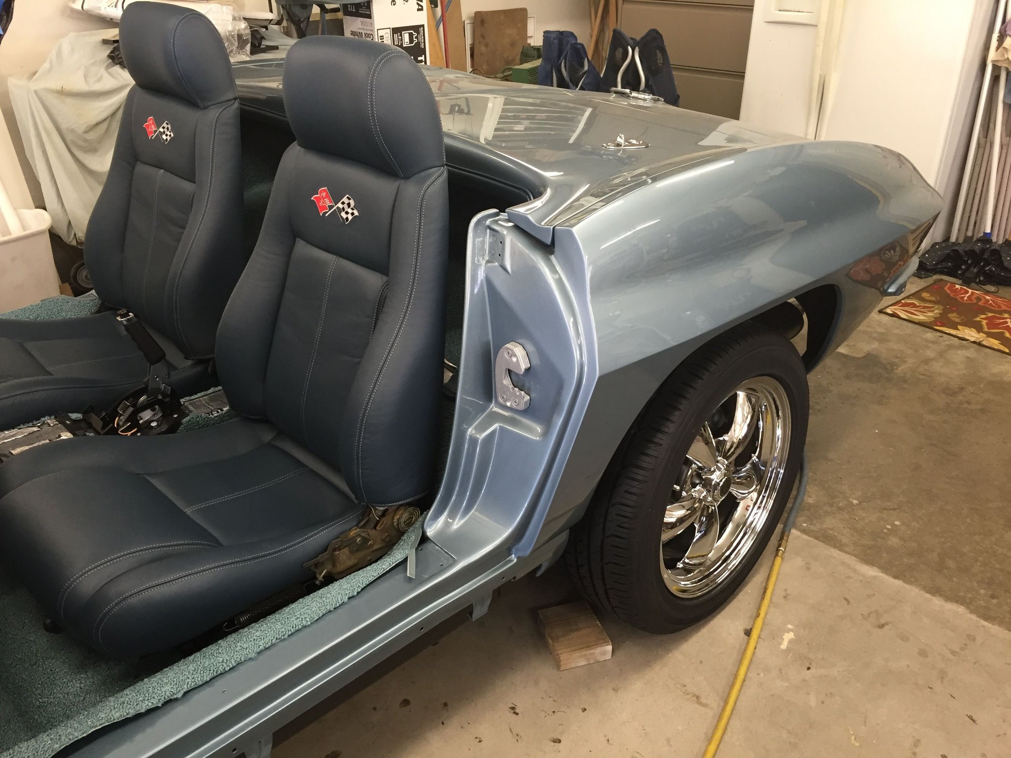

Got the seats and shift boot cover yesterday! Just had to set them in and see what they look like. Will finish up the under dash stuff and install the steering column before bolting them in. Not long now...

The seats look great, what are they originally out of?

Any more details on the seats?
What from?
What sliders?

Sorry I didn't answer the seat question with the last post. The seats are from an '87 Pontiac Fiero, they fit the seat area really well and have much nicer seat and side bolster support. They also recline. Some have speakers in the headrests but I didn't want those. Picked these up out of a parts car for $50 and modified the mount hole locations in my floor to match up with the stock Fiero tracks (could've altered the tracks but it was just as easy to move the bolt plates).
