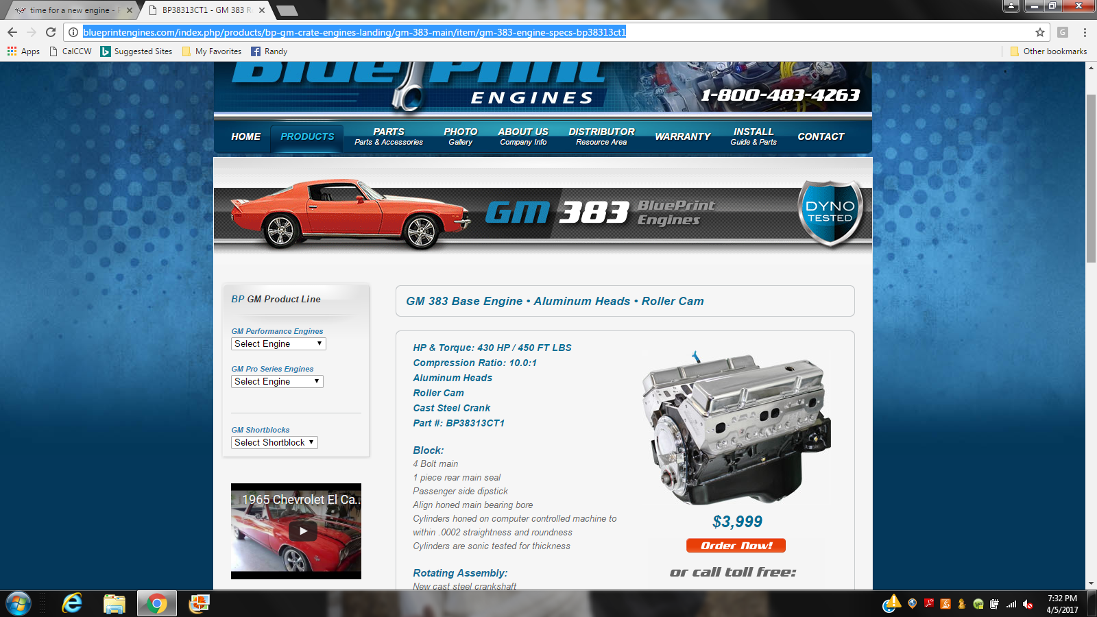

This is the 383 I used. Came with a dyno sheets and warranty. 435 hp, 465 ft lbs of torque was on my sheet, so the add numbers are conservative. Runs very strong and doesn't leak a drop. I used the "Right Stuff" on the manifold ends and corners. They are priced at $3999 now. I got mine from Summit which included shipping about 18 months ago for around $3,890.
Here's the link.
http://blueprintengines.com/index.ph...ecs-bp38313ct1
