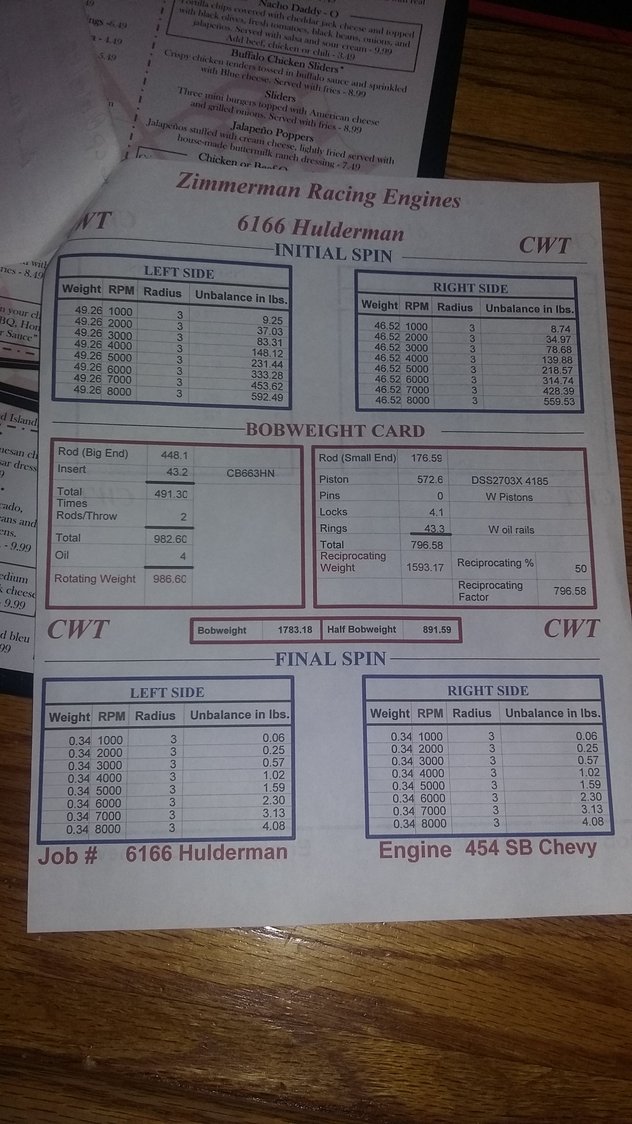

Wow! What a difference a rotating balance makes! This rotating assembly, prior to being balanced, was almost 600 lbs out of balance at 8000 rpm, compared to only 4 lbs after!

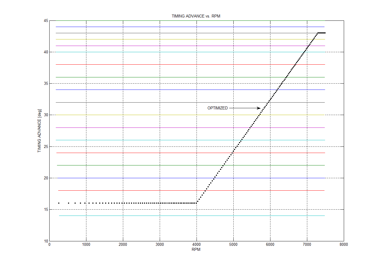

Determined the optimized ignition timing for my engine, using the software I developed.
