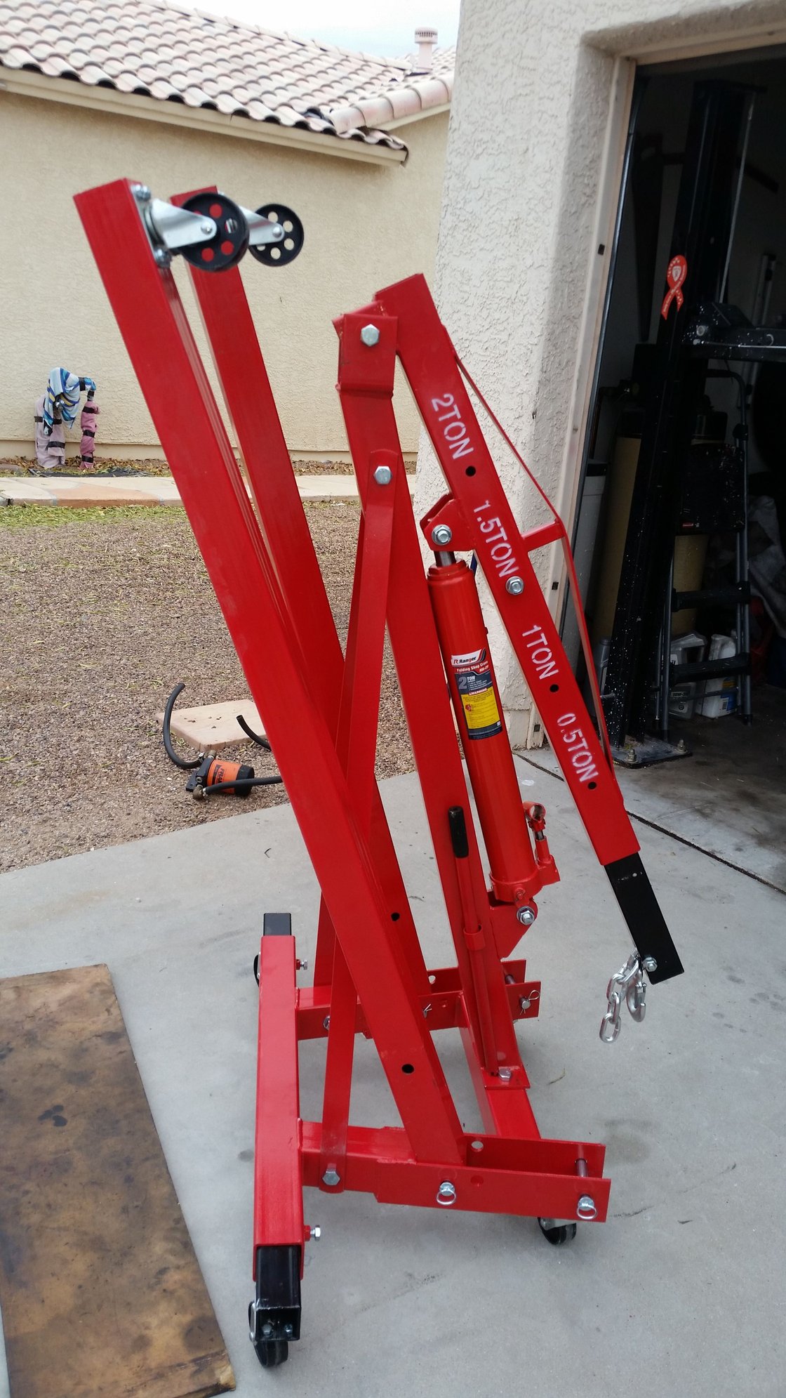

Finally got the rest of my engine hoist late yesterday, and made good progress mounting the engine in the bay today. Hoist had just the right amount of lift and reach to pop it in and got the motor mounts bolted in, and new flywheel and clutch mounted. Still have a whole lot more work to do.
