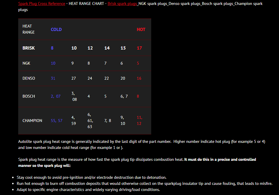

Homed in on the best sparkplug for this engine. I finally went with NGK 7173. I moved up in heat range until the plugs looked good at idle. These have 3/4" reach, recommended by my AFR heads, a heat range of 8, and non-resistor.

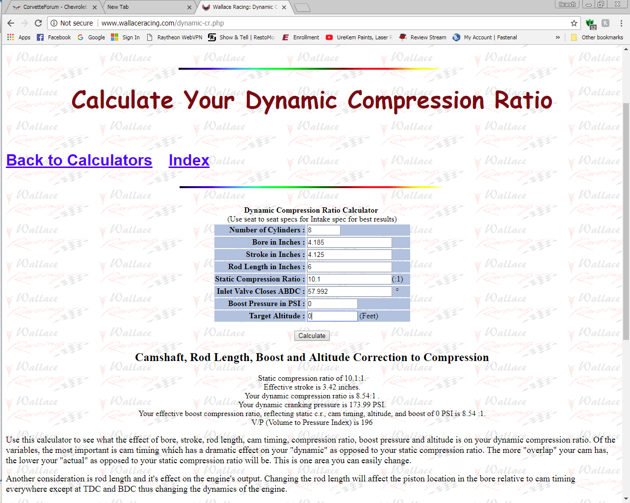

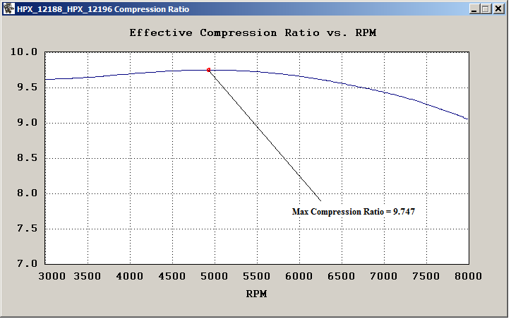

Ok, I think the DCR you refer to is defined differently then how I define it. I calculate it from the cylinder pressures from my software that means a lot more to me. Here I think is how you calculate it. This is using advertised lobe lift for intake valve closing:
I've got a lot more confidence in the software I developed than any other software, since I've validated it throughout the development process. That's what I used to determine the timing requirements, and it's apparently working so far. Another thing you should keep in mind is that I'm well over 100% volumetric efficiency with the heads and lift I have at the peak torque, so DCR is no longer a factor.

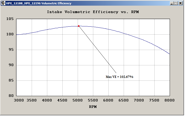

Oh, hears some more info:
Oh, and if you use the .05 intake valve closing number you get the following:

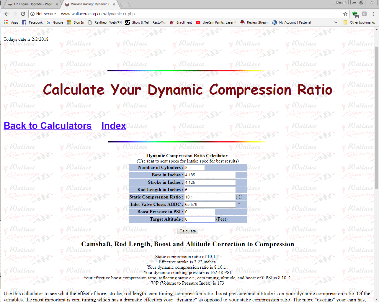

Yes Wallace's program uses the same reasoning as the calculator that I use:
http://cochise.uia.net/pkelley2/DynamicCR.html
scroll near the bottom for the program if you want to look closer. Yes P Kelley uses seat to seat valve timing as well. Using the 0.050 events are useless. Advertised, seat-to-seat, or SAE J604d is what you need. Valve is "effectively" closed when it's about .006 off the seat.
Your software early in this thread shows your DCR @ 8.07:1, while Wallace's (similar to Pat Kelly's, and both of which state an input of seat-to-seat durations) comes up with 8.10:1........virtually identical.
EA Pro shows my VE to be well over 100% with open headers, as well.
The point I was trying to make in my last reply, is that the DCR is pretty arbitrary, what really matters is the effective compression ratio, taking in account dynamic volumetric efficiency. It shows I can get away with pump gas, even as far as I need to advance the timing. There is a reason for why I do things.
