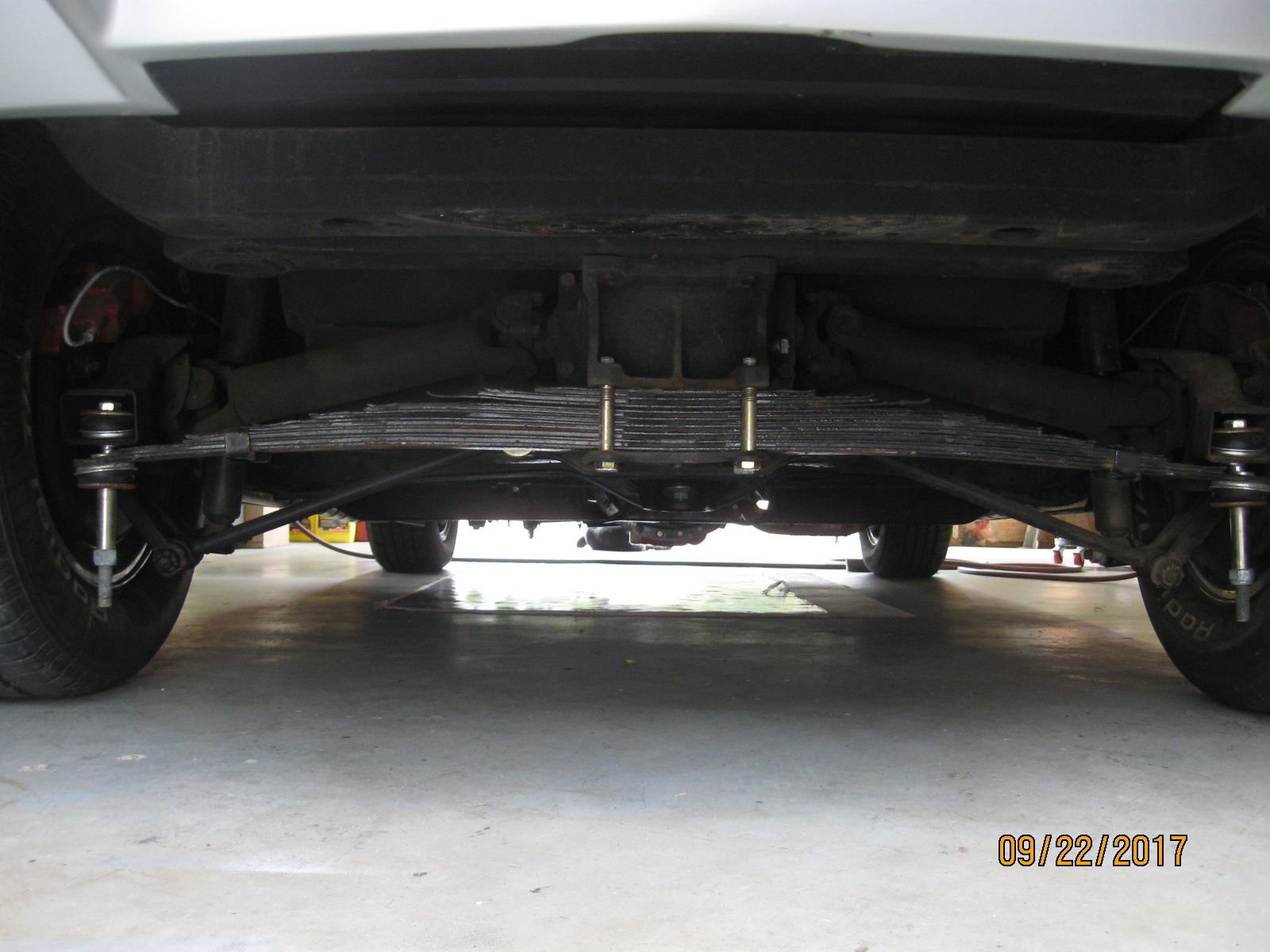

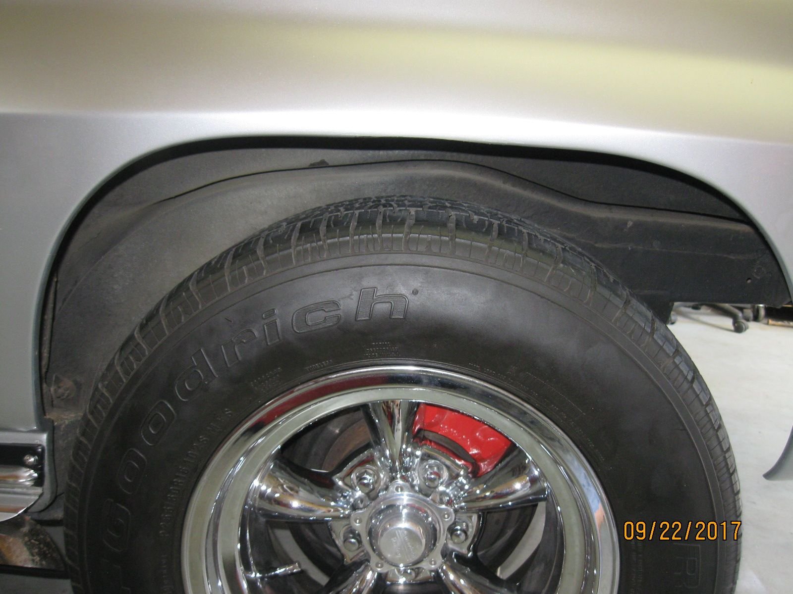

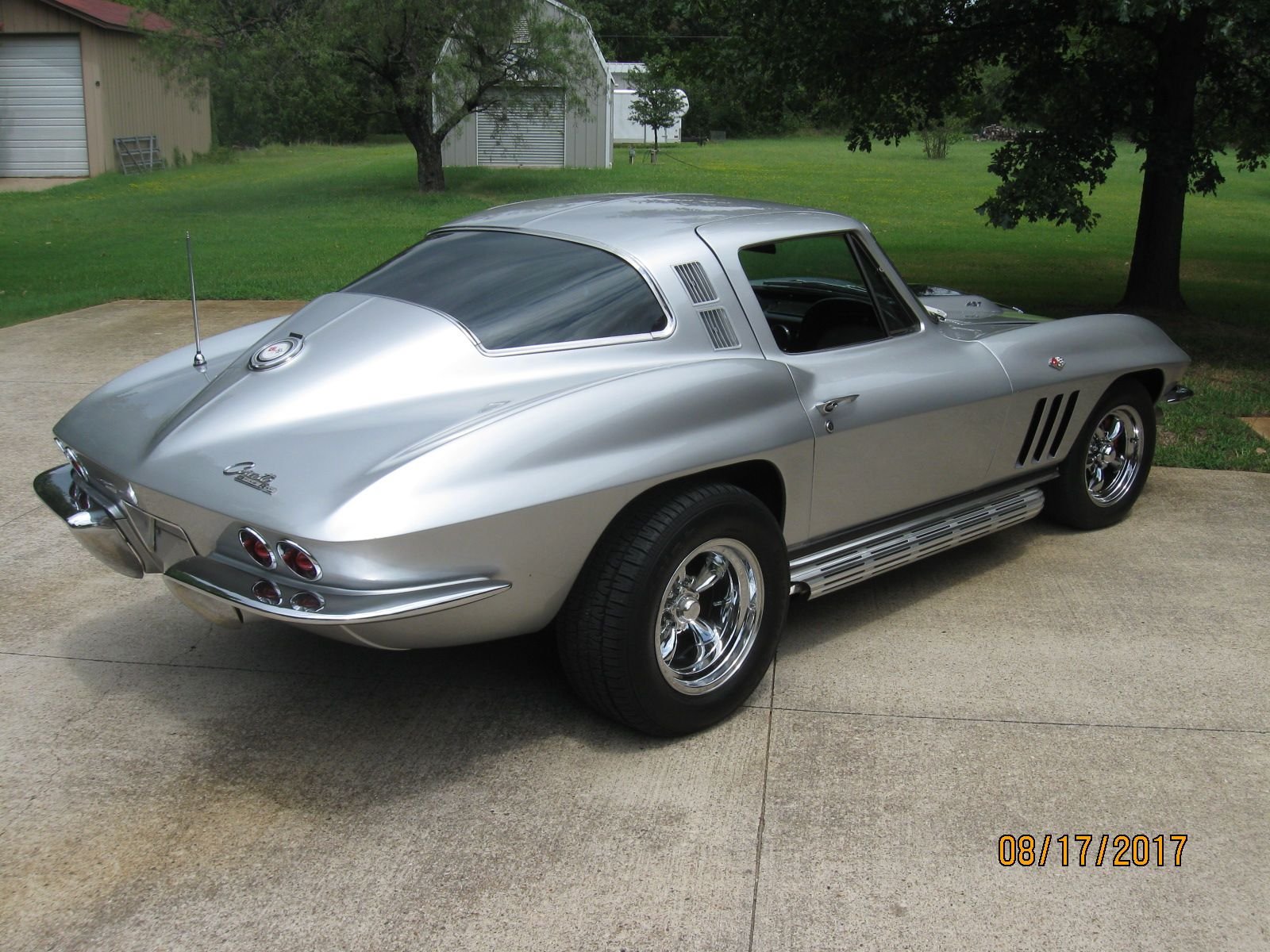

Sorry, I didn’t specify the 65. No, no knock-off’s, here’s a pic. Don’t know if this has anything to do with the vibration, but the suspension has been jacked up for the body to clear the wide wheels.

First thing I would do is get the rear back down to its normal hight, having those tires sticking out of the wheel well scares me, tires are too wide or the back spacing on the wheels is wrong. This could very well be your problem.

Well, I was going to get into the rear suspension later, but this might be as good a time as any. I just didn’t want to confuse the issue because I can’t see how this could be causing a vibration.
Altering the suspension wouldn’t be my first choice but I do kinda like the stance, even though it rides rough. I’m going to go back stock later unless you guys really think this may be contributing to the vibration.

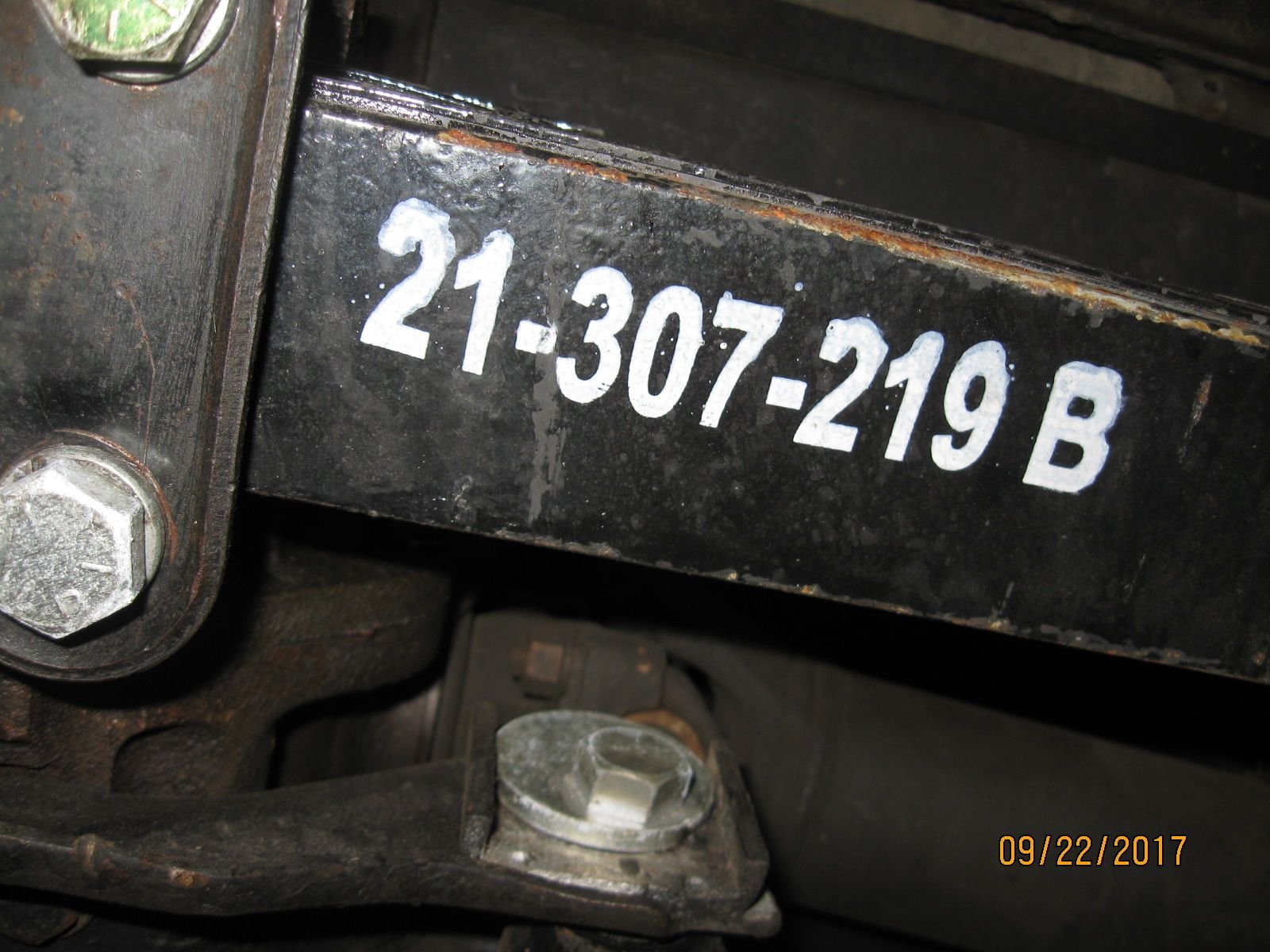

Here’s what I know, the Torq-Thrust wheels are wider and the tire size is 255/60R-15. The traverse rear spring came from John R. Spring Service, part # 21-307-219B.

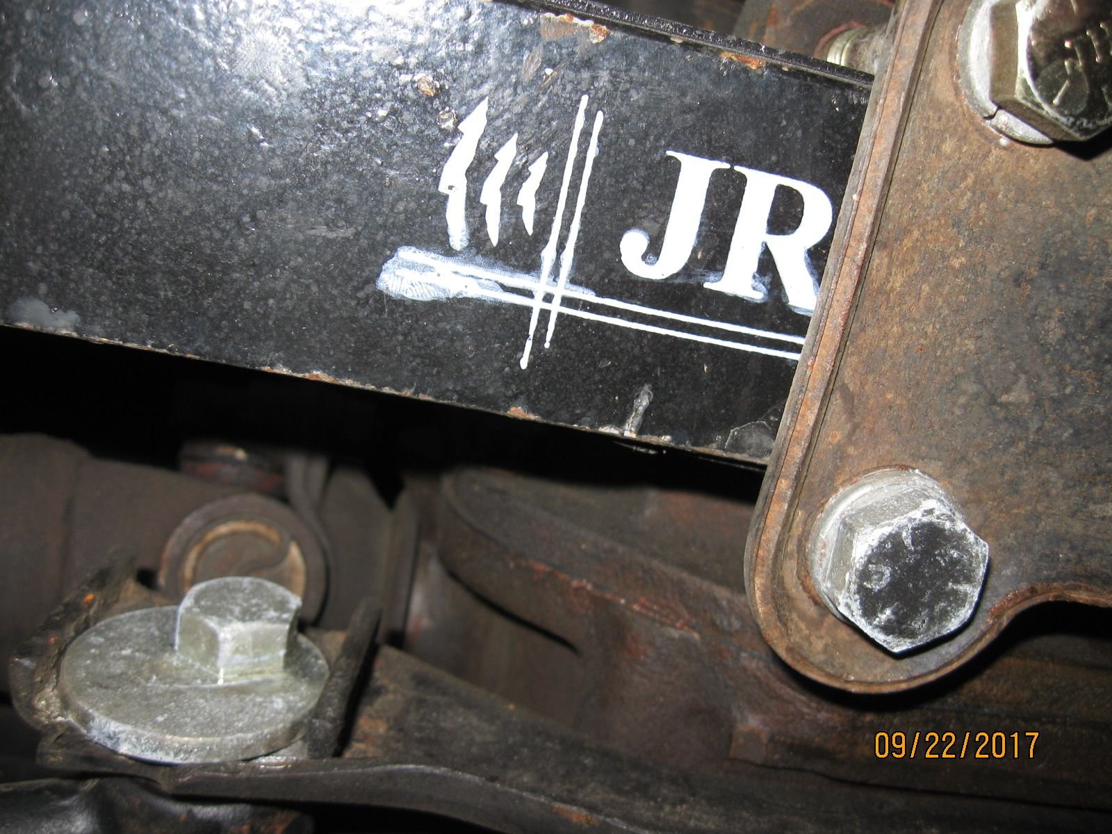

Looked like the bolt is touching tire on inside on the one picture.
Old Oct 11, 2017 | 08:42 AM
jim lockwood's Avatar
jim lockwood
Joined: Feb 2007
Posts: 15,456
Likes: 8,917
From: northern california
C2 of Year Finalist (track prepared) 2019

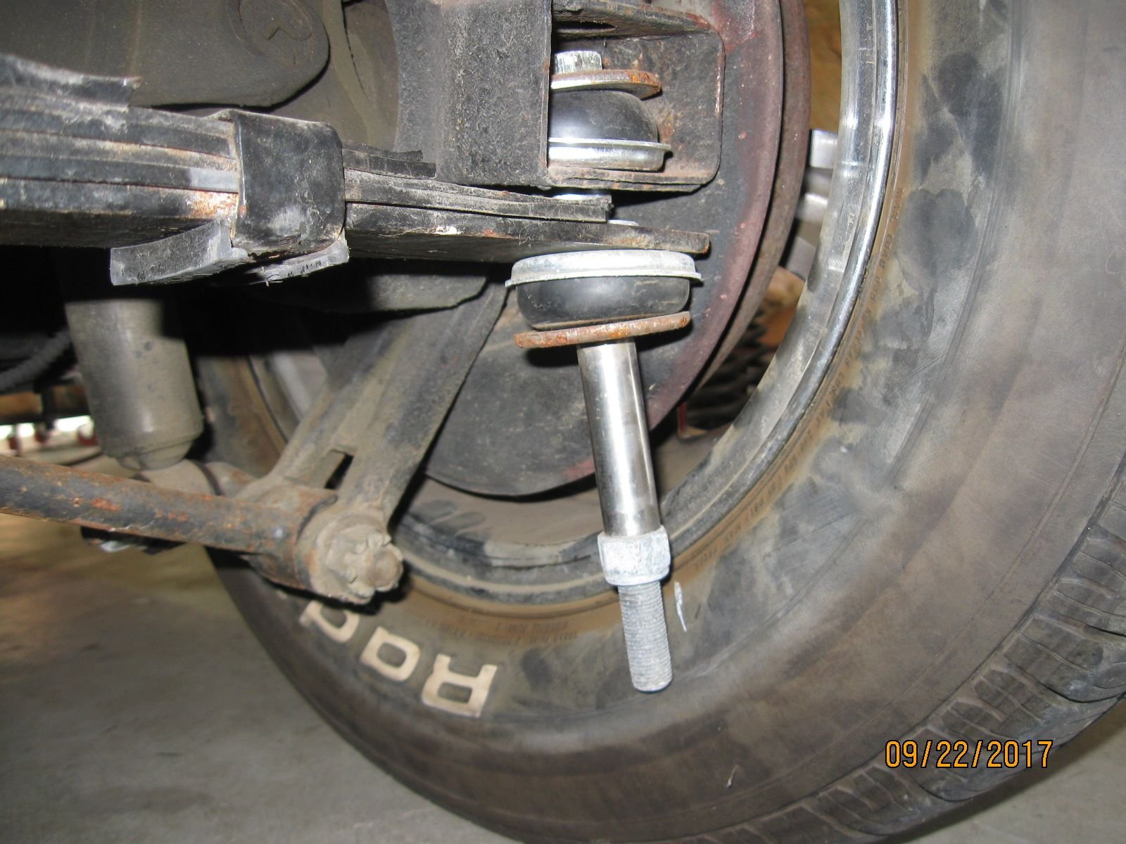

Originally Posted by 59BlueSilver
This is really bad and, IMHO, needs attention now.
The tip of the spring travels in a different arc than the end of the trailing arm. One of the purposes of the long bolt is to allow both to travel freely. With the spring near-solidly bolted to the trailing arm, the suspension will bind up.
This is really bad.
(I may have said that already.)
Jim
To Bad Vibration
Old Oct 11, 2017 | 08:46 AM
65GGvert's Avatar
65GGvert
Joined: Jul 2006
Posts: 22,182
Likes: 4,178
From: Kannapolis NC
Even a slight weight shift or tire bounce is going to allow the trailing arm to hit the top of the spring. It's bolted to the rear axle, so you'll sure feel it, or worse break something. The weight of the rear is supposed to "hang" on the nuts on those long bolts with room for travel.

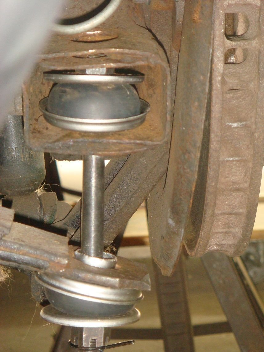

dkleather's Avatar
dkleather
Joined: Jul 2005
Posts: 2,553
Likes: 381
From: Strongsville, OH
2016 C2 of the Year Finalist
This is the setup as it should be although the bottom pad retainer should be preened to the spring. I think your setup is causing your vibration.

Stay well clear of John R. Spring Service in the future.
They are completely brain dead in regards to mid year corvette rear end set up.
